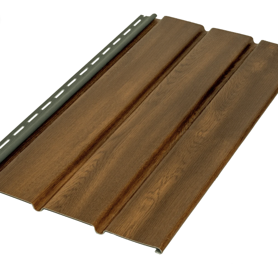

DefinedDesign Posted Monday at 06:39 PM Share Posted Monday at 06:39 PM Attempting to create a more realistic wood grain vented soffit material while still preserving the existing Chief vent perforations and panel grooves. Currently using the stock: “Vinyl Soffit – Center Venting” with “Blend with Texture” enabled. However, the stock Chief texture does not contain much actual wood grain detail, so tinting it brown still reads more like colored vinyl than stained wood. I would like to keep the existing vent perforations and soffit geometry from the Chief texture while also achieving a realistic stained wood grain appearance similar to the attached product image. What is the best workflow for accomplishing this in Chief? Link to comment Share on other sites More sharing options...

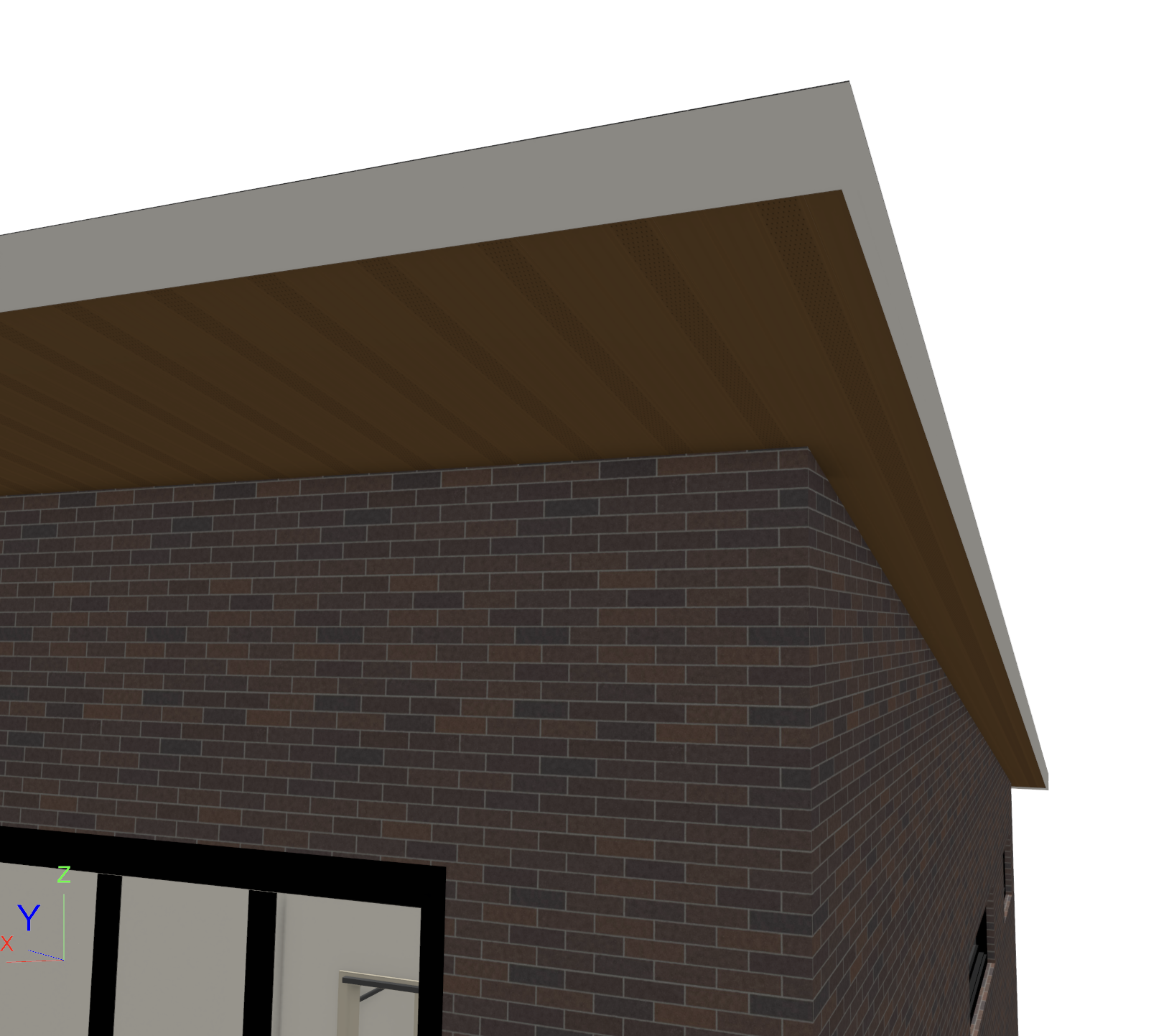

DefinedDesign Posted Monday at 07:43 PM Author Share Posted Monday at 07:43 PM 42 minutes ago, GeneDavis said: Get AI to do it. Thanks @GeneDavis I have experimented with AI image generation quite a bit, but I have not found it reliable enough yet for accurate architectural material rendering. I need the rendering to remain true to the actual architecture, geometry, and specified materials. For example, accurately applying soffit materials, brick, metal roofing, TimberTech decking, trim details, vent patterns, proportions, and lighting conditions without the AI “reinterpreting” the design. Why I pay for Chief. I have found most AI tools still hallucinate or redesign portions of the architecture rather than faithfully represent the actual modeled structure and material assemblies. Was hoping to improve the material workflow directly inside Chief so the renderings remain tied to the real construction model. Link to comment Share on other sites More sharing options...

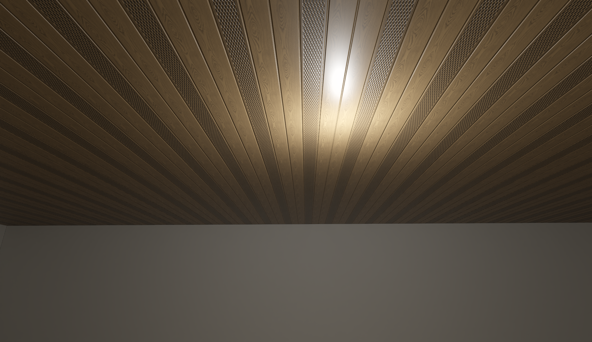

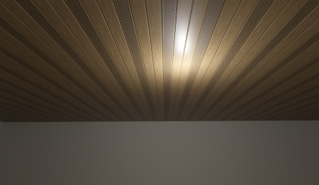

JonathanK Posted 10 hours ago Share Posted 10 hours ago Is this what you're looking for?Wood Vinyl Soffit - Center Vent.calibz I just found a center vent soffit material in CA, found the texture, dropped it in AI and told it to add wood grain and keep all other aspects the same, and changed the mapping of the texture to include the new one AI created. Added the texture to library and attached it here for your pleasure... Not too complicated. Link to comment Share on other sites More sharing options...
JonathanK Posted 10 hours ago Share Posted 10 hours ago (edited) Here's what it looks like with a light source directly on it. Edited 10 hours ago by JonathanK Link to comment Share on other sites More sharing options...
