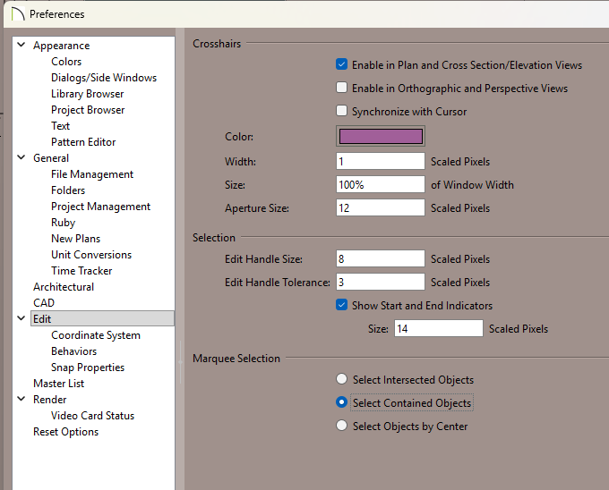

Renerabbitt Posted March 12 Share Posted March 12 (edited) 2 hours ago, Mona_Sh said: Does anyone has a better solution? This is not meant as a slight in any way shape or form but I have not accidentally moved anything in this software in over a decade. I truly think it is difficult to let go of the way another software does something, because when it comes down to it, this software is worlds faster than Revit, so fully embracing its methods are beneficial. That being said, this may help you: Additionally, I would encourage new users to switch to contained selection modes This will help you avoid inadvertently selecting more than what is fully contained within a selection marquee which can help for moving things around. Also learning hot to perform tool restrictive selection using shift+marquee with a tool active to restrictively select that object type/symbol category while avoiding others If you can give an example of when you wanted to lock an element, we might have a nice helpful solution for avoiding that condition, such as resizing walls by locking a side to resize about: Edited March 12 by Renerabbitt Link to comment Share on other sites More sharing options...
