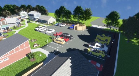

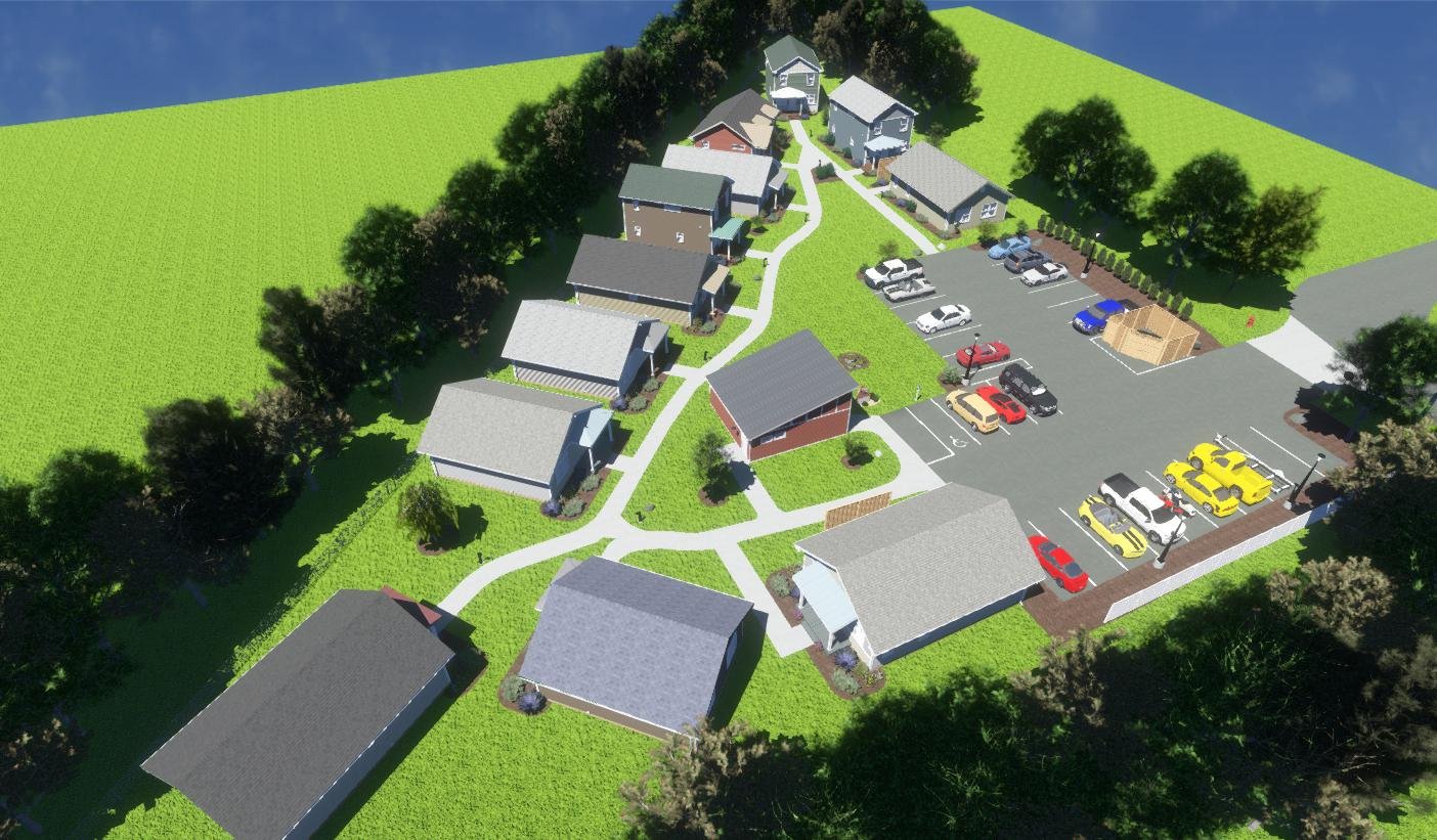

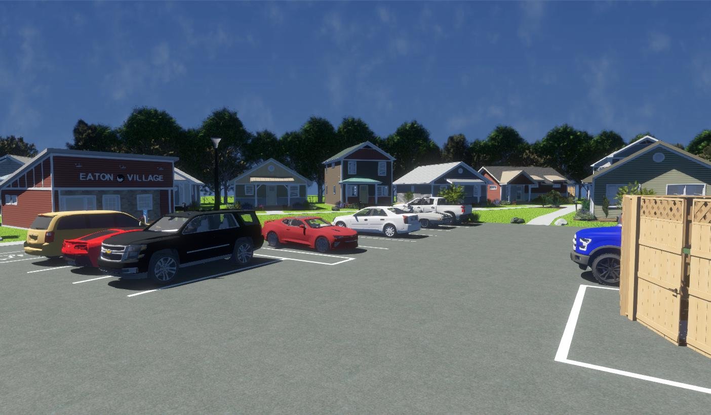

mtldesigns Posted February 26 Share Posted February 26 (edited) 6 hours ago, Randino said: HOW? https://www.chiefarchitect.com/support/article/KB-00344/modeling-a-subdivision-or-lot-with-multiple-structures.html This is what I used to make this subdivision... Edited February 26 by mtldesigns Link to comment Share on other sites More sharing options...
