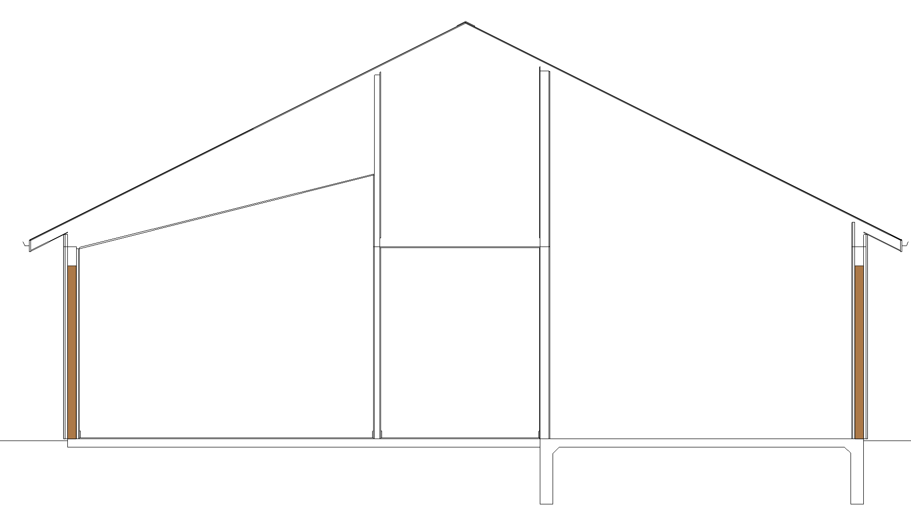

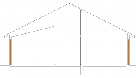

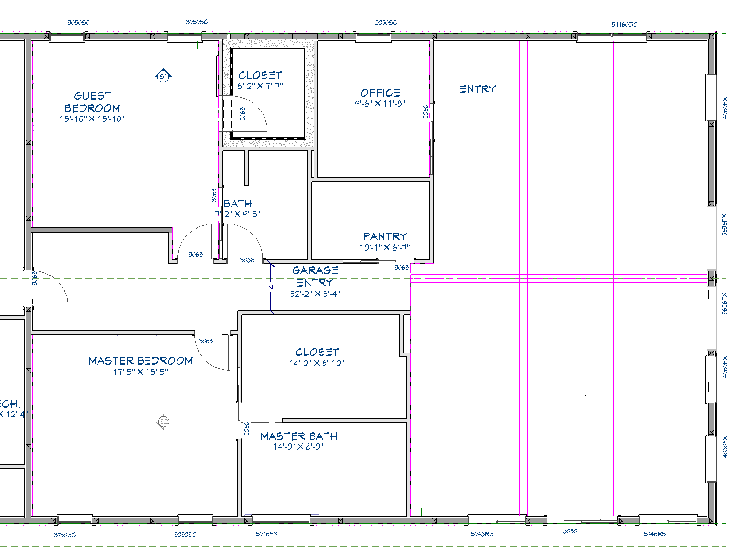

K-Lynn Posted February 11 Share Posted February 11 (edited) Any ideas on why my ceiling planes are only showing in some rooms? The Guest Bedroom & Office are supposed to have a single slope like the master bedroom. Flat ceiling is not selected. I've redrawn them both and they only show in plan but not in 3D or sections. Thanks Doehling-chieftalk.plan Edited February 18 by K-Lynn new plan file and screenshots Link to comment Share on other sites More sharing options...

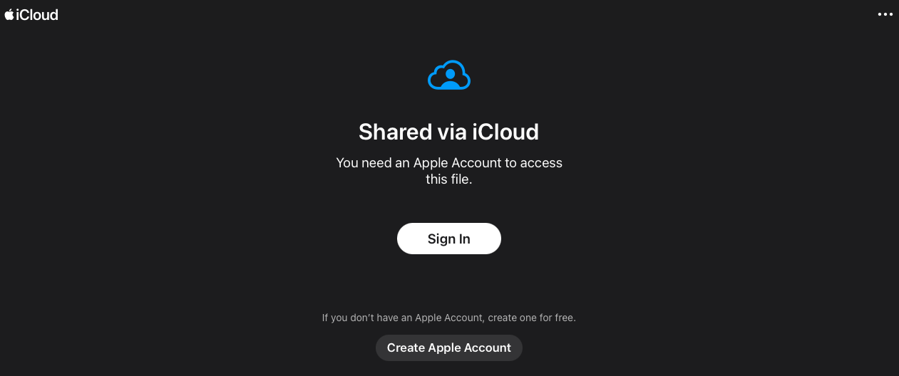

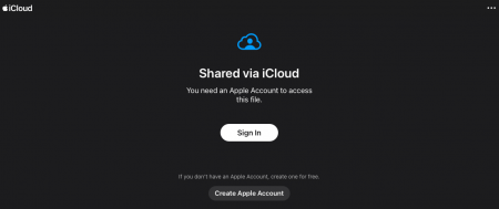

para-CAD Posted February 18 Share Posted February 18 windows users might not want to create an apple account just to view your plan. Link to comment Share on other sites More sharing options...

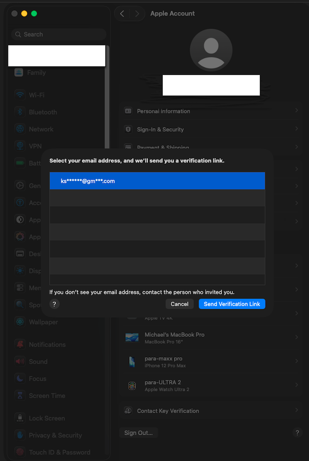

para-CAD Posted February 18 Share Posted February 18 I have an apple account and ran into this Link to comment Share on other sites More sharing options...
K-Lynn Posted February 18 Author Share Posted February 18 Oh my, I didn't do that correctly. I removed more from my plan file and got it small enough to share above. Link to comment Share on other sites More sharing options...

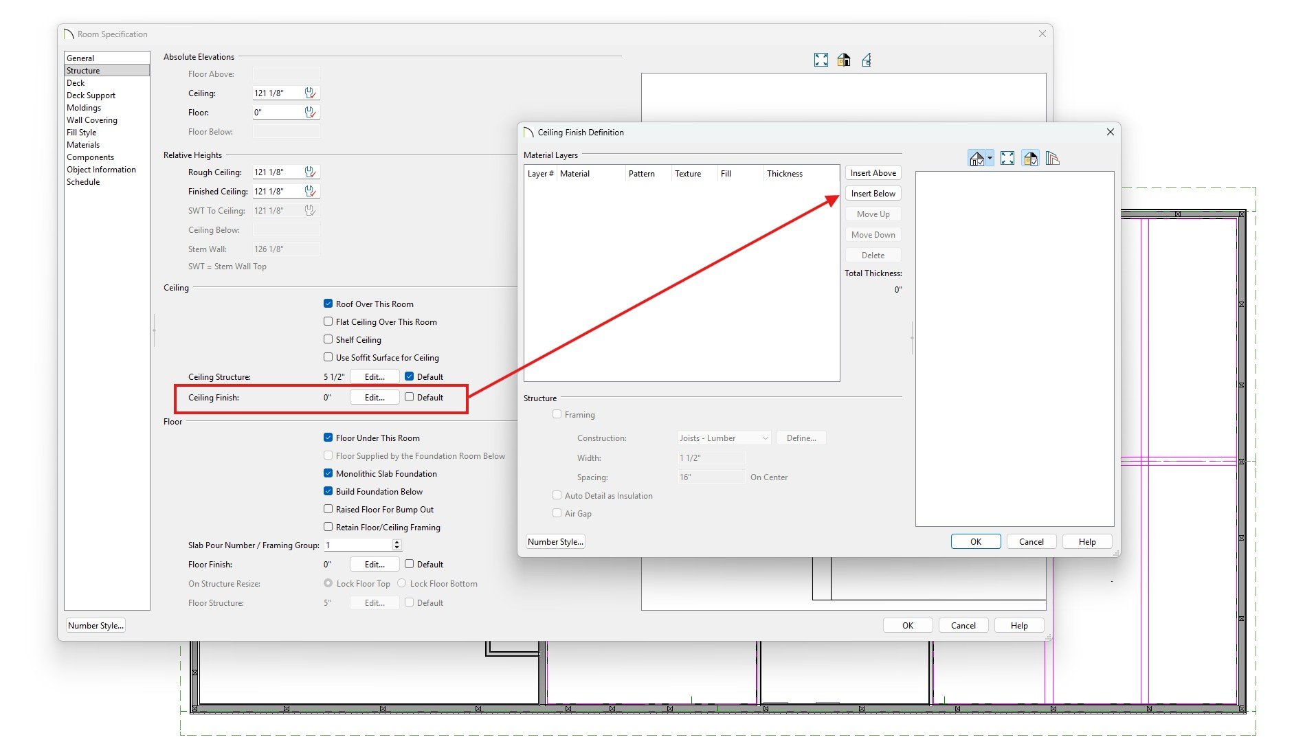

QualicoreHomes Posted February 19 Share Posted February 19 I added a ceiling finish in the Room Specifications in those rooms and that seemed to have added the ceiling. Link to comment Share on other sites More sharing options...
