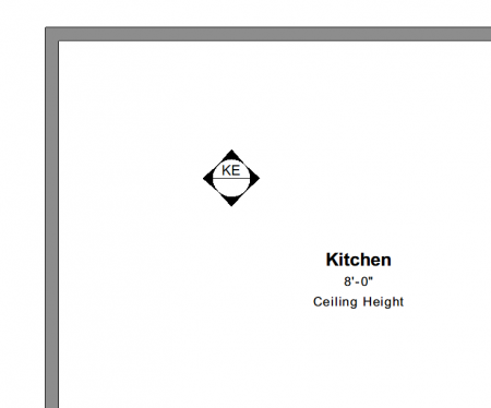

Renerabbitt Posted February 10 Share Posted February 10 (edited) Rename them from the project browser. Also, let me suggest a change... Switch to a callout "rose" which is a callout with 4 "arrows" and no number used. Then label your elevations left right rear front. So your elevations show up as laundry right, laundry left, and you have a single callout indicating that there are 4 laundry room elevations on page A-5 such that your callout shows LE/A5. You'll never have to worry about numbering them again Edited February 10 by Renerabbitt Link to comment Share on other sites More sharing options...

ChiefUserKatie Posted February 12 Author Share Posted February 12 On 2/10/2026 at 5:30 AM, Renerabbitt said: Rename them from the project browser. Also, let me suggest a change... Switch to a callout "rose" which is a callout with 4 "arrows" and no number used. Then label your elevations left right rear front. So your elevations show up as laundry right, laundry left, and you have a single callout indicating that there are 4 laundry room elevations on page A-5 such that your callout shows LE/A5. You'll never have to worry about numbering them again Agreed; I think project browser is the best way to go for now. I like the rose idea. Do you paste a CAD block rose and hide the single elevation callouts that chief generates? Or is there a way that they are linked somehow Link to comment Share on other sites More sharing options...
Renerabbitt Posted February 13 Share Posted February 13 12 hours ago, ChiefUserKatie said: Agreed; I think project browser is the best way to go for now. I like the rose idea. Do you paste a CAD block rose and hide the single elevation callouts that chief generates? Or is there a way that they are linked somehow The callout tool can produce a callout that can link to an elevation camera and post its reference information such as the sheet it was sent to Link to comment Share on other sites More sharing options...
ChiefUserKatie Posted February 13 Author Share Posted February 13 4 hours ago, Renerabbitt said: The callout tool can produce a callout that can link to an elevation camera and post its reference information such as the sheet it was sent to Gotcha. Is that the same for the callout rose with 4 arrows? I know the singular elevation callout can link to the camera, but am curious if there's a way in Chief to do the 4-arrow callout rose you were mentioning & have it linked as well. Or is the 4 arrow callout rose a CAD block that you manually edit & then have additional single elevation callouts that are providing that link to your plan file? Link to comment Share on other sites More sharing options...
Renerabbitt Posted February 13 Share Posted February 13 1 minute ago, ChiefUserKatie said: Gotcha. Is that the same for the callout rose with 4 arrows? I know the singular elevation callout can link to the camera, but am curious if there's a way in Chief to do the 4-arrow callout rose you were mentioning & have it linked as well. Or is the 4 arrow callout rose a CAD block that you manually edit & then have additional single elevation callouts that are providing that link to your plan file? the callout tool is the same whether you add 1 arrow or 4 arrows to it, give it a shot Link to comment Share on other sites More sharing options...
