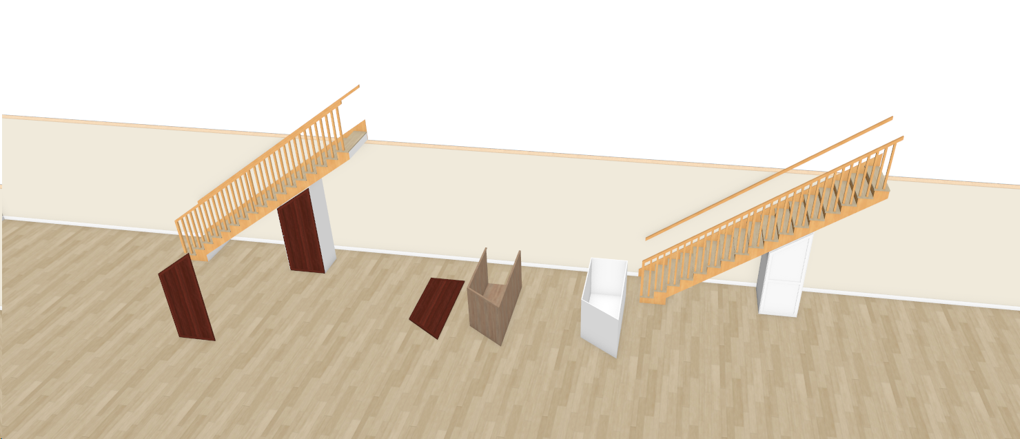

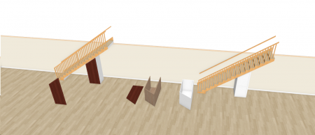

MarkMc Posted January 20 Share Posted January 20 (edited) Here's a plan with some ideas on how to do that. Plan is old, originally in X13, and don't remember for sure how I made the door. Might be with the wall cabinet on the floor. Nowadays I'd make the door from a countertop with molding added, convert to cab door symbol and rotate. Taking a detail from view of elevation of stairs is the easy way to get the angle to use. Under stair cabinet.zip Edited January 20 by MarkMc Link to comment Share on other sites More sharing options...

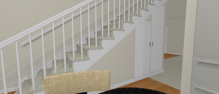

DBCooper Posted January 20 Share Posted January 20 Angled top cabinets are not very easy since Chief is not designed to build them. For your situation, you could try just using a normal door. In the picture below, I made it "triangle arch" top and made it "right arch" instead of angled on both sides. I then removed the casing and jamb. 1 Link to comment Share on other sites More sharing options...
