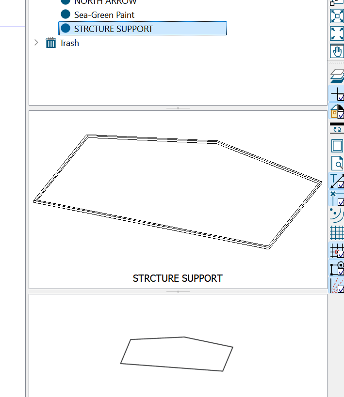

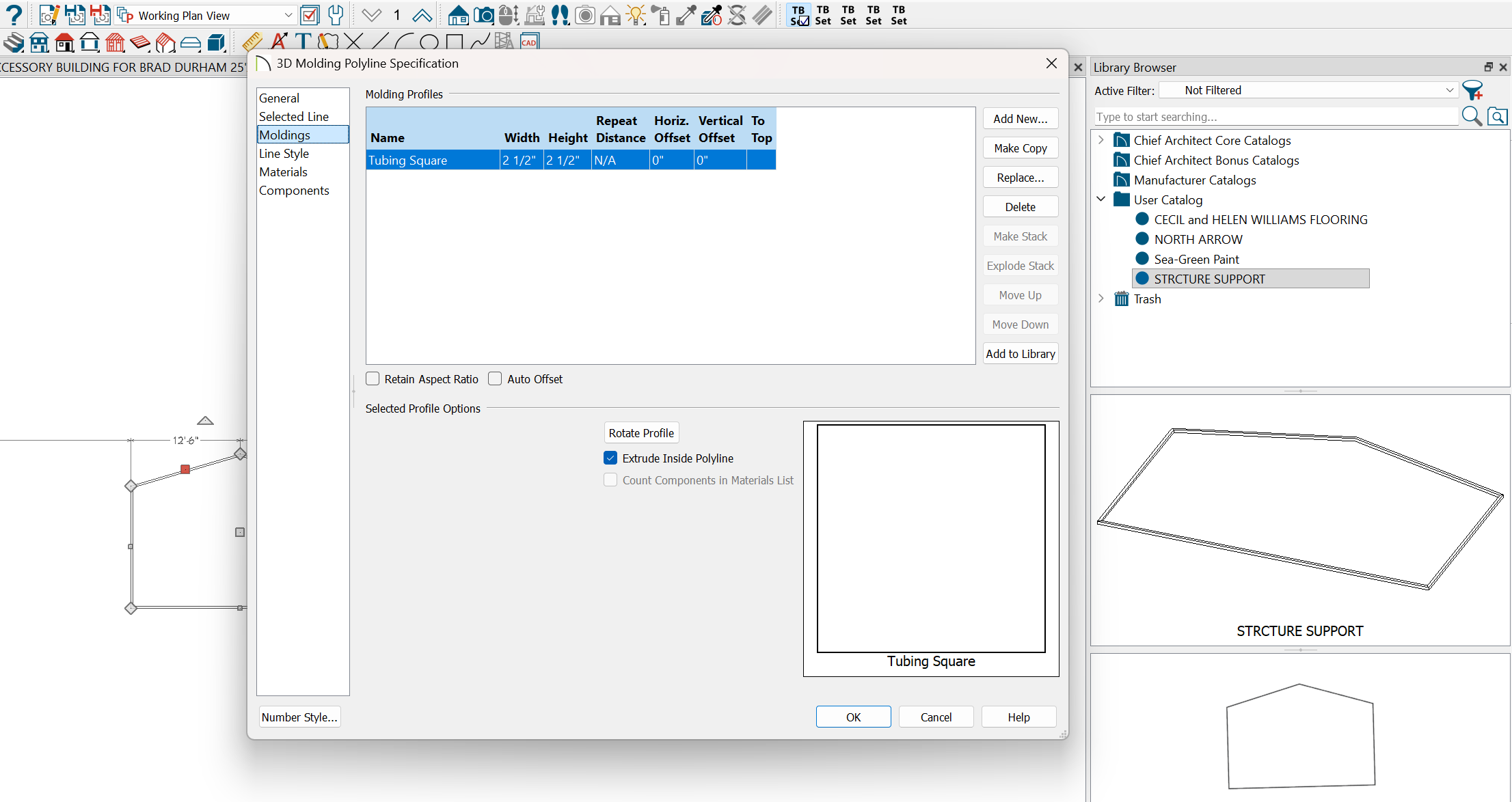

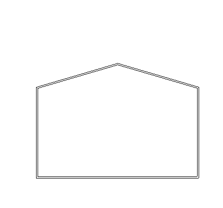

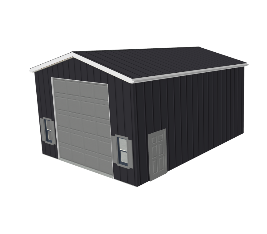

Evolution Posted December 4, 2025 Share Posted December 4, 2025 i need to model metal building (structure system) the kind you by and they deliver and set up. There is reason behind this madness. I have made the structural support from a 3D molding poly line and have it shaped and sized as needed and added to my library as "hardware" for lack of (a better option) now. Problem is I can stick as many as I want on the plan in elevation, but I haven't figured out how to rotate it to place it in floor plan view. Since we have to draw walls using the build exterior wall tool I attempted modeling a new wall type but the item needs editing and that option doesn't appear to be available in X12. what other options would you propose? The frame if 14ga square tube 2.5"X2.5". I wasn't planning on going so far as to model connectors, splices or any such, if I can just get the symbol so I can place it in plan view if I am not able to edited the wall type to include it in the materials. ACCESSORY BUILDING FOR BRAD DURHAM 25'X30'.plan Link to comment Share on other sites More sharing options...

Solution mtldesigns Posted December 5, 2025 Solution Share Posted December 5, 2025 6 hours ago, Evolution said: but I haven't figured out how to rotate it to place it in floor plan view I made it a symbol, then once its in your user library you can rotate it. See the attached. make a symbol open symbol and rotate on the X axis don't forget to make it a 2D block Recording 2025-12-04 205110.mp4 Link to comment Share on other sites More sharing options...

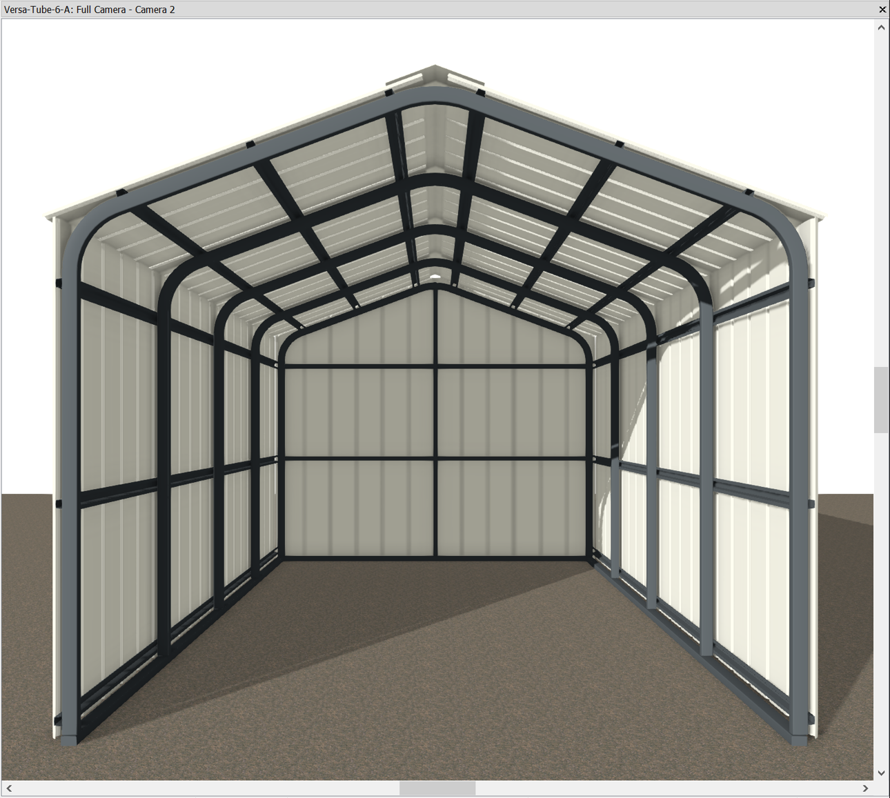

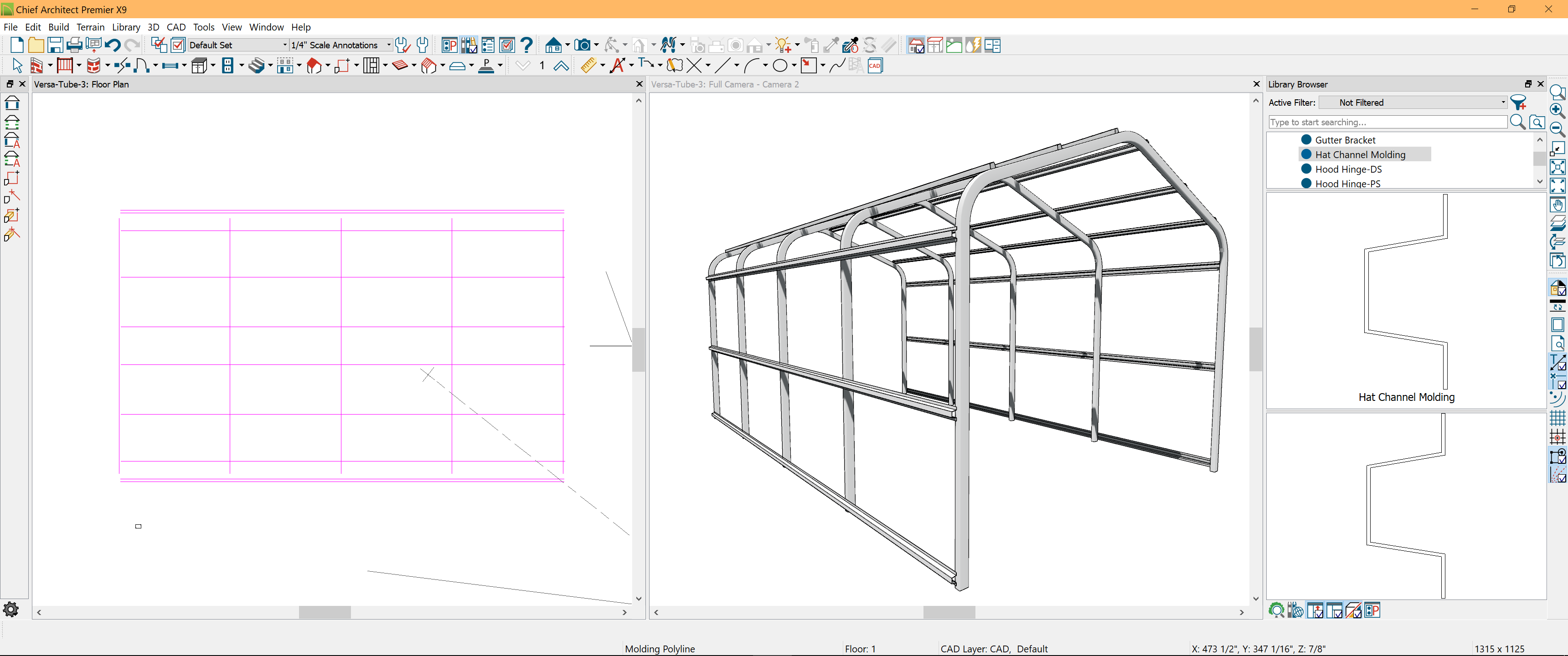

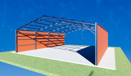

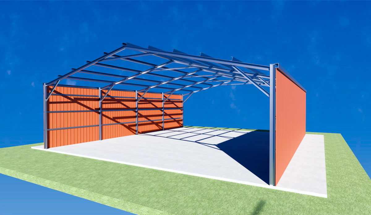

Rich_Winsor Posted December 5, 2025 Share Posted December 5, 2025 About 5 years ago I took a shot at modeling a VersaTube metal building kit we assembled here on the property. It was modeled completely using Molding Polylines. It was a major PITA. I even used Molding Polylines to create the steel siding as well. Currently I've been modeling a 40' x 50' metal shop kit we are preparing to assemble. Having learned my lesson with the Molding Polylines this time I modeled the building frame completely from 3D solids. I just modeled cross sections of the steel members and converted them to 3D Solids. Instead of extruding the beams just set the length you need in the 3D Solid Specification DBX. I made a 1 layer Wall Type 1/2" thick using Red Ribbed Metal for the material. Cladding the steel frame with this wall type encloses the structure and creates a Room so Doors, Windows, Roofs etc. can be modeled normally. Good Luck. Link to comment Share on other sites More sharing options...
