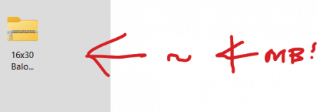

SC_drafting Posted November 14 Share Posted November 14 I'm using x17 and can't for the life of me figure out how to export a zipped file small enough to share in chieftalk. I know there was a tool in older versions where you could export a zipped file directly from a program, but looks like its no longer around. I'd really appreciate a detailed walkthrough or a video to explain it. Now for an even dumber question- how do you imbed pictures in a post? Yes, I'm an idiot. Thanks for the help! Link to comment Share on other sites More sharing options...

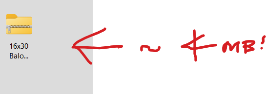

SC_drafting Posted November 15 Author Share Posted November 15 Okay, I got that far, but it's still too big to attach. What next? Link to comment Share on other sites More sharing options...

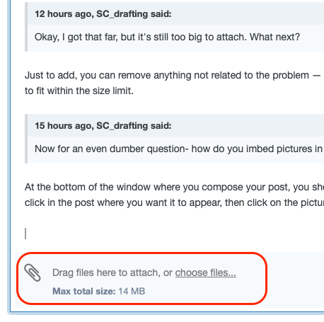

Chrisb222 Posted November 15 Share Posted November 15 12 hours ago, SC_drafting said: Okay, I got that far, but it's still too big to attach. What next? Just to add, you can remove anything not related to the problem — including windows, doors, and literally anything that doesn't alter the issue you need help with. Any file can be reduced to fit within the size limit. 15 hours ago, SC_drafting said: Now for an even dumber question- how do you imbed pictures in a post? Yes, I'm an idiot. Thanks for the help! At the bottom of the window where you compose your post, you should see a paperclip icon with "Drag files here to attach, or choose files..." So find the file and drag it into the window, or click Choose Files and navigate to it that way. Then, once you have attached the picture file, click in the post where you want it to appear, then click on the picture to add it. See below: Link to comment Share on other sites More sharing options...

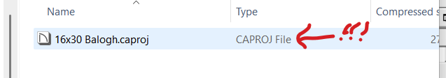

JKEdmo Posted November 19 Share Posted November 19 17 minutes ago, SC_drafting said: Renerabbitt- I did what you suggested, and it looks like it's working. Would appreciate if someone else would try opening the plan through the wetransfer link and let me know if it's working for them. https://we.tl/t-sr1QtKgqRP SC, Download worked for me... However, you uploaded the whole Project (.CAPROJ) file. This is essentially a file that contains all project assets. This explains the very large file size and why you could not upload to the forum using usual methods. (I don't think forum members would want to upload a whole project file either, but a single .PLAN model file is okay). What you want to do is just upload only the .PLAN file (zipped). The .PLAN file is the building model without all the other stuff. Here I zipped your .PLAN file, which comes in under 4 MB. I attached the .zip file for your reference. 16x30 Balogh (2).zip Link to comment Share on other sites More sharing options...
