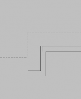

Jonathan3891 Posted November 7, 2025 Share Posted November 7, 2025 I've been struggling to figure out the issue with this wall corner all day and I'm at a loss. I would appreciate any help I can get to understand the issue and get it resolved. The file is too large to upload, but you can download it from my google drive https://drive.google.com/drive/folders/1EzUJr5P36ILRrG8Ka6yCdT_b6qOtGNXL?usp=sharing Link to comment Share on other sites More sharing options...

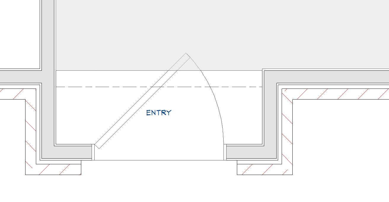

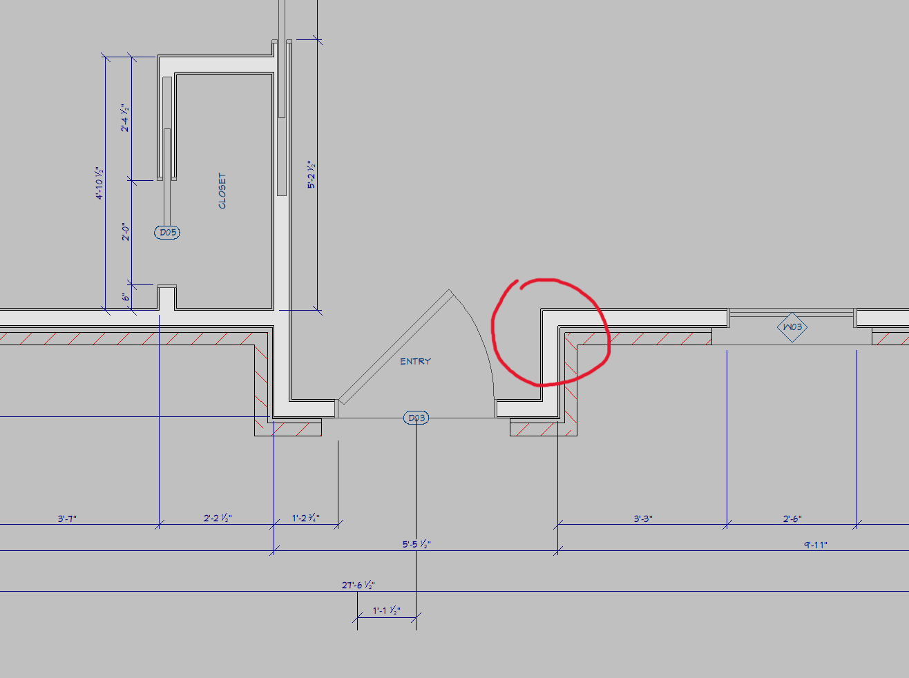

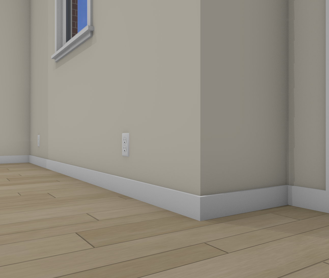

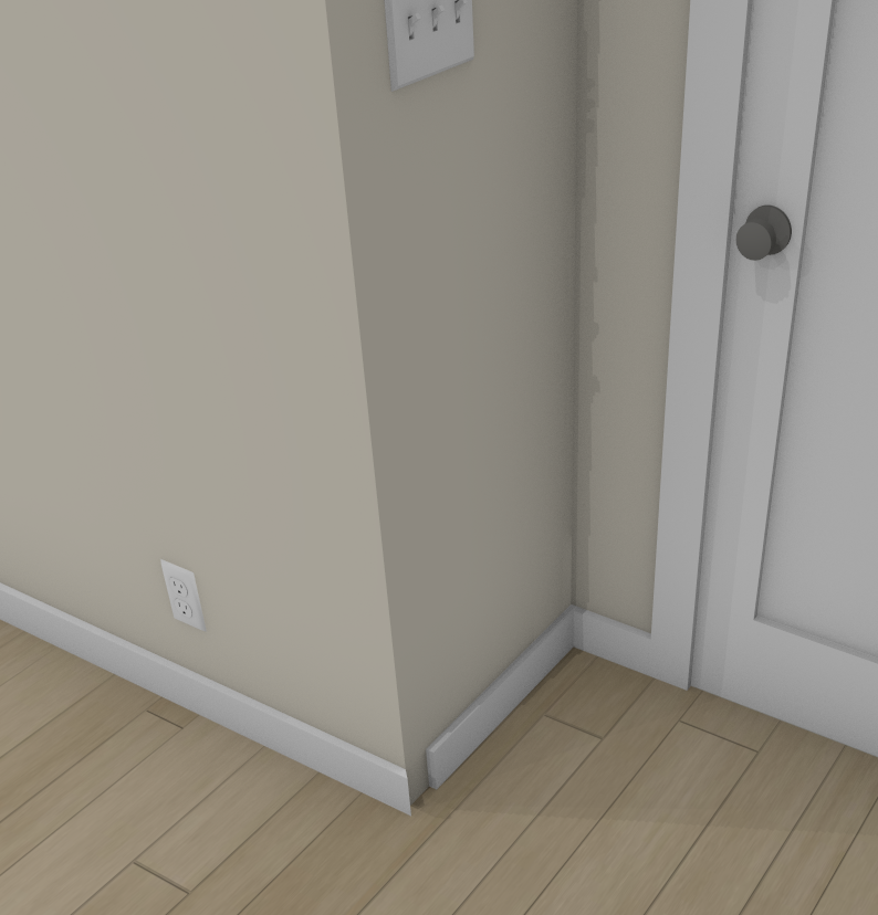

Jonathan3891 Posted November 7, 2025 Author Share Posted November 7, 2025 As you can see in the second and third picture there is an issue with this wall corner. The molding and brick ledge aren't connecting. Link to comment Share on other sites More sharing options...

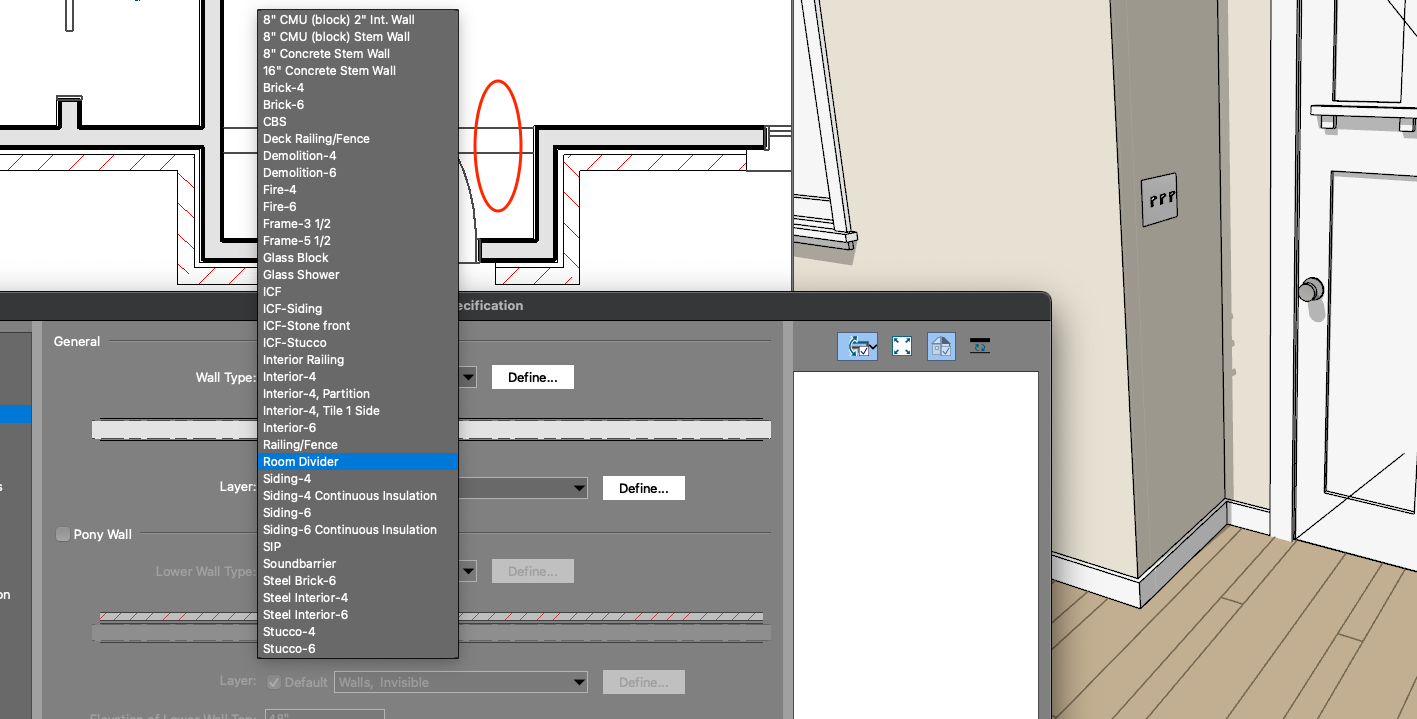

Solution Chrisb222 Posted November 7, 2025 Solution Share Posted November 7, 2025 32 minutes ago, Jonathan3891 said: As you can see in the second and third picture there is an issue with this wall corner. The molding and brick ledge aren't connecting. Yeah I just turned on Walls, Invisible layer, went into the wall dialog that defines the foyer, and chose Room Divider as the wall type: Link to comment Share on other sites More sharing options...
SHCanada2 Posted November 7, 2025 Share Posted November 7, 2025 I redrew the invisible wall Link to comment Share on other sites More sharing options...
Jonathan3891 Posted November 7, 2025 Author Share Posted November 7, 2025 Ah so that was the problem! I didn't realize a room divider would cause such an issue. Thank you for the fast resolution. Link to comment Share on other sites More sharing options...
mtldesigns Posted November 8, 2025 Share Posted November 8, 2025 (edited) 3 hours ago, Jonathan3891 said: a room divider Hey Jonathan, I didn't open up the model, but I am curious on why there is a room divider at this location? Edited November 8, 2025 by mtldesigns Link to comment Share on other sites More sharing options...
SHCanada2 Posted November 8, 2025 Share Posted November 8, 2025 he has a different ceiling height Link to comment Share on other sites More sharing options...
