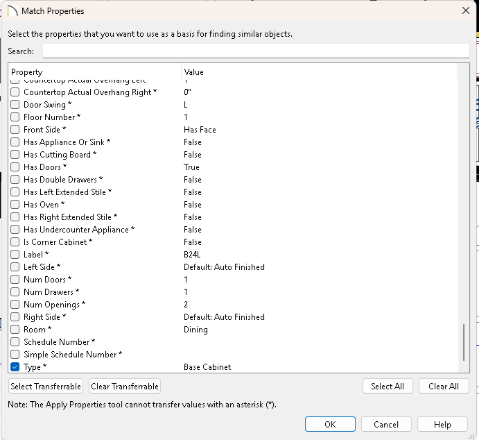

DBCooper Posted October 5, 2025 Share Posted October 5, 2025 (edited) I don't think X17 is any different than X16 with regards to cabinet materials. That said, there are a bunch of ways to change all of your cabinet materials in only a few steps. 1. If all of your cabinets are set to "use default" and your cabinet defaults are set to "use default", you can open up the "materials defaults" and change them there and all of the cabinets in your plan should change. 2. If all of your cabinets are set to "use default" but your cabinet defaults are not, then you can change the materials in your cabinet defaults and all of the cabinets in your plan should change. 3. If your cabinets are not set to "use default", you can use the material spray can in a camera view and the set it to "plan" mode so that all cabinets in the plan will be changed. 4. You can also use the "match properties" tool to select all of the cabinets that have the same materials and then "apply properties" to paint the materials on the cabinets that don't match. 5. You can group select all of the cabinets while in "base cabinet" mode and change all of your base cabinets through the cabinet dialog. Then do the same for your wall cabinets. Can't change the materials if you select both base and wall cabinets for some reason. 6. You can create a cabinet schedule and edit all of the cabinets associated with a schedule row at one time. If you create a schedule with just the description column and number, then you can edit all of the cabinets for each type at one time. Probably some others I missed. Edited October 6, 2025 by DBCooper 1 Link to comment Share on other sites More sharing options...
SHCanada2 Posted October 5, 2025 Share Posted October 5, 2025 (edited) use a style pallet in room/object/plan mode from plan or camera view Edited October 5, 2025 by SHCanada2 Link to comment Share on other sites More sharing options...

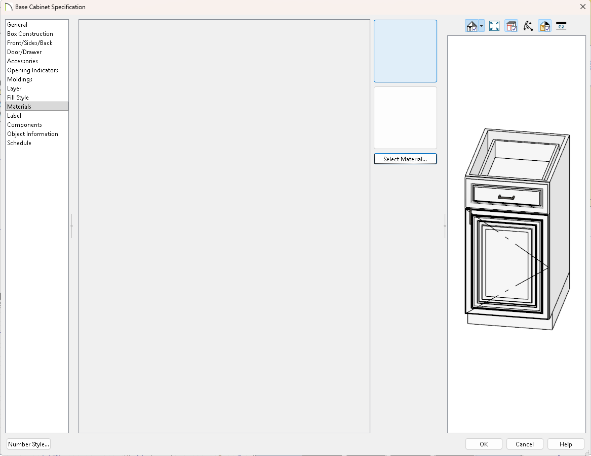

John_B Posted October 5, 2025 Author Share Posted October 5, 2025 Quote 5. You can group select all of the cabinets while in "base cabinet" mode and change all of your base cabinets through the cabinet dialog. Then do the same for your wall cabinets. Can't change the materials is you select both base and wall cabinets for some reason. Hmmm, thank you for your list of options, however I tried this one and no dice...am I missing something? It selected ONLY 44 base cabinets and nothing else.... Link to comment Share on other sites More sharing options...
DBCooper Posted October 6, 2025 Share Posted October 6, 2025 I think that if any of your base cabinets has an appliance or sink that you won't be able to change any of the materials in the cabinet dialog (for some reason only known to Chief). If it's not that, then I don't know. Instead of using match properties to select your base cabinets and then open the dialog, you could use it to apply the materials to the others instead (see #4). Link to comment Share on other sites More sharing options...
John_B Posted October 6, 2025 Author Share Posted October 6, 2025 22 hours ago, DBCooper said: I think that if any of your base cabinets has an appliance or sink that you won't be able to change any of the materials in the cabinet dialog (for some reason only known to Chief). If it's not that, then I don't know. Instead of using match properties to select your base cabinets and then open the dialog, you could use it to apply the materials to the others instead (see #4). Ok, I'll give it a try, thanks Link to comment Share on other sites More sharing options...
