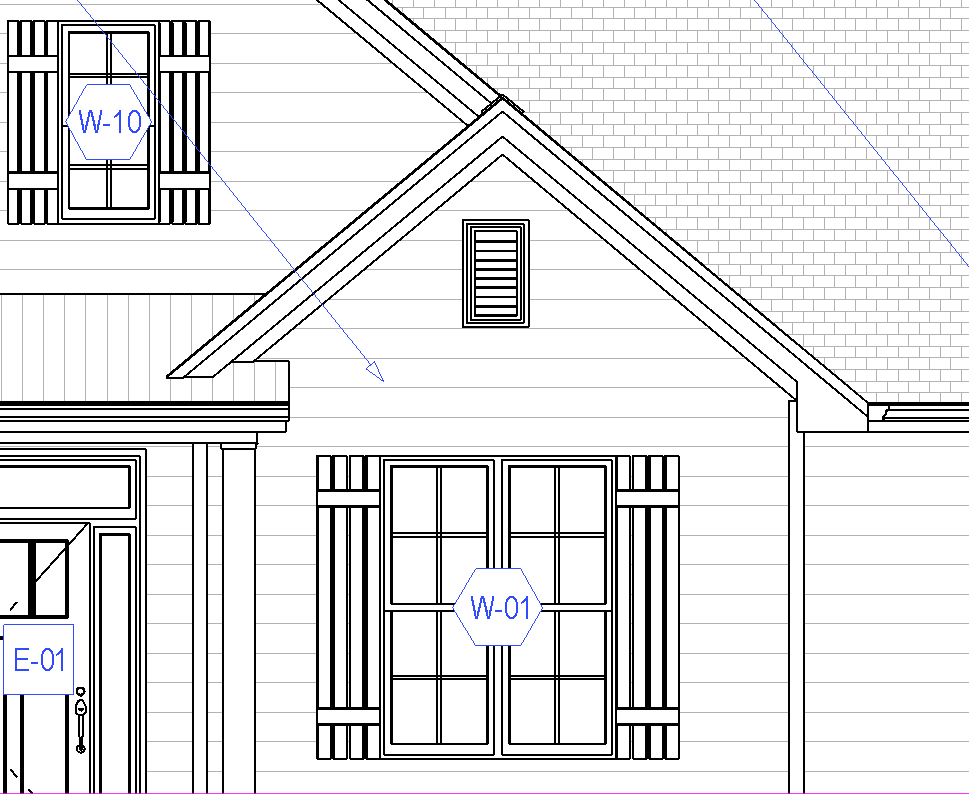

Skip_D Posted October 3, 2025 Share Posted October 3, 2025 Hi, Is there a way to supress the outer layer of a wall, or roof, in elevations? My 2d elevations look too busy with cedar siding and roof shingles; I'd rather it not show, or if it does, with a much lighter line weight or light gray. thanks, George Link to comment Share on other sites More sharing options...

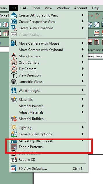

tundra_dweller Posted October 3, 2025 Share Posted October 3, 2025 You can also toggle all the material patterns on or off in 3D views. 2 Link to comment Share on other sites More sharing options...

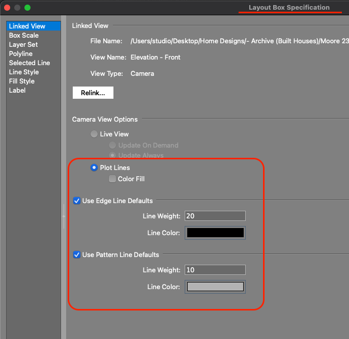

Chrisb222 Posted October 3, 2025 Share Posted October 3, 2025 1 hour ago, Skip_D said: Hi, Is there a way to supress the outer layer of a wall, or roof, in elevations? My 2d elevations look too busy with cedar siding and roof shingles; I'd rather it not show, or if it does, with a much lighter line weight or light gray. thanks, George If you're talking about how your elevations look in layout, personally I prefer using plot lines and setting the edge lines to black, and the pattern lines to a thinner gray. 1 Link to comment Share on other sites More sharing options...
GeneDavis Posted October 3, 2025 Share Posted October 3, 2025 I prefer elevations sent to layout as plot lines and then when in layout, the pattern lines set to 1 and color gray not black. Link to comment Share on other sites More sharing options...
tundra_dweller Posted October 3, 2025 Share Posted October 3, 2025 Yep I like to use the same method as Chris & Gene. Sometimes for basic prelim versions I will toggle off all the patterns in elevation views when we aren't sure of materials yet. 1 Link to comment Share on other sites More sharing options...
