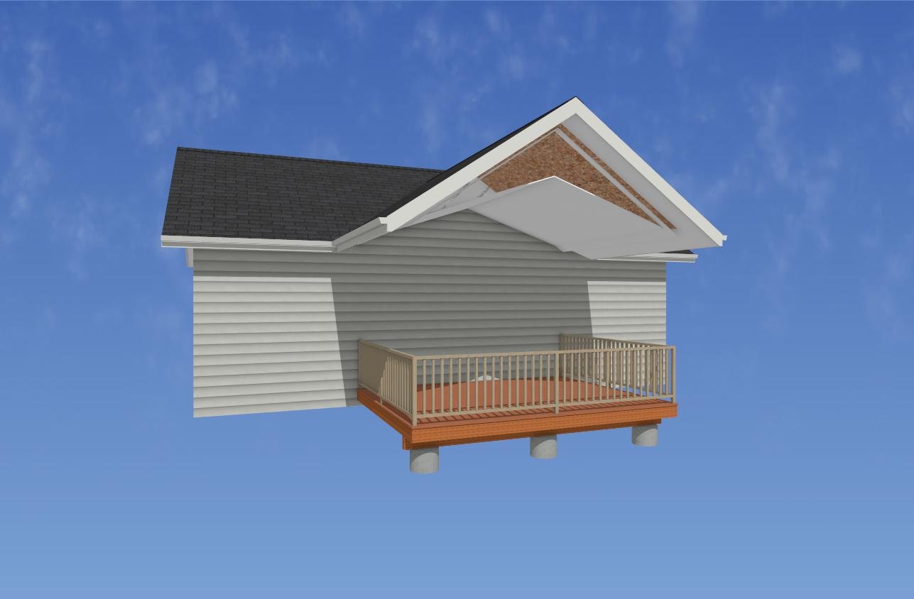

myrtsbnye Posted September 4, 2025 Share Posted September 4, 2025 Hello all, Doing a project that has a grand porch with a cathedral ceiling. When the flat ceiling is checked for the porch the gable is shown. But when I uncheck the flat ceiling the gable disappears and place a cathedral ceiling in it's place the gable doesn't reappear. I've clicked the railing and in the roof section have clicked on the full gable wall. What am I doing wrong? I'm using X16. I'll attach a basic pic showing the missing gable wall Link to comment Share on other sites More sharing options...

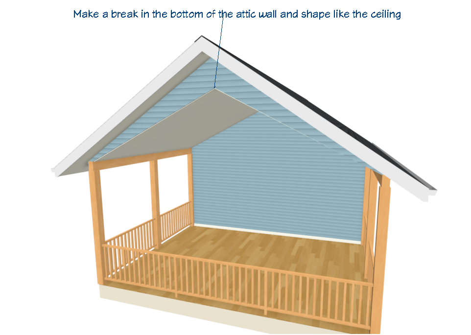

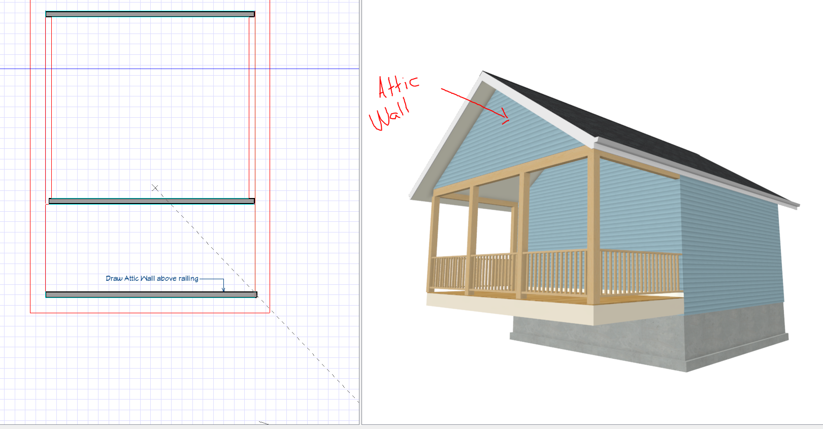

Garybills Posted September 4, 2025 Share Posted September 4, 2025 You can manually draw an attic wall to get a wall in the gable end if you're wanting it closed in with cathedral ceiling inside. Link to comment Share on other sites More sharing options...

myrtsbnye Posted September 4, 2025 Author Share Posted September 4, 2025 1 hour ago, Garybills said: You can manually draw an attic wall to get a wall in the gable end if you're wanting it closed in with cathedral ceiling inside. Thanks for your reply, the client is looking for the gable to follow the cathedral ceiling. Link to comment Share on other sites More sharing options...
Chrisb222 Posted September 4, 2025 Share Posted September 4, 2025 15 minutes ago, myrtsbnye said: Thanks for your reply, the client is looking for the gable to follow the cathedral ceiling. You can also manually draw an attic wall and set to "Roof cuts wall at bottom." I'm not in Chief right now and can't test it but this should work. You may need to extend the ceiling planes into the wall space slightly. Link to comment Share on other sites More sharing options...
Garybills Posted September 4, 2025 Share Posted September 4, 2025 You can break the bottom of the attic wall and shape it to match the ceiling. @chrisb22 I tried to set it to roof cuts bottom, but it cut to the bottom of the roof and not the ceiling. Link to comment Share on other sites More sharing options...
