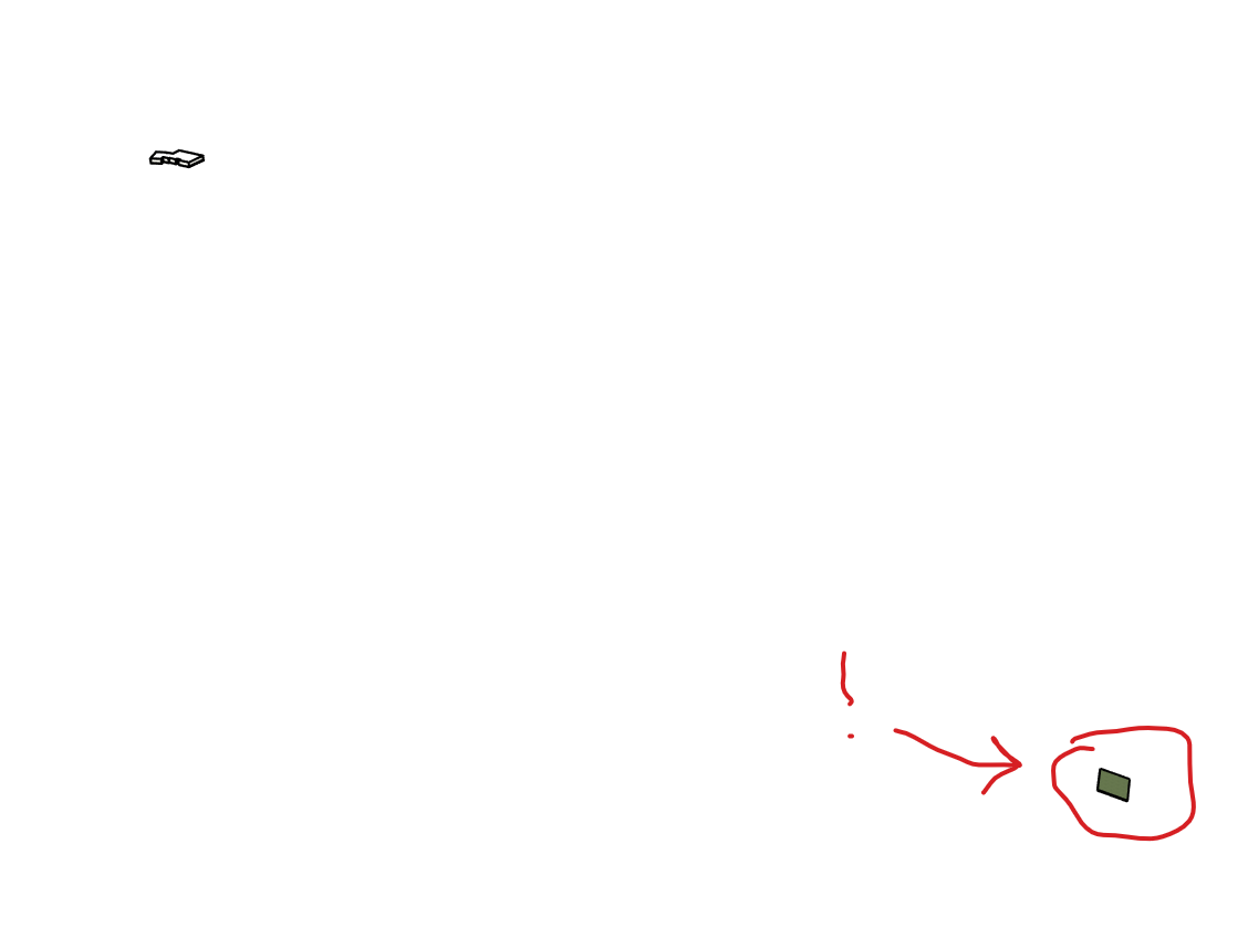

cjanderson66 Posted August 27, 2025 Share Posted August 27, 2025 (edited) Hopefully someone can answer this. I have imported a survey into a new plan and when I try to create a terrain perimeter it does not allow me too. I have tried everything! I have even drew a polyline around the entire property to convert that into a terrain perimeter and it will not make it into one. Young - site plan.plan Edited August 27, 2025 by cjanderson66 Link to comment Share on other sites More sharing options...
DBCooper Posted August 27, 2025 Share Posted August 27, 2025 You can't make a terrain perimeter if you already have one anywhere else in the plan. If it's not that, then post the plan. 1 1 Link to comment Share on other sites More sharing options...
SHCanada2 Posted August 27, 2025 Share Posted August 27, 2025 ...might be related... Link to comment Share on other sites More sharing options...
cjanderson66 Posted August 27, 2025 Author Share Posted August 27, 2025 2 hours ago, DBCooper said: You can't make a terrain perimeter if you already have one anywhere else in the plan. If it's not that, then post the plan. I don't have a terrain perimeter and I even did a clear terrain to try and get rid of anything that might be there. So I posted the plan to see if someone can see what the situation is. Link to comment Share on other sites More sharing options...
JKEdmo Posted August 27, 2025 Share Posted August 27, 2025 5 minutes ago, cjanderson66 said: I don't have a terrain perimeter and I even did a clear terrain to try and get rid of anything that might be there. So I posted the plan to see if someone can see what the situation is. Christopher - It's already there. It's just hiding off to the side. Jim 1 Link to comment Share on other sites More sharing options...
cjanderson66 Posted August 27, 2025 Author Share Posted August 27, 2025 5 minutes ago, JKEdmo said: Christopher - It's already there. It's just hiding off to the side. Jim Just as you posted this I found it. Thx Link to comment Share on other sites More sharing options...
