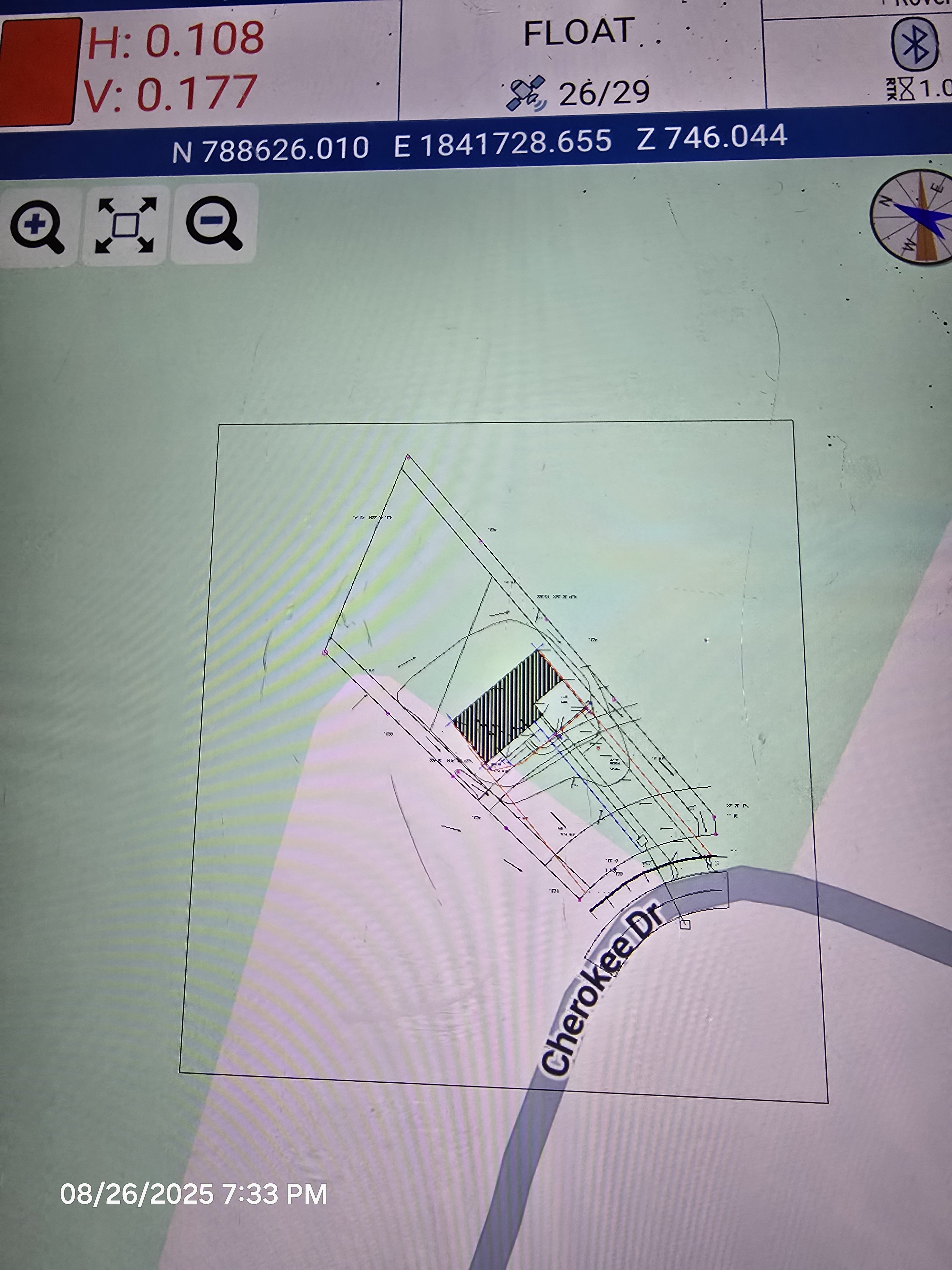

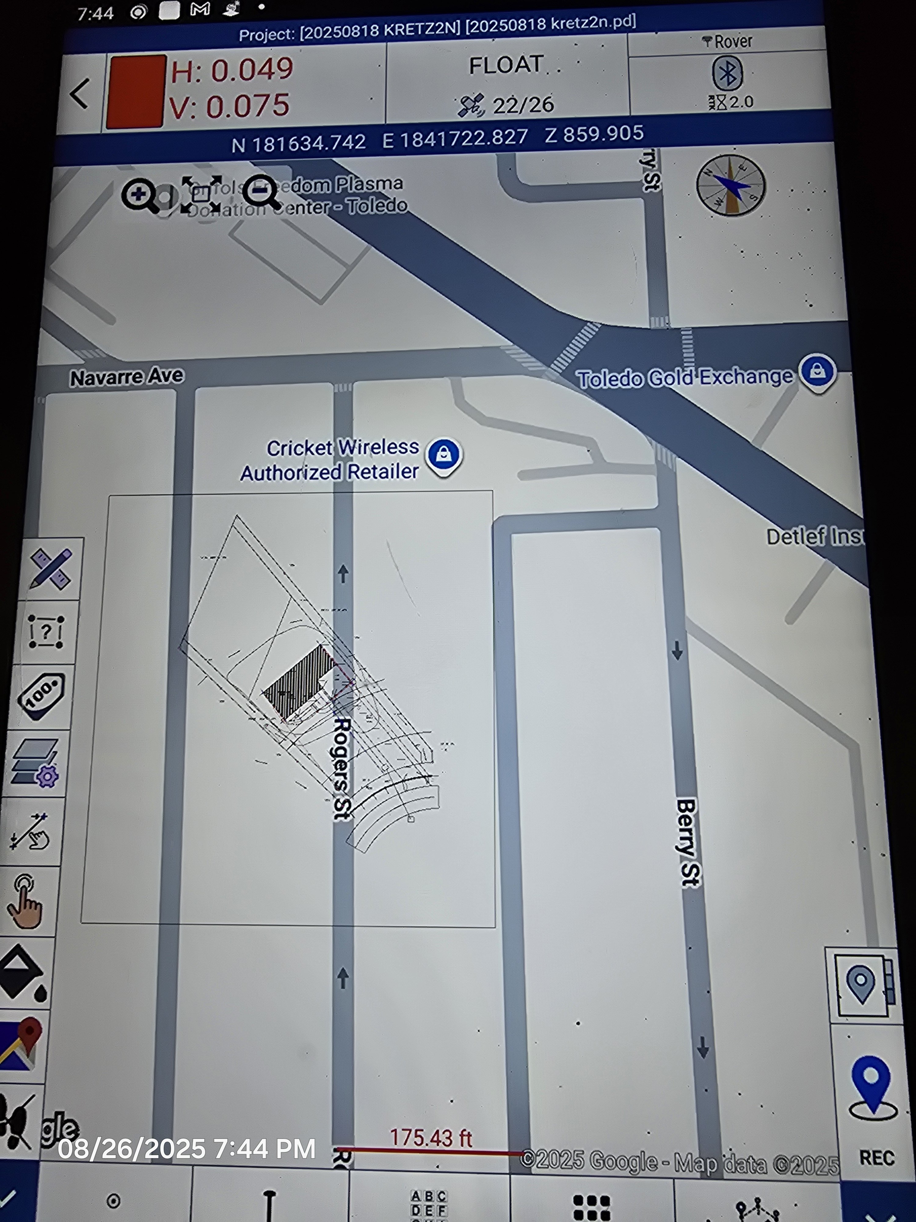

JiAngelo Posted August 26, 2025 Share Posted August 26, 2025 HELPFUL #1 The files we receive from surveyors are based on the distance from a state plane's origin (0,0, altitude). There are 124 state planes in the US. Long story short, they eliminate having to account for the curvature of the earth over longer distances. Here in Ohio we have two state planes, 3401 and 3402. We build in both. A plot plan created and exported for 3401 will appear correctly on a gis map (including google) if you tie it to 3401 state plane. We have a new project in 3402 out near Lake Choctaw, London Ohio. We shot the property pins. Imported DXF to Chief, drew our plot plan, foundation, driveway location and then exported a dxf from Chief and imported it into our 3402 based project file. We walked the site last week, verified the property pins still matched up amd then staked our foundation and driveway centerlines. Here's what happens when you import the dxf into a 3401 based project. Notice the plot plan appears up in Toledo Ohio on Rogers street, southwest of the intersection of Woodville Rd & Navarre Ave. Thats how helpful the origin is in this instance. Link to comment Share on other sites More sharing options...
