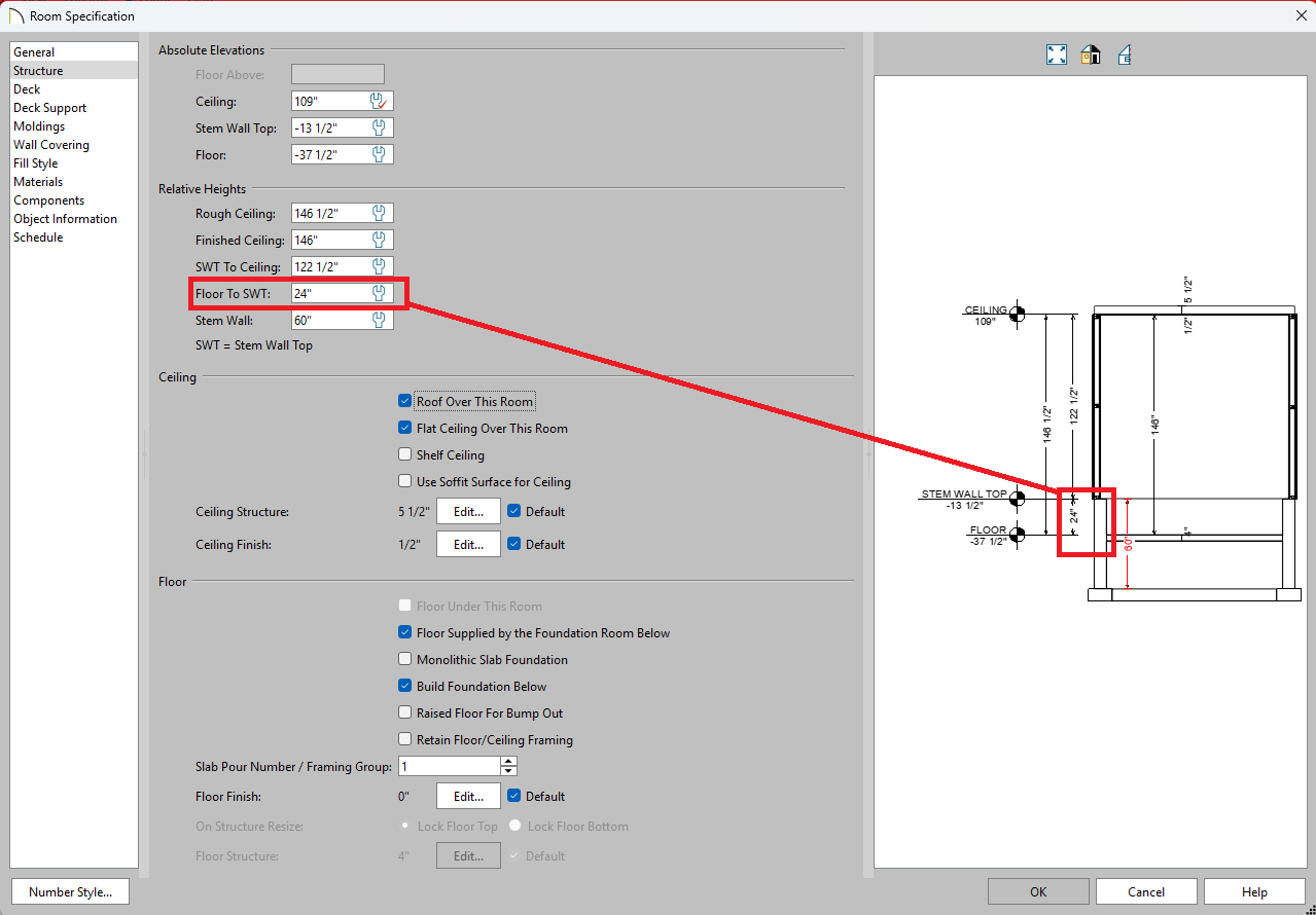

joey_martin Posted July 28, 2025 Share Posted July 28, 2025 Link to comment Share on other sites More sharing options...
