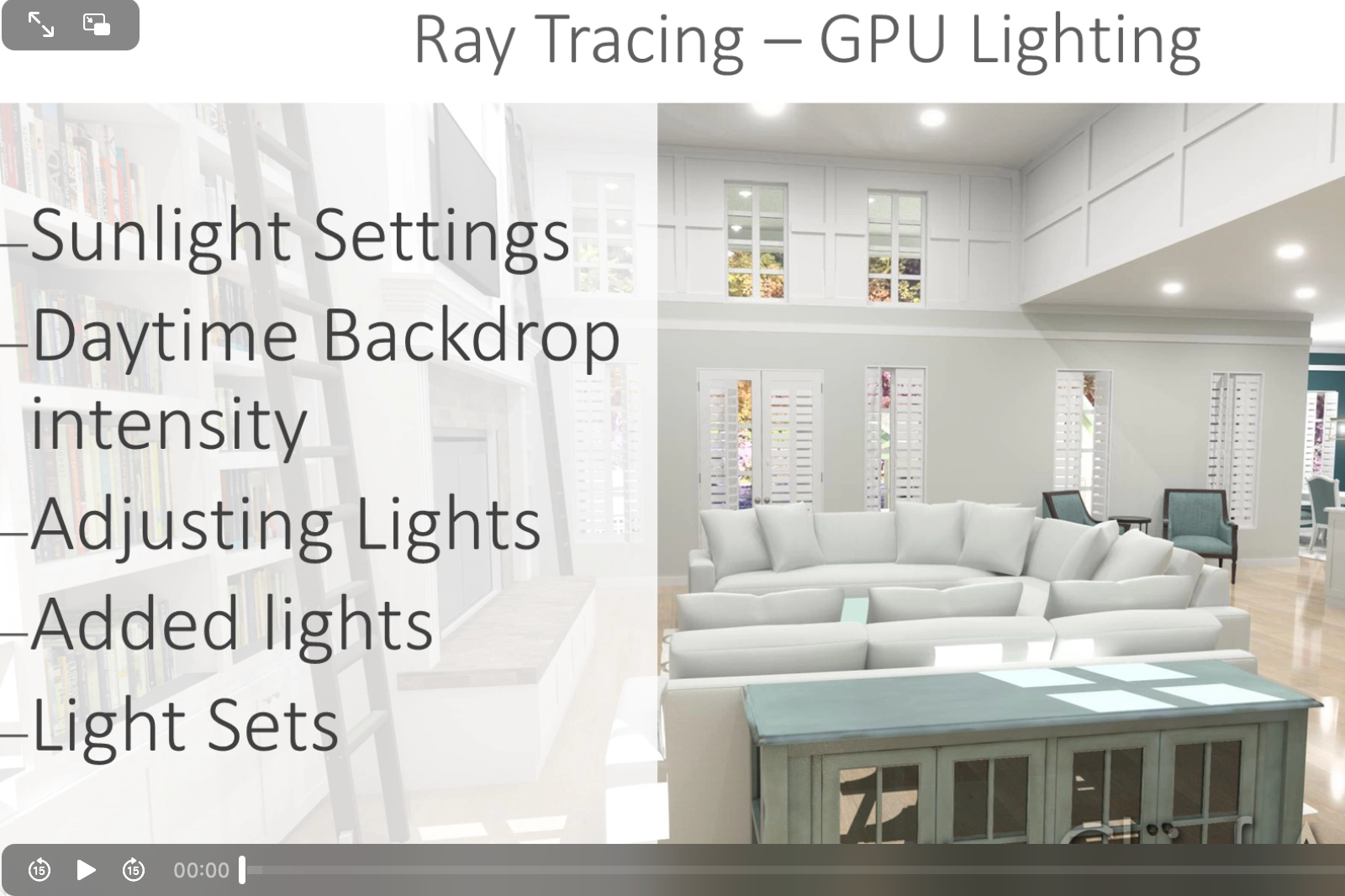

scottharris Posted July 25, 2025 Share Posted July 25, 2025 GPU ray tracing is the core rendering technology in X17; the CPU ray tracer was removed – info why in this post. If you want to improve your GPU ray tracing, here's a video https://www.chiefarchitect.com/videos/watch/1972/ray-tracing-gpu-lighting.html 1 Link to comment Share on other sites More sharing options...

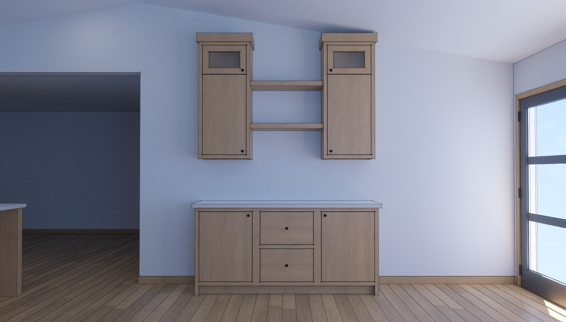

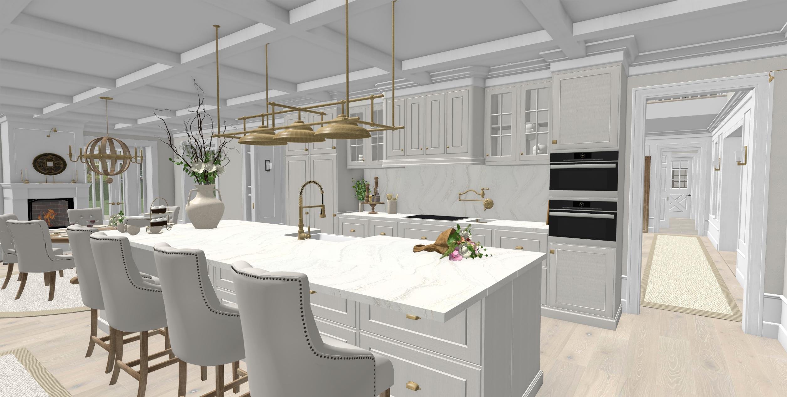

JonathanK Posted July 25, 2025 Share Posted July 25, 2025 19 hours ago, Pat-CW2 said: I sure hope that doesn't mean I only have the PBR ability. That quality sucks I'm curious...what are your issues with it? The attached is OOTB settings with CA and the Physically Based camera (I did add lines in for clarity). But you can see, I don't have a backdrop, I don't have a ton of lights, I spent very minimal time on setting the sun angle so it's physically accurate for the homeowner. And all of the materials are generic CA materials. Nothing special. But the result looks very good and clean. No light leakage like the past, no stray lighting, no weird reflections or overly reflective. The Physically Based camera is very impressive compared to even the old "CPU Raytrace" method. 2 Link to comment Share on other sites More sharing options...

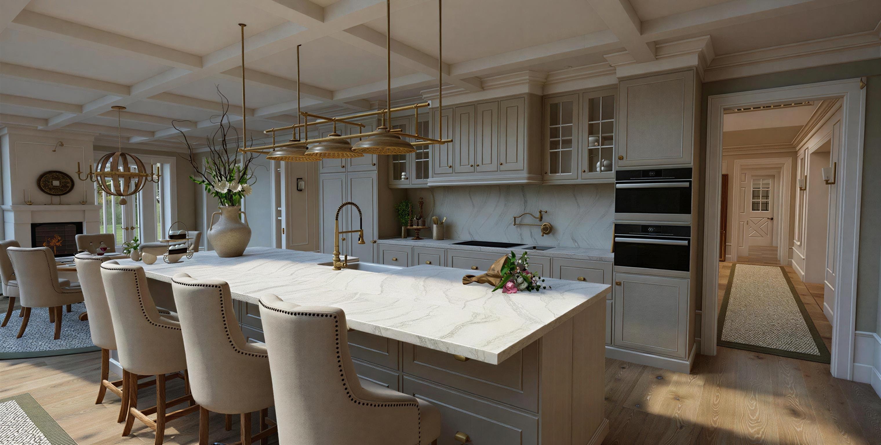

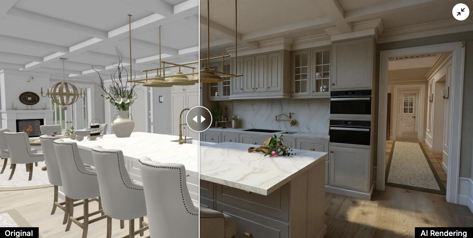

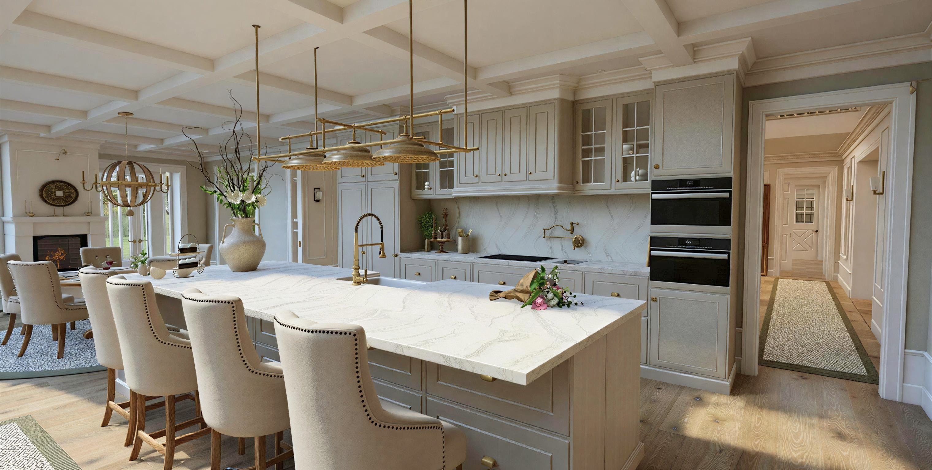

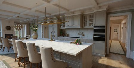

HeidiMikalsen Posted August 5, 2025 Share Posted August 5, 2025 (edited) I was shocked when I upgraded from x16 to x17 and discovered that the Ray Trace ability is lost. My solution was to use RederAI to improve my pictures. Too bad that Chief goes back in development regarding photorealistic pictures. original X17: ReRenderAI: ReRender AI with some more brightening. Edited August 5, 2025 by HeidiMikalsen Extra picture 1 Link to comment Share on other sites More sharing options...
