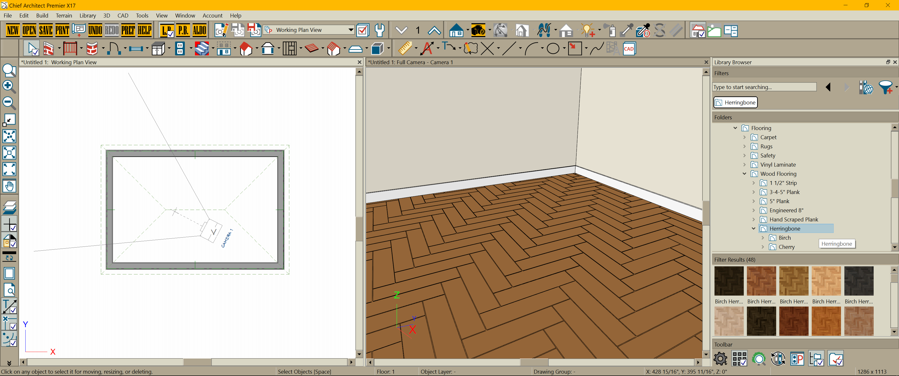

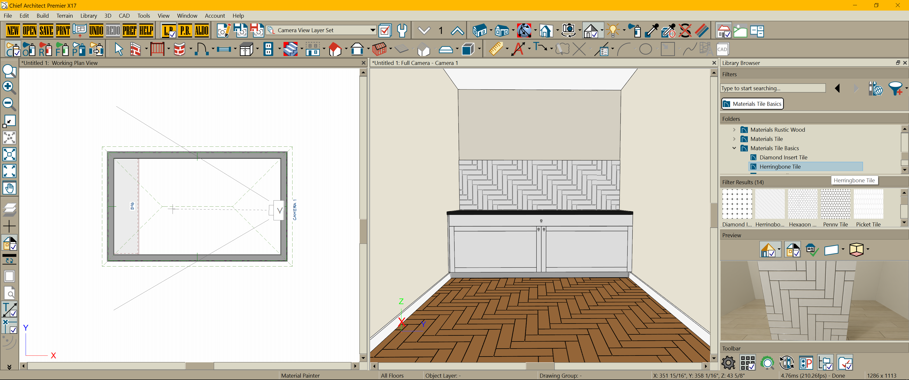

Rich_Winsor Posted July 19, 2025 Share Posted July 19, 2025 12 hours ago, Leadcarpo said: Can anyone give me some advice? Have you had a look at the Herringbone Materials in the Library? They have Herringbone Materials in both Flooring and Tile: Core Catalogs/Materials/Flooring/Wood Flooring/Herringbone Bonus Catalogs/Materials Tiles Basics/Herringbone Tile Link to comment Share on other sites More sharing options...
