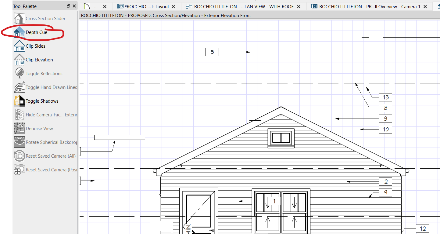

HumbleChief Posted June 12, 2025 Share Posted June 12, 2025 There's a feature in X16 where you can 'gray out' front portions of an elevation but I can't remember what it's called or where it is. Don't even know how to phrase the question so hope the question is clear enough. Thank You in Advance. Link to comment Share on other sites More sharing options...
Solution JKEdmo Posted June 12, 2025 Solution Share Posted June 12, 2025 9 minutes ago, HumbleChief said: There's a feature in X16 where you can 'gray out' front portions of an elevation but I can't remember what it's called or where it is. Don't even know how to phrase the question so hope the question is clear enough. Thank You in Advance. I think you might be looking for Depth Cue? 1 Link to comment Share on other sites More sharing options...
HumbleChief Posted June 12, 2025 Author Share Posted June 12, 2025 THANK YOU!!! But I see it only affects the elevation portion behind and not the portion in front. No worries I'll figure some thing out. Link to comment Share on other sites More sharing options...
