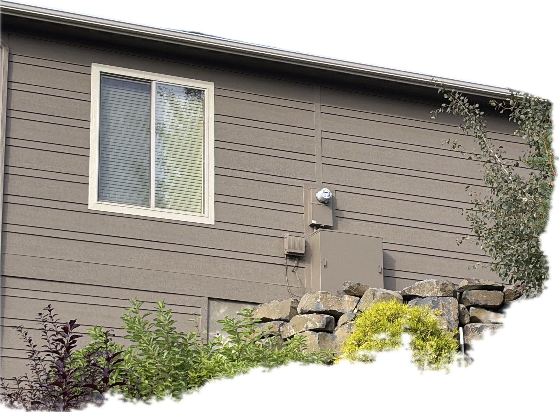

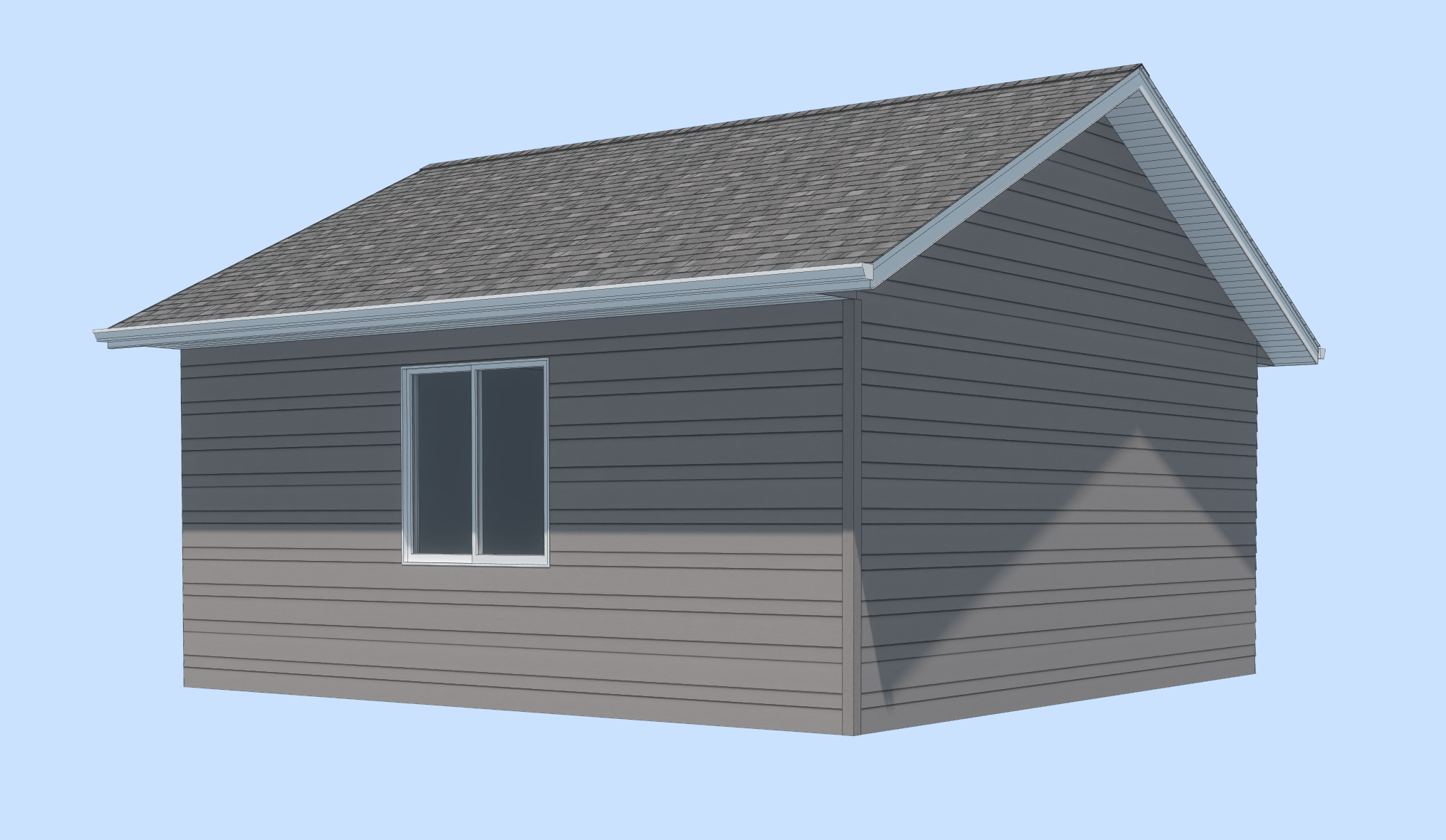

AbeLopez Posted Thursday at 05:48 PM Share Posted Thursday at 05:48 PM How can I match this siding? Link to comment Share on other sites More sharing options...
Joe_Carrick Posted Thursday at 06:19 PM Share Posted Thursday at 06:19 PM It can be done in X18 with a 3D Siding Profile. Since you're using X16 I don't know a simple way to do it. Link to comment Share on other sites More sharing options...
PitMan71 Posted yesterday at 02:28 PM Share Posted yesterday at 02:28 PM Create or copy a siding material, find a seemless siding texture that looks like that, then update the pattern to a hatch that is simlar. If you cant find a texture, you might be able to create one with an existing texture, load it up in photoshop or photopea(online editor). Link to comment Share on other sites More sharing options...

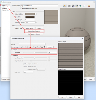

PitMan71 Posted yesterday at 02:50 PM Share Posted yesterday at 02:50 PM Link to comment Share on other sites More sharing options...

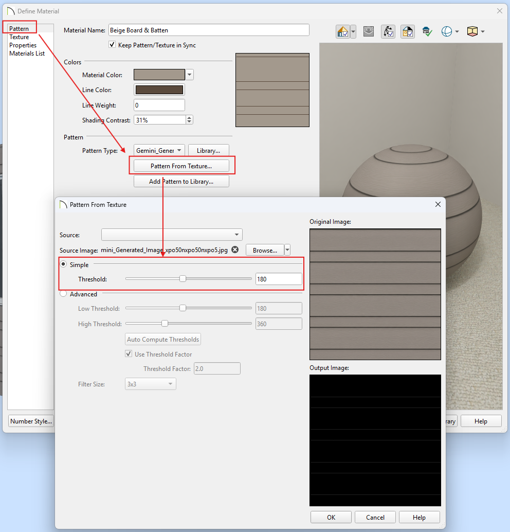

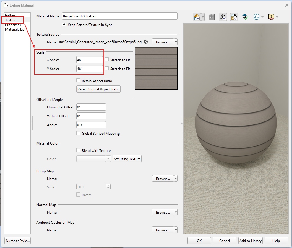

JonathanK Posted 22 hours ago Share Posted 22 hours ago (edited) 15 seconds in AI got this. I set the texture to 48x48, and had Chief generate the pattern for me. I set the threshold to something like 180 so it cleared out all the noise and just left the horizontal lines. Looks pretty close...other than I don't know what your reveal is. But this should scale appropriately. Edited 22 hours ago by JonathanK 2 Link to comment Share on other sites More sharing options...
