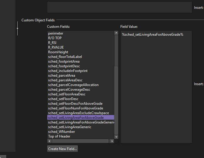

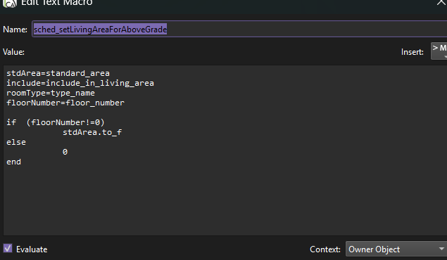

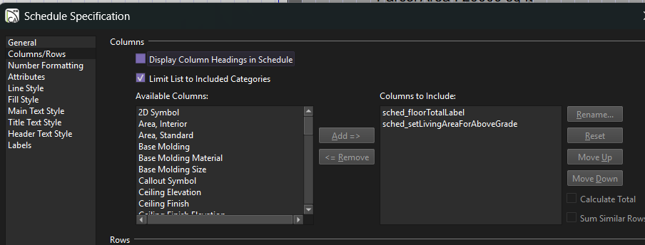

SHCanada2 Posted August 15 Share Posted August 15 (edited) ive seen this as hit or miss. I have an OIP in the room that checks properties of the room and floor number, and then assigns the area to the OIP in the room based on some logic These seem to work fine in a schedule. But When I was trying to do something on a window label, it sometimes worked and sometimes didn't. One schedule would work, and then I would copy the schedule and it would not work. it looked like a race condition between the schedule and the window label when you say "Calculate incorreclty" do you mean return error, or something else? so it should be interesting to see what they come back with for example in my room I have: and that macro is: and the schedule is The above all works fine: schedule is one line, shown below: Edited August 15 by SHCanada2 Link to comment Share on other sites More sharing options...

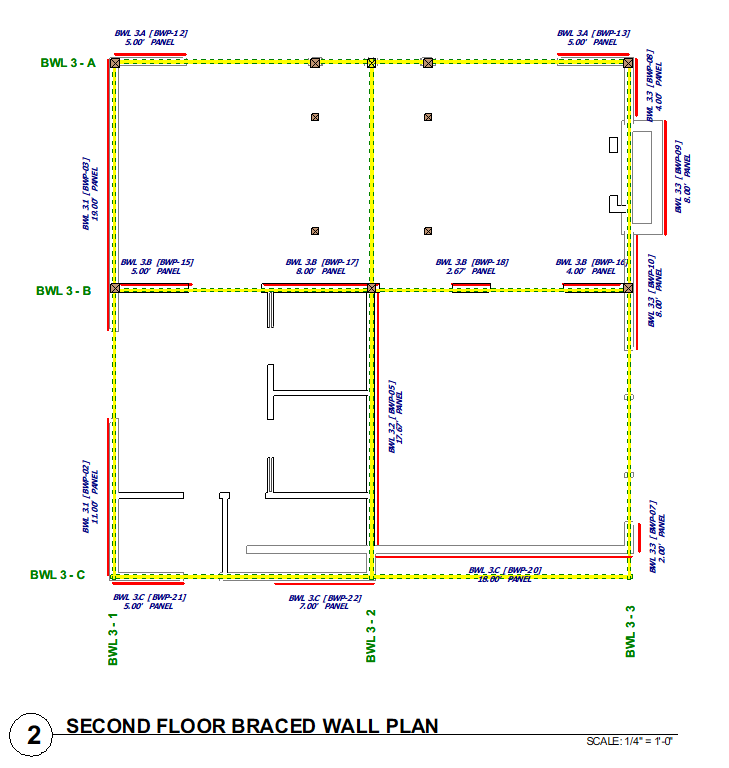

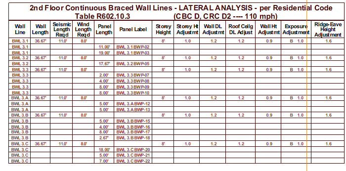

Joe_Carrick Posted August 25 Author Share Posted August 25 (edited) 44 minutes ago, Alaskan_Son said: Can you post a simple example of what you're talking about Joe? Hi Michael, I've since changed the macros for the columns that needed to reference certain values which were previoulsy created as $Globals by other columns. Now all the columns are independent with the critical columns getting and calculating everything internally. I'm including a copy of a plan with schedule that shows what I'm doing. The plan is a "Braced Wall Plan" with a Schedule. Columns 3 & 4 of the Schedule indicate the required lengths of panels for seismic and wind. Columns 4 & 5 show the lengths of panels assigned to each wall line. Previously columns 8-13 created $Global variables that the macros for columns 3 & 4 used to return a value. Those $Globals were supposed to be used in the macros for required panel lengths but they jst didn't work. With my current implementation there are only a couple of $Globals needed and they are created elseware in the Layout and/or Plan. Edited August 25 by Joe_Carrick Link to comment Share on other sites More sharing options...
