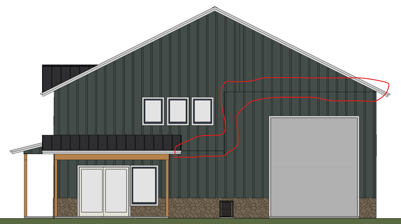

AbeLopez Posted August 13 Share Posted August 13 Why is my wall line showing up? Link to comment Share on other sites More sharing options...

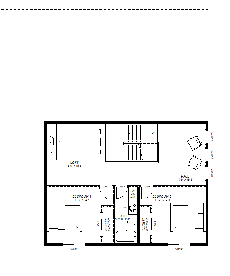

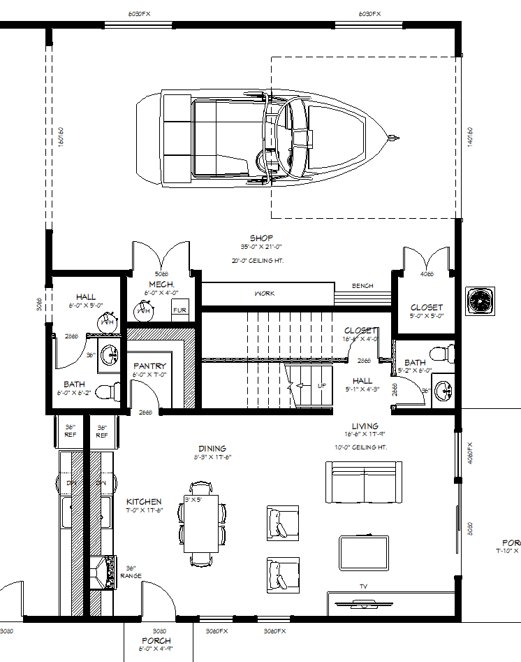

DBCooper Posted August 13 Share Posted August 13 (edited) Check to see if your walls above and below are aligned. Check to see if they are set to the default top and bottom height. Check to see if they are using the same wall types and materials. If that doesn't help, then post your plan. Edited August 13 by DBCooper Link to comment Share on other sites More sharing options...
CharlesVolz Posted August 13 Share Posted August 13 (edited) Howdy Abe, From my notes (no guarantees): Exterior Wall Vertical Lines in Vector View: Solutions: 1. Check your walls’ vertical alignments. 2. Check Wall Specification> Structure Tab> Default Wall Heights are both 3. Make sure all the walls are the same Wall Type, or at least have the same width for all materials outside the main layer (if aligned via the main layer). 4. Open your plan materials dialog and merge the ones with the same names. Edited August 13 by CharlesVolz Link to comment Share on other sites More sharing options...
