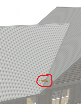

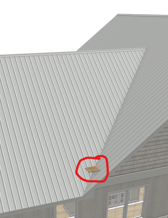

winterdd Posted Monday at 02:51 PM Share Posted Monday at 02:51 PM How do you guys fix this? I have attic space floor framed and sheathed for storage and it sticks thru the valley. I have it as "unfinished" room type. Link to comment Share on other sites More sharing options...
Doug_N Posted 22 hours ago Share Posted 22 hours ago Rob, what happens if you change it to some other room type. I assume that you don't want to use the room type attic is that right? Link to comment Share on other sites More sharing options...
winterdd Posted 13 hours ago Author Share Posted 13 hours ago 9 hours ago, Doug_N said: Rob, what happens if you change it to some other room type. I assume that you don't want to use the room type attic is that right? Correct, I had it labled as unfinished but even with calling it an attic space it is still sticking out of the valley. Link to comment Share on other sites More sharing options...
ValleyGuy Posted 10 hours ago Share Posted 10 hours ago On 8/10/2026 at 11:51 AM, winterdd said: How do you guys fix this? I have attic space floor framed and sheathed for storage and it sticks thru the valley. I have it as "unfinished" room type. You might be able to treat it like a garage slab.... make the attic flooring (or sub-flooring) a 'no material', then make a 3D solid material as your plywood to fit your space properly. Link to comment Share on other sites More sharing options...

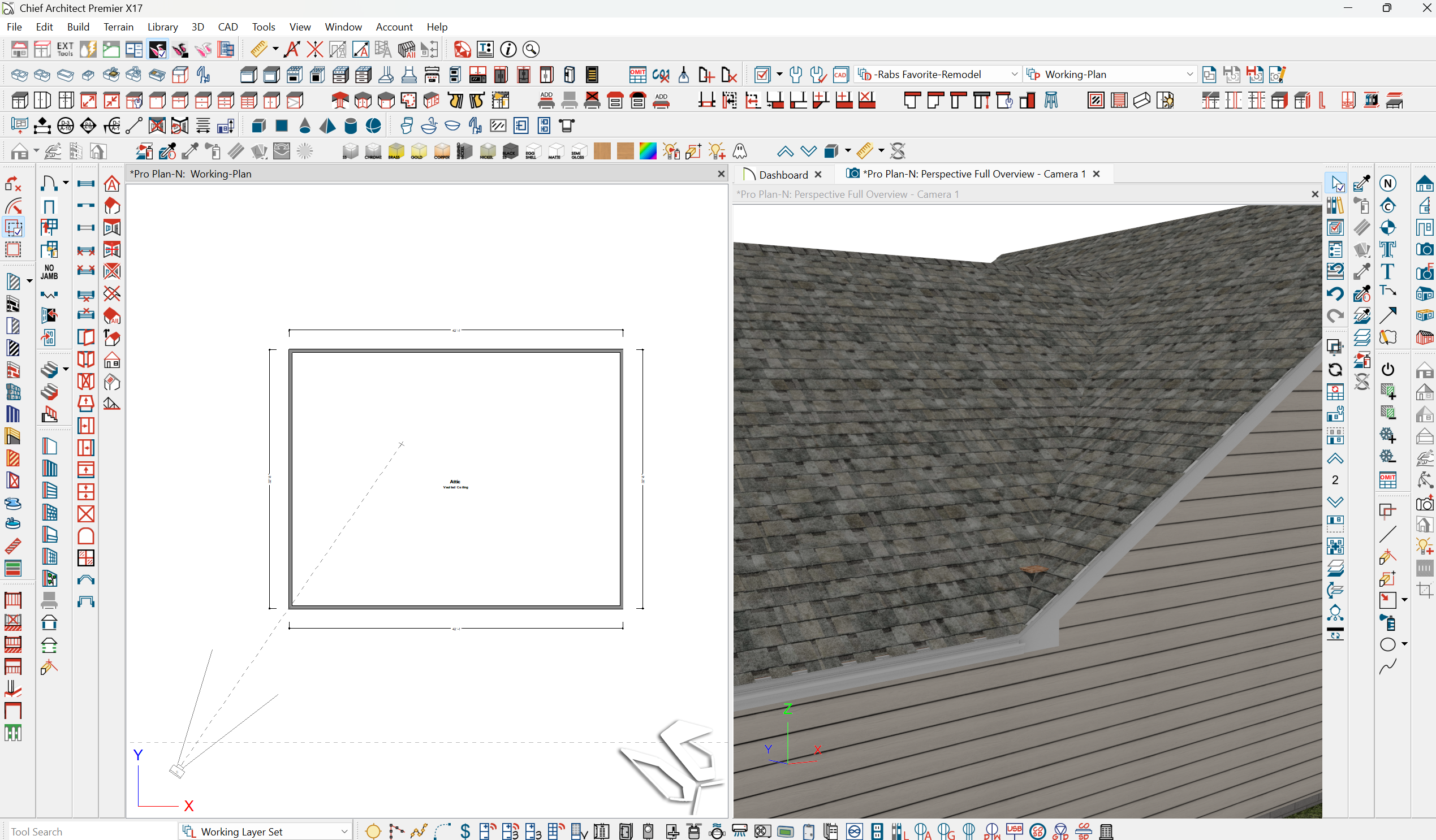

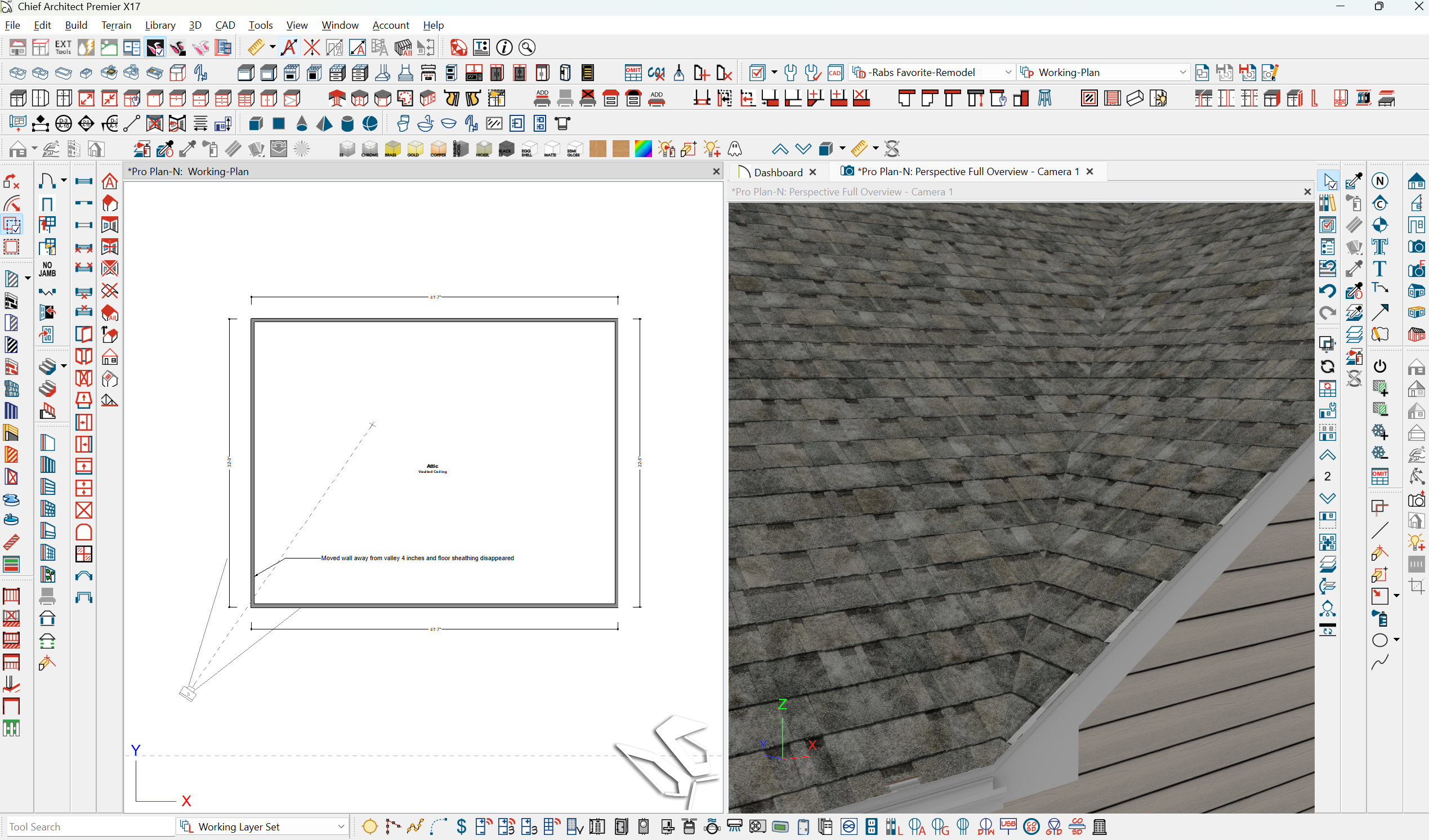

Garybills Posted 4 hours ago Share Posted 4 hours ago @winterddDid you create a 2nd floor for the attic? That's what I did to get the attic to form a room, the fist picture the side wall goes all the way over to the valley and the second picture I pulled the wall away from the valley 4 inches and the subfloor disappeared. Link to comment Share on other sites More sharing options...
