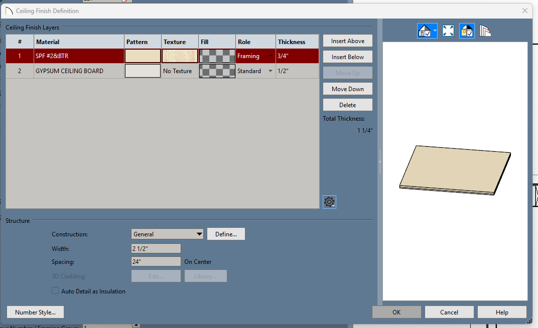

robdyck Posted Thursday at 09:07 PM Share Posted Thursday at 09:07 PM Hey Gene, all you need to do is add a framing layer to the ceiling finish for that room. Super simple. Link to comment Share on other sites More sharing options...

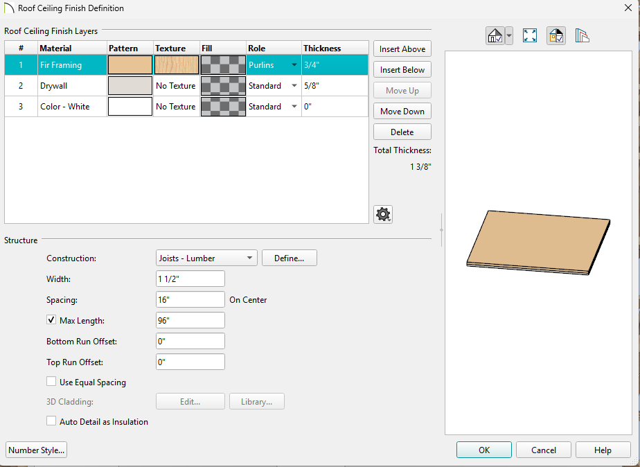

GeneDavis Posted Friday at 12:10 PM Author Share Posted Friday at 12:10 PM Hey, @robdyck, thanks, but I did that, and it won't frame. What is the secret for Chief autoframing it with the 1x3s I specified (3/4" thick framing layer above my ceiling finish, 16" centers, 2.5" widths, fir framing 1 texture, layer specified as framing), and those straps run perpendicular to the trusses? Link to comment Share on other sites More sharing options...

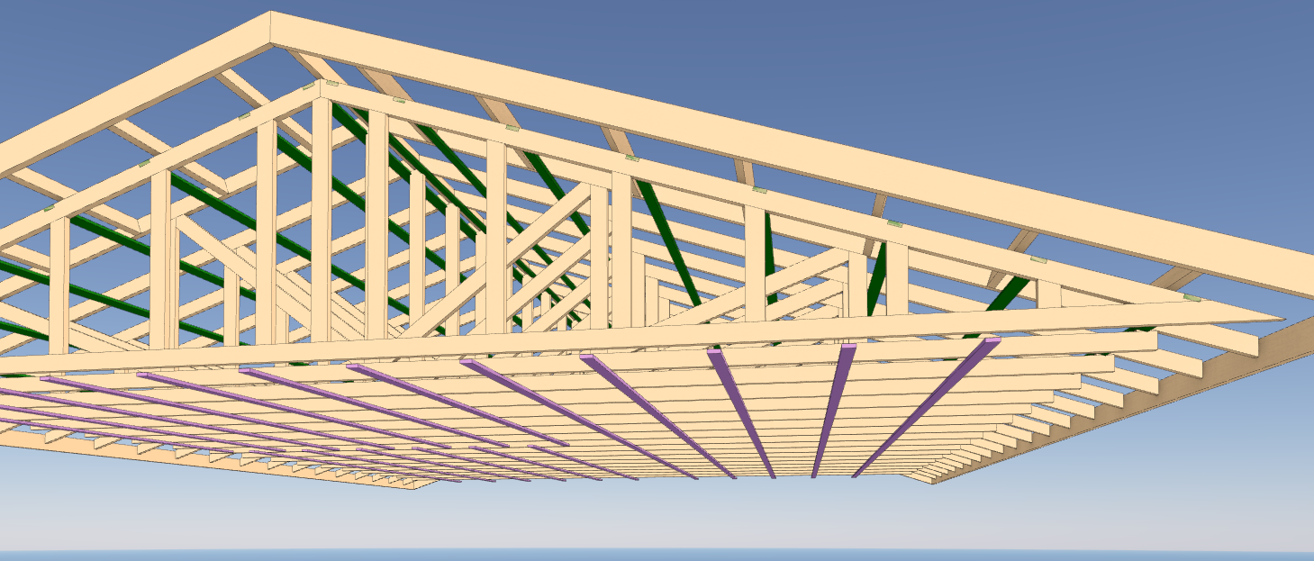

JonathanK Posted Friday at 02:05 PM Share Posted Friday at 02:05 PM I think this might be a bug... I thought that maybe you put it on the ceiling layer of the roof, but for some reason...this places purlins on the bottom side of the top chord of the truss. So it looks like either manually draw the framing, or try and build a floor above with invisible walls and 3/4" thick floor...or something like that. Link to comment Share on other sites More sharing options...

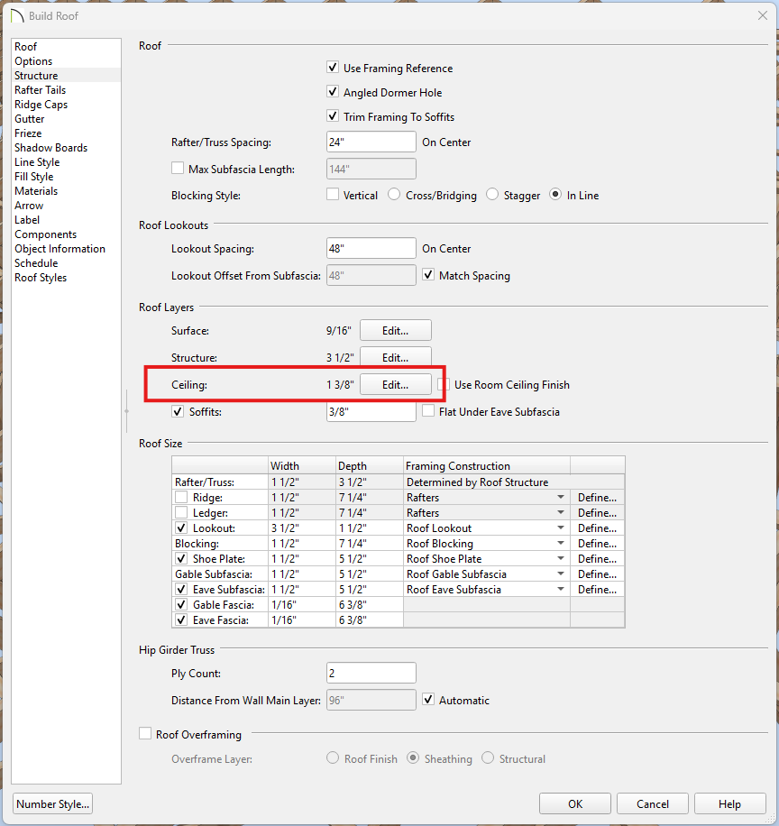

robdyck Posted Friday at 02:48 PM Share Posted Friday at 02:48 PM If you add framing to the Ceiling Finish layers, the framing will build separately for each room. And, it may not fully build until a joist direction arrow is created. BUT, if you add the framing to the Roof Layers > Ceiling: then the purlins will build more continuously and will disregard room boundaries...but look closely and you'll see that they are attached to the underside of the top chord. Link to comment Share on other sites More sharing options...
