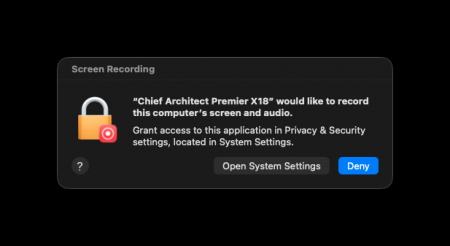

para-CAD Posted Sunday at 11:20 PM Share Posted Sunday at 11:20 PM .......why? Link to comment Share on other sites More sharing options...
Joe_Carrick Posted yesterday at 12:29 AM Share Posted yesterday at 12:29 AM I think that's a new feature of the latest Windows 11 update. Link to comment Share on other sites More sharing options...
para-CAD Posted yesterday at 12:48 AM Author Share Posted yesterday at 12:48 AM I’m on a mac, so that might narrow it down to chief, possibly in the future, allowing people to screen record within chief. Link to comment Share on other sites More sharing options...
Joe_Carrick Posted yesterday at 02:50 AM Share Posted yesterday at 02:50 AM I still think it's either the OS or an App that's doing it. I seriously doubt it's Chief. Link to comment Share on other sites More sharing options...
ConnorE Posted 20 hours ago Share Posted 20 hours ago (edited) We need this permission granted for the Color Chooser's eyedropper tool to work properly. This was added in x17. As far as I'm aware, we don't use this permission for anything else. Edit: We also need this permission for the Capture Screen tool, which has been around many years. Edited 19 hours ago by ConnorE Link to comment Share on other sites More sharing options...
Gawdzira Posted 19 hours ago Share Posted 19 hours ago That sounds like a bug, not a feature. @ConnorE This is a level of hell I would like to not enter. 1 Link to comment Share on other sites More sharing options...
