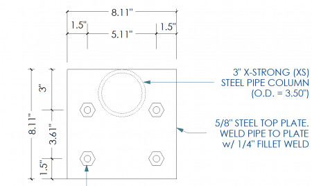

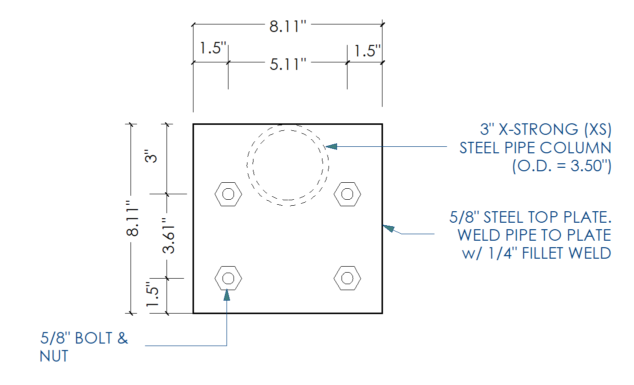

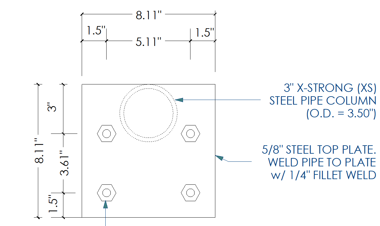

bdammeyer Posted June 8 Share Posted June 8 Hello - Anybody have a drawing I can use to copy over some tighter dashed line types? With line weights toggled off - looks good: When Toggled on - Dash spacing is too large: Maybe a quick recap on how to change them in the line types dialog would help also... I've tried with little success. Thanks, Ben x17 Windows RTX3080 1 Link to comment Share on other sites More sharing options...

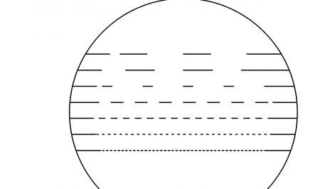

Chrisb222 Posted June 8 Share Posted June 8 Go to CAD > Lines > Line Style Management, copy one of the dashed lines and see how it's defined, edit to what you want. Or use one of these: dashed lines.plan Link to comment Share on other sites More sharing options...
DBCooper Posted June 8 Share Posted June 8 (edited) Do you already have "dash (tiny)" in your plan? If not, you should have it in the core libraries. You can then just select it and draw a new line in your plan and it should then be available for anything in the plan. If you do, and it's still too big, then you can make a new one that is smaller. Just copy "dash (tiny)" to your user library. Rename it something like "super tiny" or whatever. Open the dialog and change the length and spacing from 1/32" to 1/64". This tech article has more info: https://www.chiefarchitect.com/support/article/KB-01019/managing-and-creating-line-styles.html Edited June 8 by DBCooper Link to comment Share on other sites More sharing options...
bdammeyer Posted June 8 Author Share Posted June 8 Thank you!! Link to comment Share on other sites More sharing options...
bdammeyer Posted June 8 Author Share Posted June 8 Just matched properties on one of Chrisb222's linetypes and changed the lineweights and got exactly what i was looking for. Many Thanks! 2 Link to comment Share on other sites More sharing options...

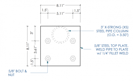

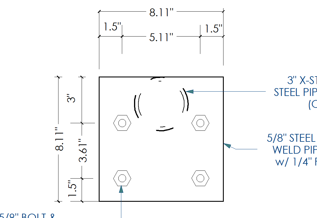

bdammeyer Posted June 11 Author Share Posted June 11 NEW Question about Line Styes.... The dashed lines seem to not dash at each end. The have a "nose" and a "tail" that do not dash correctly. Is this normal? Any way to turn it off? Im trying to draw a detail where i show a dashed line to represent a 4-1/2" screw but it wont show dashed because the ends of lines don't seem to dash. Any way around this issue? Thanks, Link to comment Share on other sites More sharing options...

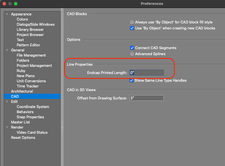

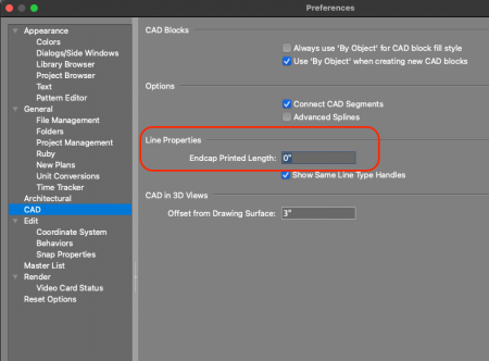

Solution Chrisb222 Posted June 11 Solution Share Posted June 11 37 minutes ago, bdammeyer said: Any way to turn it off? In Preferences, set this value to zero: Link to comment Share on other sites More sharing options...
Chrisb222 Posted June 11 Share Posted June 11 52 minutes ago, bdammeyer said: the ends of lines don't seem to dash Be aware, many times turning off the endcap produces a tiny dash at the end of the line that doesn't look good. I don't like the endcap, but haven't been able to get away from it because most times the endcap looks better than nothing. Link to comment Share on other sites More sharing options...
bdammeyer Posted June 11 Author Share Posted June 11 Thank you Chris! 1 Link to comment Share on other sites More sharing options...
