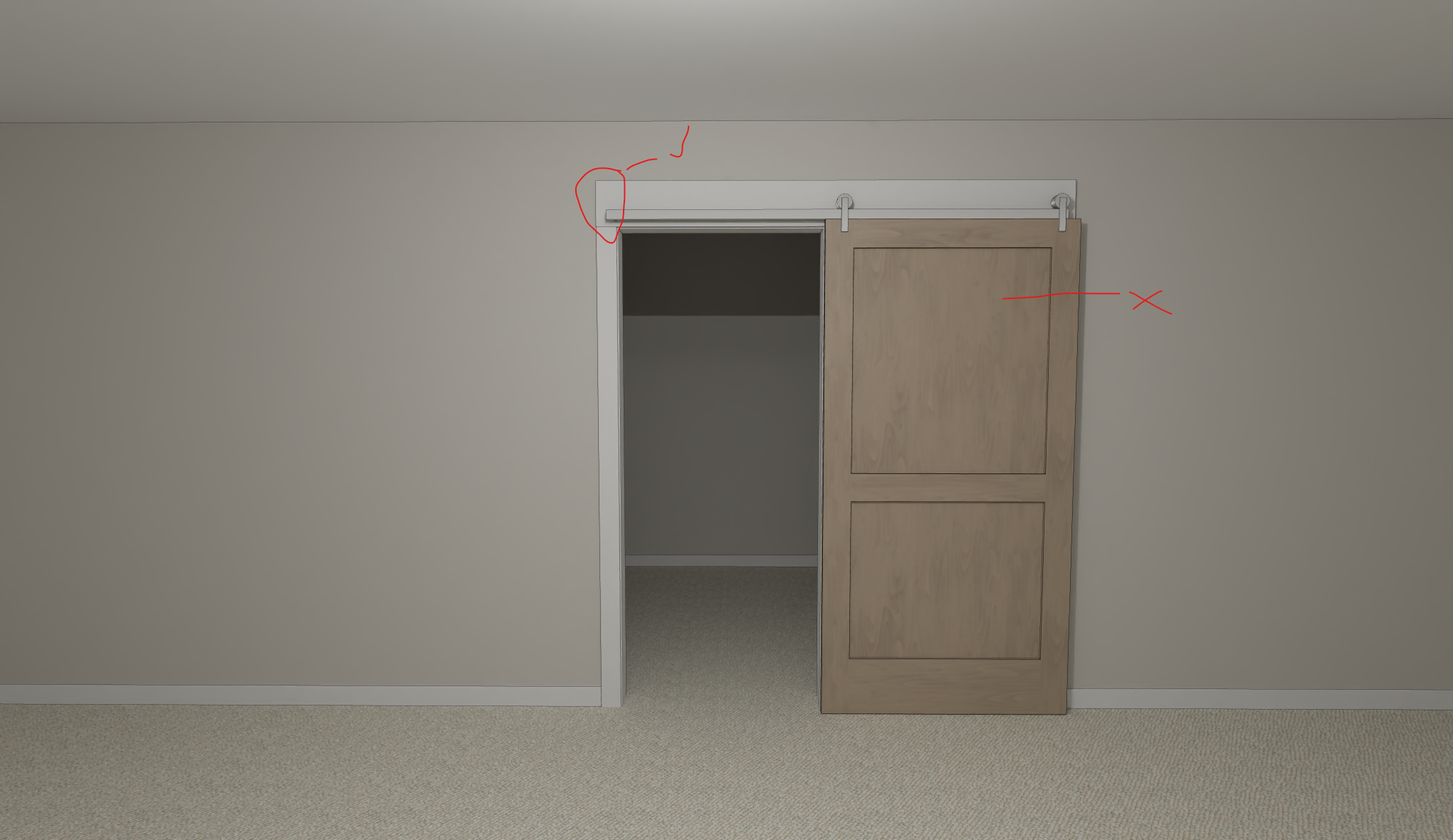

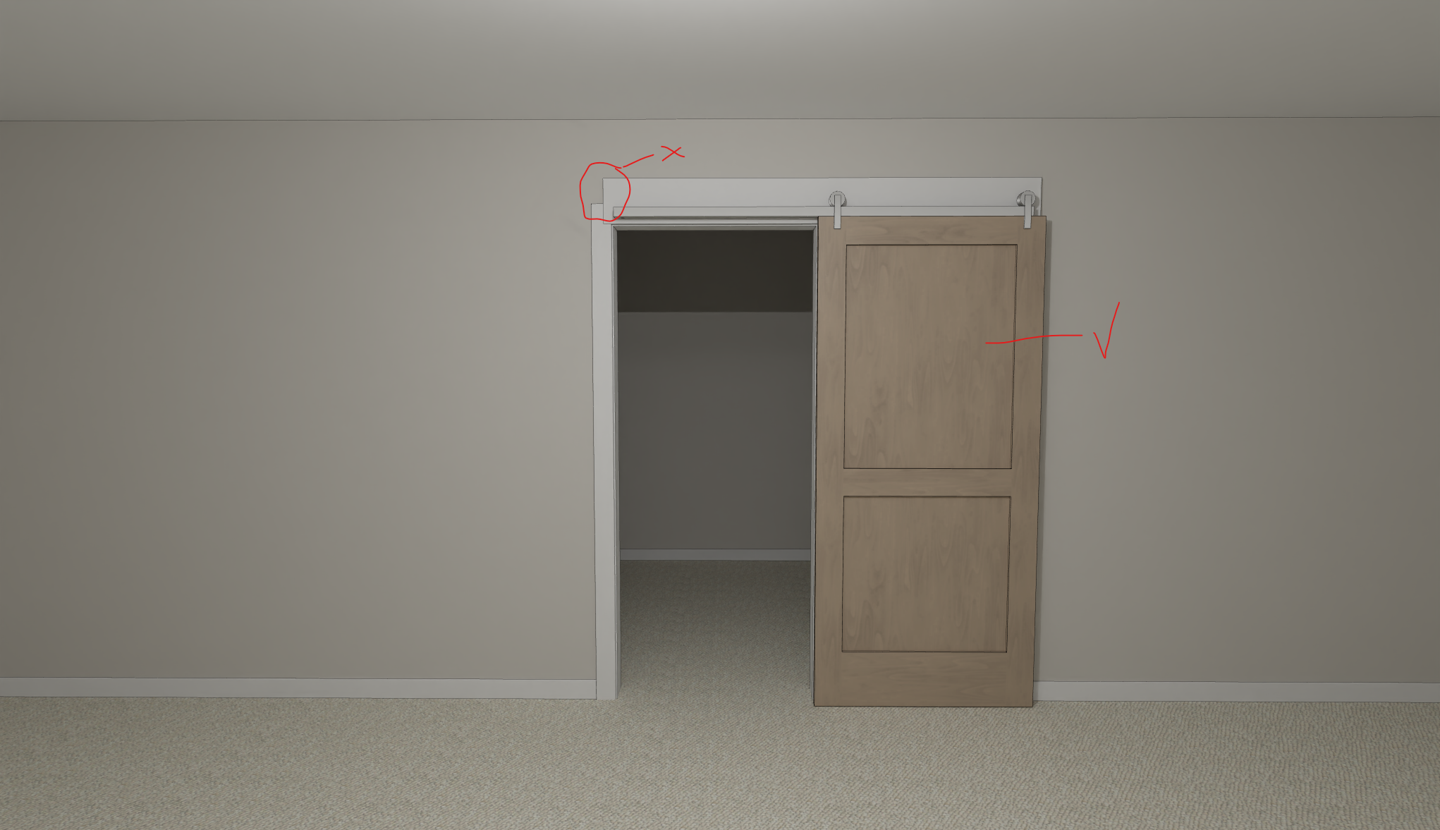

JonathanK Posted May 21 Share Posted May 21 (edited) Is there a way to control a barn door slab width separately from the track above? Typically when we do barn doors, we have a 1x8 mounted to the wall, that the track mounts to. I want that to be a specific width (74-1/2" wide). But I want the slab of my door to be a specific width as well (36" wide). If I set my door so that that width is correct, it makes my track too short. If I set it so that my track is the right width...my door is too wide. See attached... Edited May 21 by JonathanK Link to comment Share on other sites More sharing options...

JonathanK Posted May 21 Author Share Posted May 21 Thanks, Joe. The problem with the lintel is that you cannot specify it being offset to one side or the other. So I made a custom track that has the lintel built in...but now there is this issue... Link to comment Share on other sites More sharing options...
Joe_Carrick Posted May 21 Share Posted May 21 (edited) Can you use a custom Millwork Symbol, Mounts on Wall ? Set a stretch plane at the center of the width. You can then size it to whatever you need. Edited May 21 by Joe_Carrick Link to comment Share on other sites More sharing options...
DBCooper Posted May 24 Share Posted May 24 As far as I can tell, you can control the size of the wall opening and the size of the panel but you really can't control the track. I would just manually place the 1x8 where I wanted and if I was being really picky, I would also manually place the track. Link to comment Share on other sites More sharing options...
JonathanK Posted May 25 Author Share Posted May 25 Thanks, all. I’ll probably submit a suggestion to make these editable independently of each other. We don’t do a ton of them, but I would rather edit everything through the door DBX, rather than placing this piece or that piece. That’s not scalable for multiple users working with the software. I can make the custom track with the 1x mounting board, but I would like to be able to make that any length I want separately from the door slab. Link to comment Share on other sites More sharing options...
