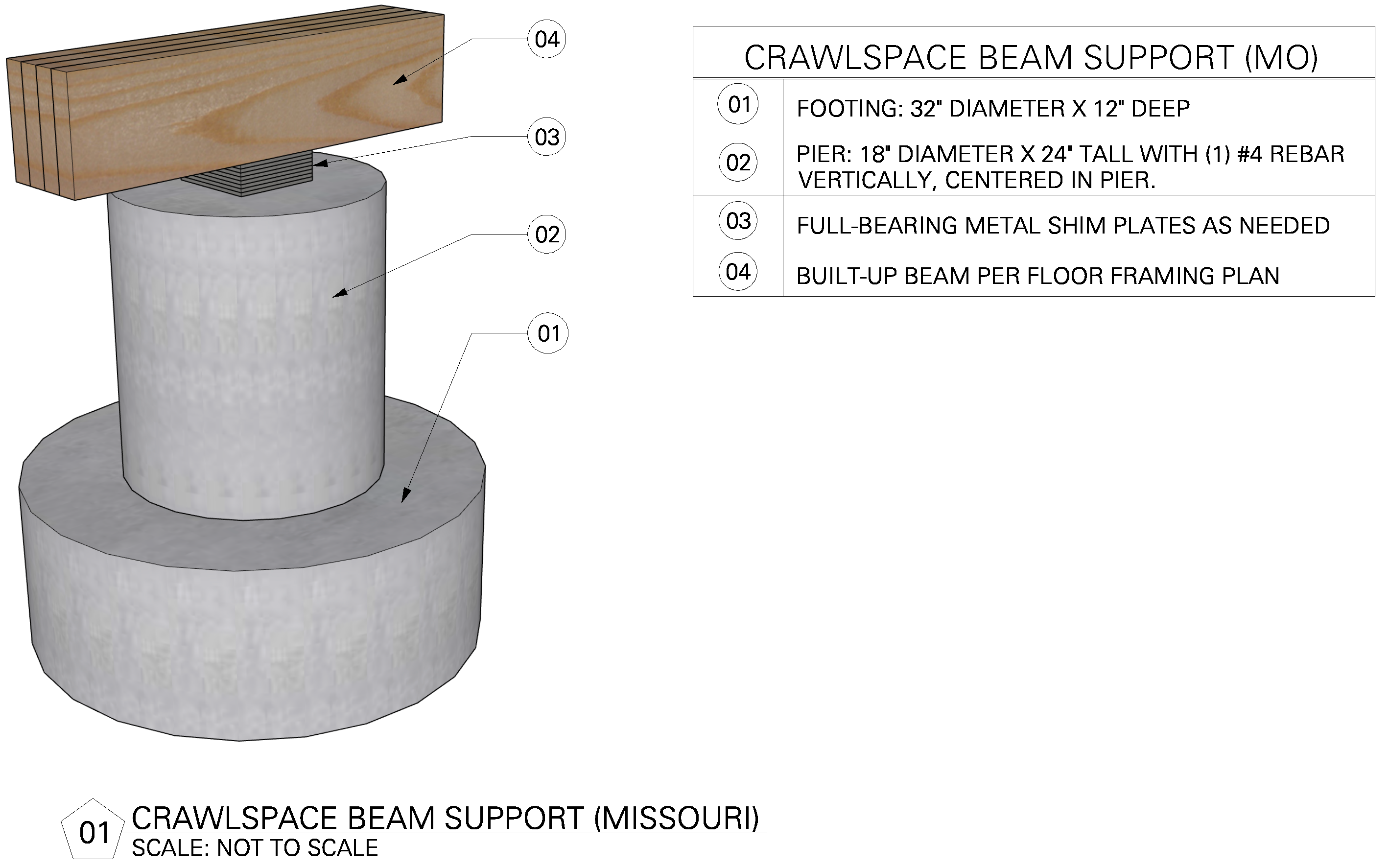

para-CAD Posted Friday at 11:35 PM Share Posted Friday at 11:35 PM I created a simple 3D CAD detail for a Chief User in another state, but I can't find a way to export just that CAD Detail, as a single file that he can import into his CAD Detail library. I'm either ignorant of the process to make this happen (searched for 20 mins) or maybe this is more of a Suggestion or feature request......or maybe there is some cool ruby scripting I can commission from the experts. I attached the detail as a screen shot, but the Chief User would be better served with having the actual Chief CAD Detail installed for future/repetitive use or edits. With the Note Schedule present, I am NOT able to block the whole thing and add it to my Library. Any help is appreciated, and if it can be macro exported in a way that is importable.......I would definitely pay for that feature. Link to comment Share on other sites More sharing options...
GeneDavis Posted yesterday at 01:40 AM Share Posted yesterday at 01:40 AM Put it in a blank plan. Post it here. Then he and we can all have it. Link to comment Share on other sites More sharing options...
para-CAD Posted 23 hours ago Author Share Posted 23 hours ago (edited) I guess this works......let me know. Now that I have a blank CA X17 plan, this works well. It would still be nice just to export a single CAD Detail file for import by others. https://www.dropbox.com/scl/fi/9gm8hd3zvb8t41nggh2pl/CA-Residential-Template.plan?rlkey=azr1x685fssg1jfwhkip1lklx&dl=0 Edited 23 hours ago by para-CAD Link to comment Share on other sites More sharing options...
