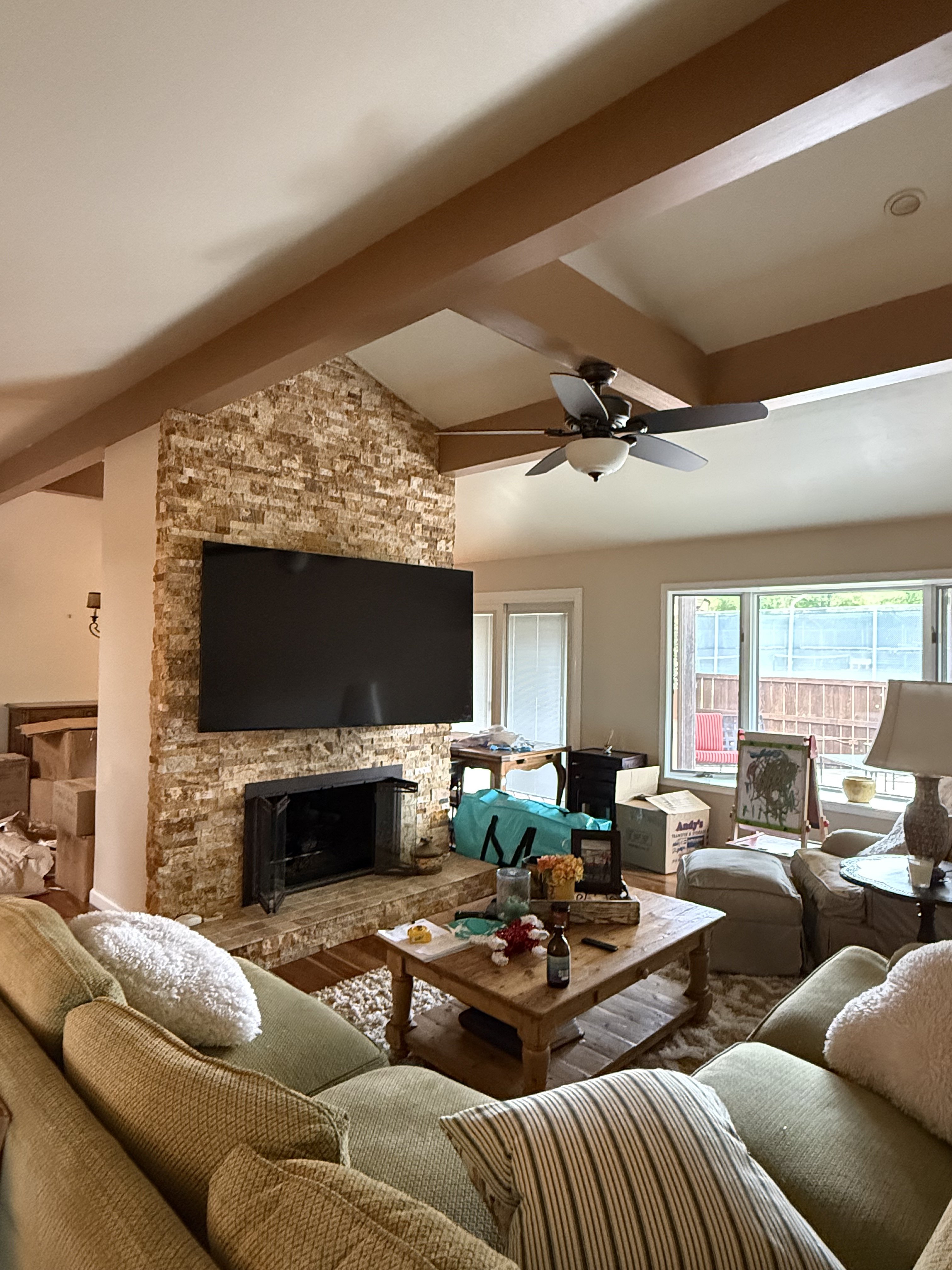

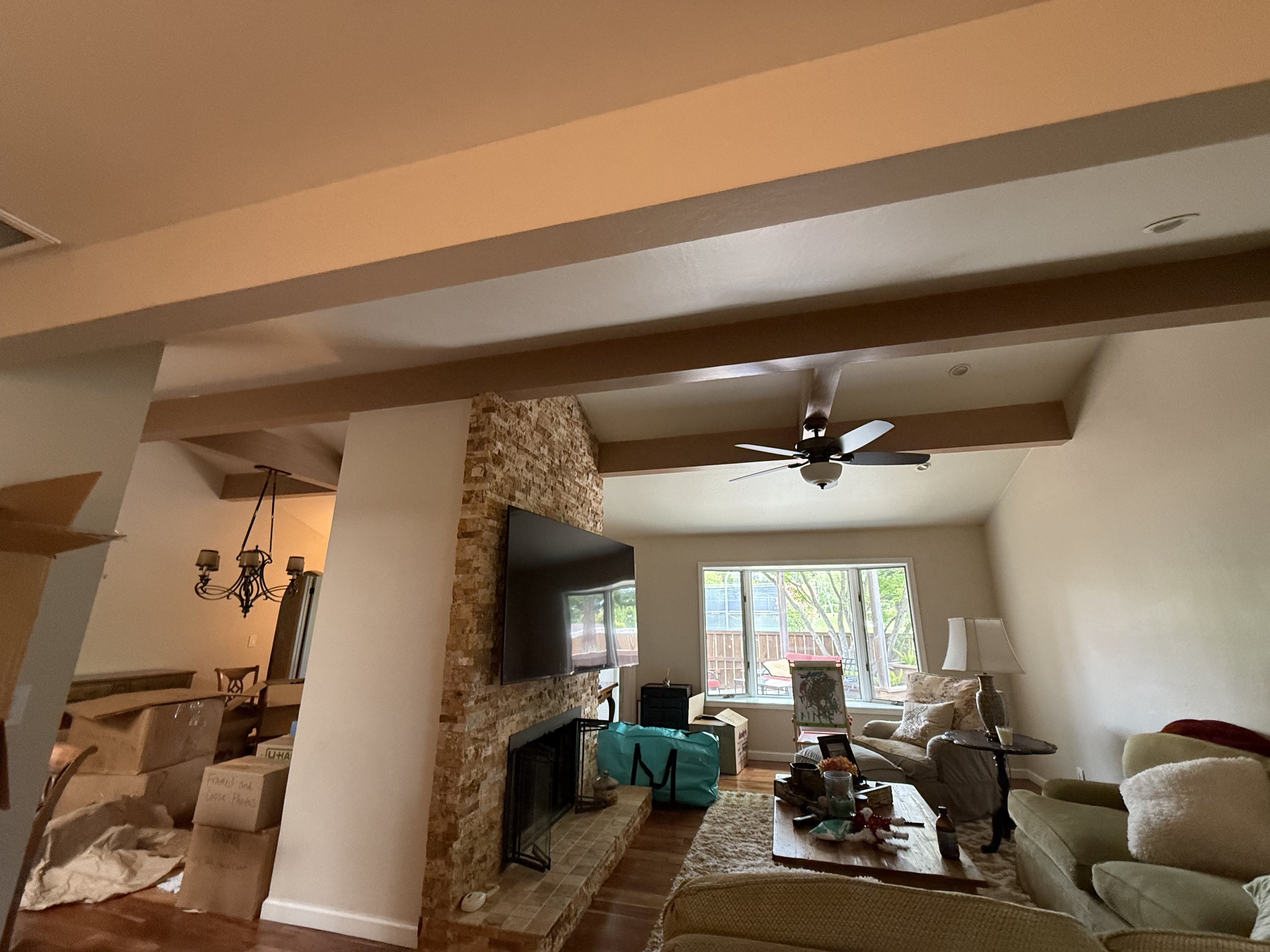

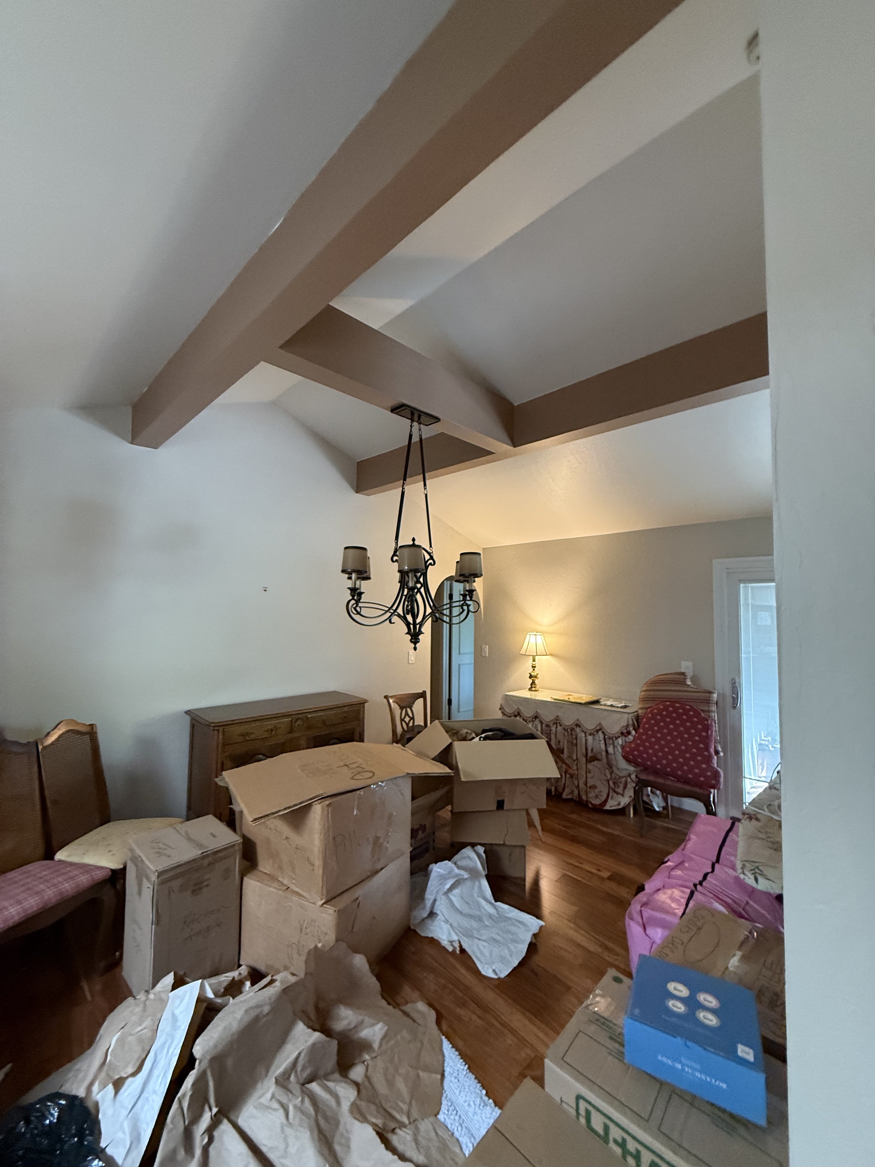

JenHibb Posted May 5 Share Posted May 5 Can anyone help a student here on how to get this pitched roof with beams illustrated with the floating fireplace in the middle of the room? Thank you Link to comment Share on other sites More sharing options...

para-CAD Posted May 5 Share Posted May 5 Is it cathedral or vaulted? Are those beams real or fake for show? What is the ceiling pitch? Take a level with one end touching the lower part of the ceiling, and when you have the level horizontally correct, measure vertically from the end that is not touching the ceiling up to where your tape measure touches the ceiling. and then divide those number of inches by how many feet long your level is, and that will give you the pitch. When you go outside, is the roof pitch steeper than the inside ceiling pitch? Link to comment Share on other sites More sharing options...
