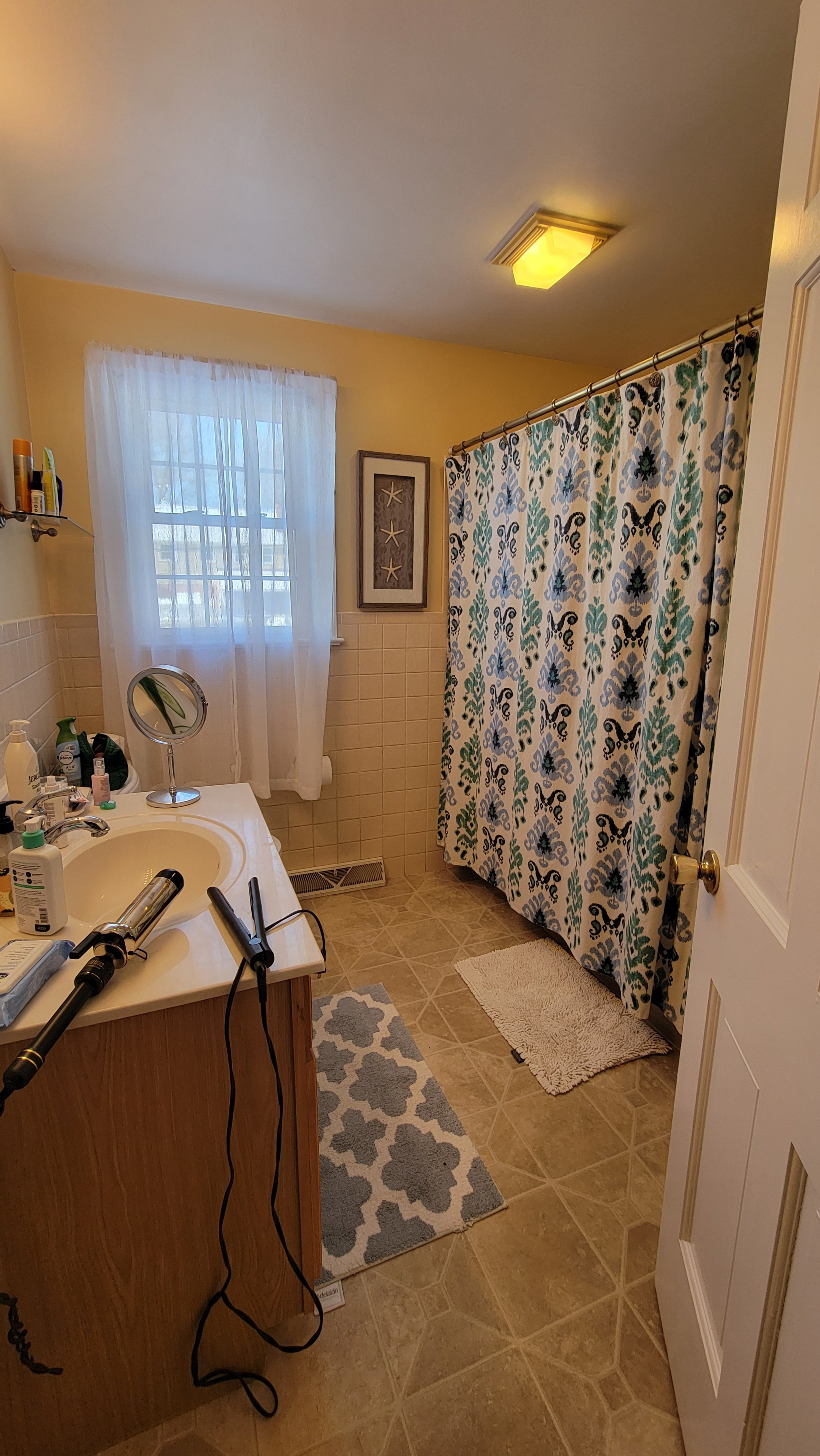

KBEDesign Posted May 4 Share Posted May 4 I have a client who is doing minimal updates in a hall bath and wants a rendering of her selections against her existing materials. She is not changing this floor. Does anyone know how I can somewhat recreate this pattern floor in chief? Chief Architect Premier X17 Link to comment Share on other sites More sharing options...
