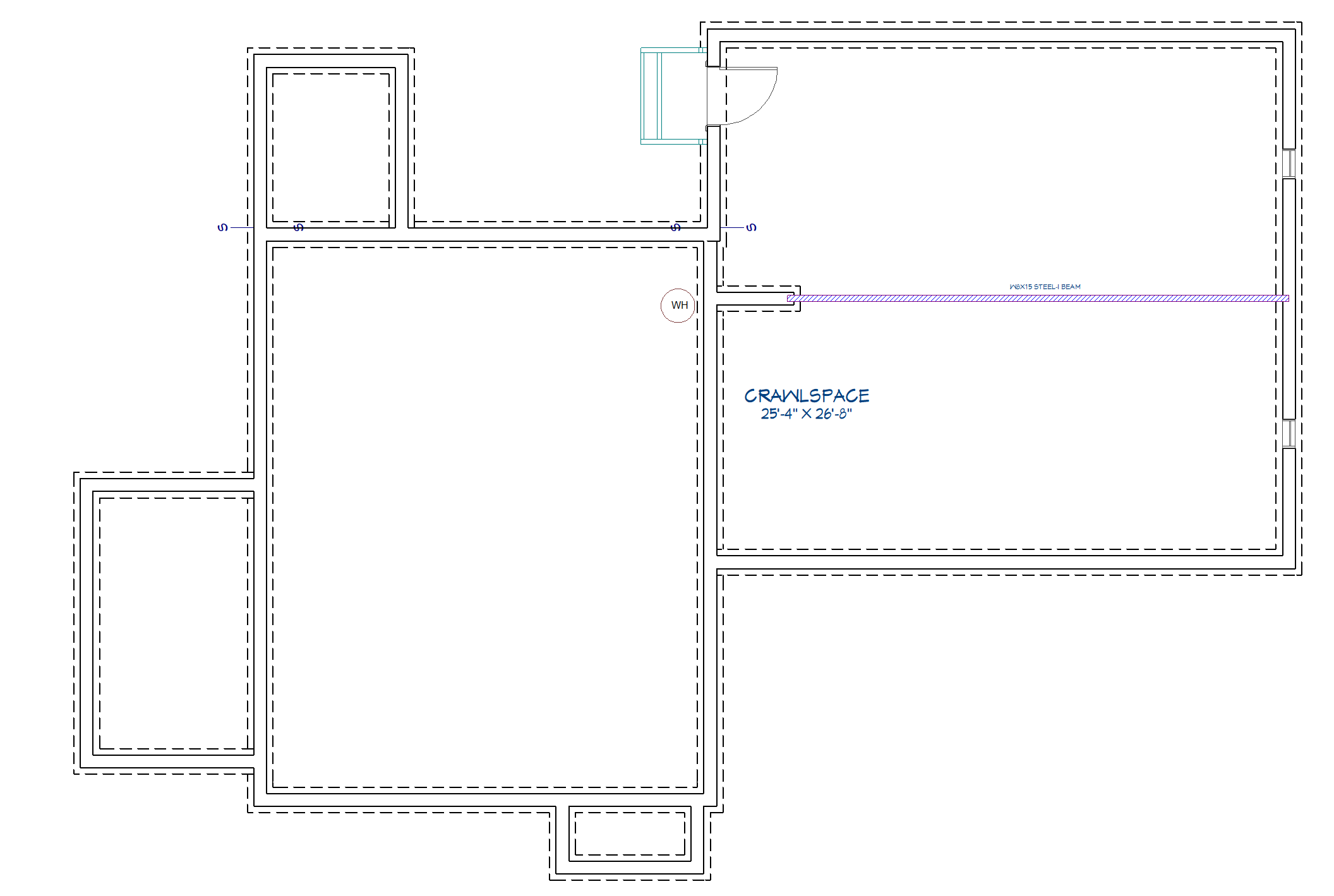

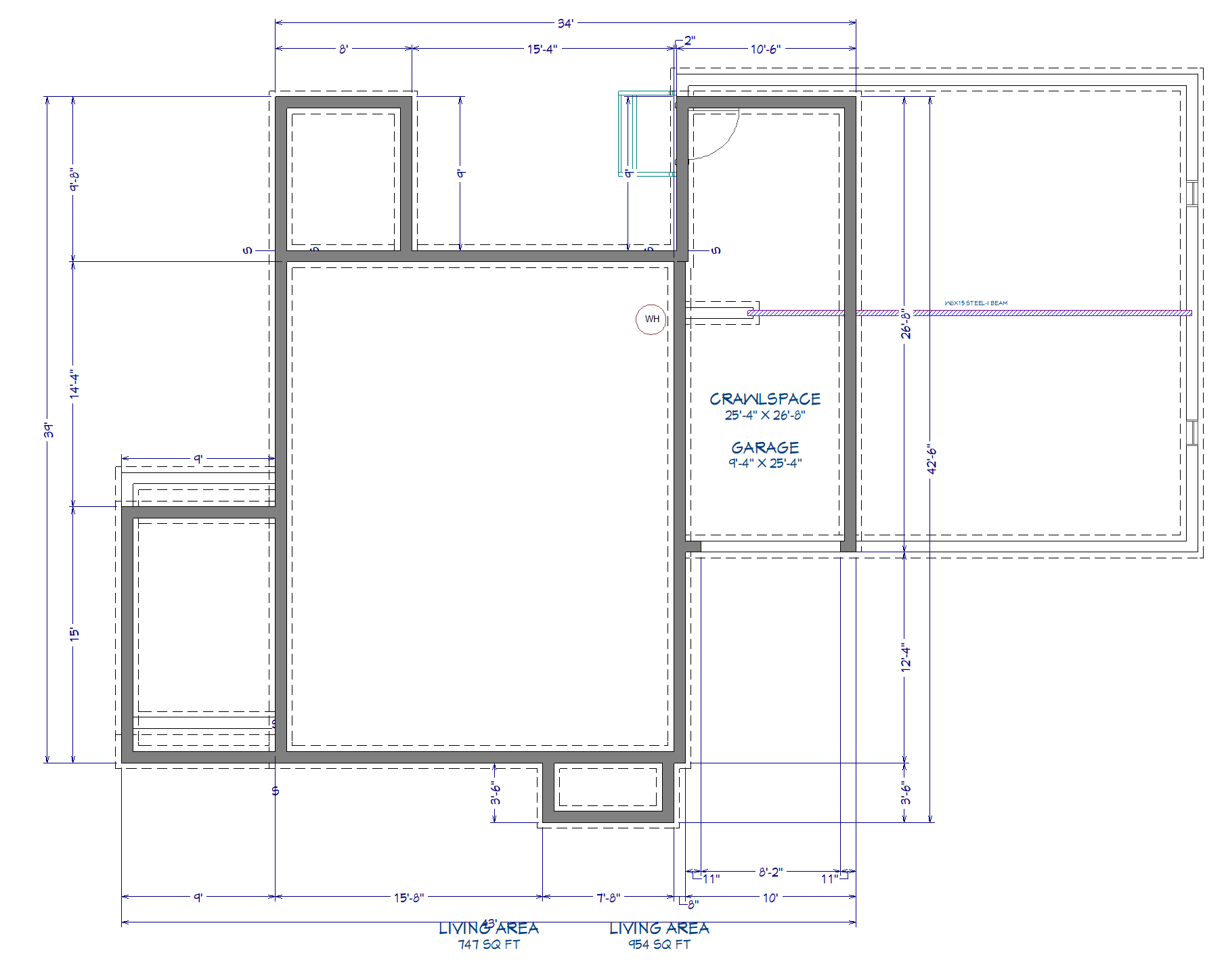

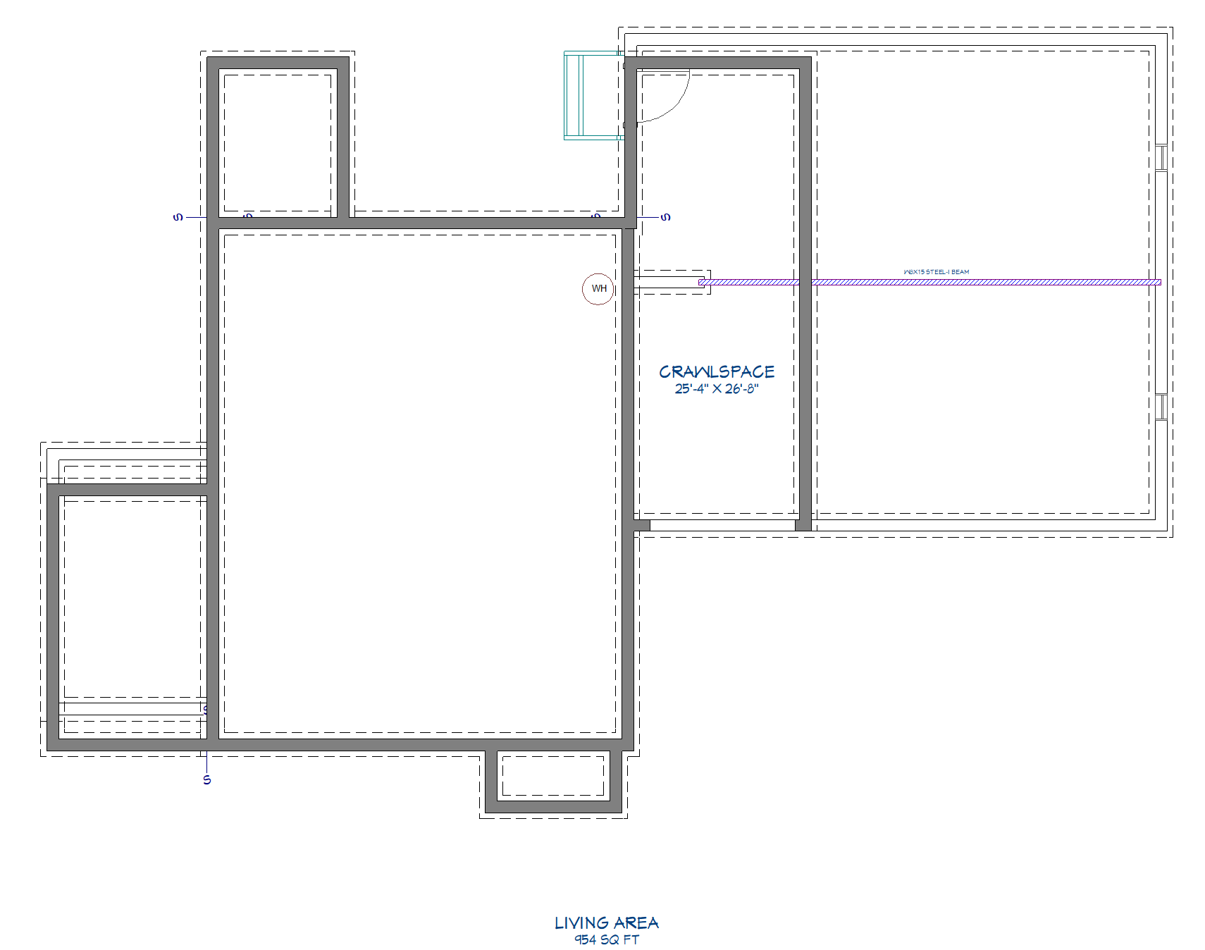

Here's an example that was done in reverse.  Here's the Plan 0 foundation.

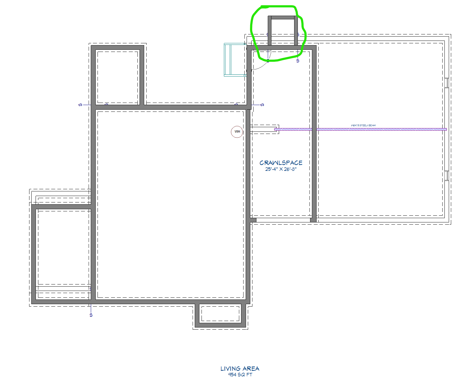

Here's Plan 2 option client chose

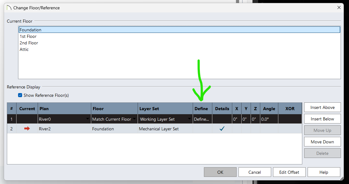

Inside Plan 2 I have already referenced Plan 0 within it.  Here's what happens when I turn reference layers on in plan view.
  Damn, I need those dimensions on the reference layer turned off. Lets redefine the reference layer (Plan0) to not show dimensions or room names.
Wait a second, there was a shed we forgot to show on Plan0 behind the garage.  Let's click over to Plan0 and add it.  And instantly look what happens to our view in Plan2

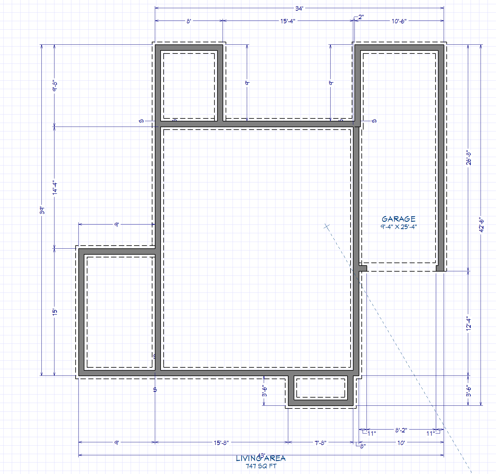

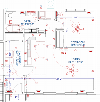

And before i forget,  Here's Plan 1 inside this addition.  Compared to Plan2 (with reference Plan0 turned off)
image.thumb.png.764c8e72631719cf5a3af362b42ac9c8.pngimage.thumb.png.661d9f3ecbba17e68a25d5d0e4fdedc0.png
I did this in reverse because I personally wanted to make sure I didn't place new foundation over any of the other old garage walls.  Then I waited until clients chose which option they want before refining the one they chose, ready for permitting.
Two options plus the as-built inside one plan file introduces several problems as other users previously noted.  Schedules, material lists, conflicting roof planes if you are showing two different room addition options.  Ceiling heights if one option is to open the ceiling to a loft above.  And there's an entire thread devoted to auto foundations.  Imagine this turned on with multiple upstairs options simultaneously present - or you start switching between them???  Lastly, you need to call out the reference plan separately, or twice, one in plan view and again in 3D view.  This is achievable today.
