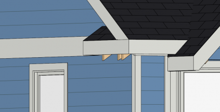

Hammer7 Posted March 24 Share Posted March 24 What is causing these rafter tails to poke through and how do I correct it? Link to comment Share on other sites More sharing options...
DBCooper Posted March 24 Share Posted March 24 Is your rafter depth is larger than the fascia? 1 Link to comment Share on other sites More sharing options...
DRAWZILLA Posted March 24 Share Posted March 24 (edited) If so, use an "opening no material" on a correctly sized soffit if you want the rafters to show. Edited March 24 by DRAWZILLA Link to comment Share on other sites More sharing options...
