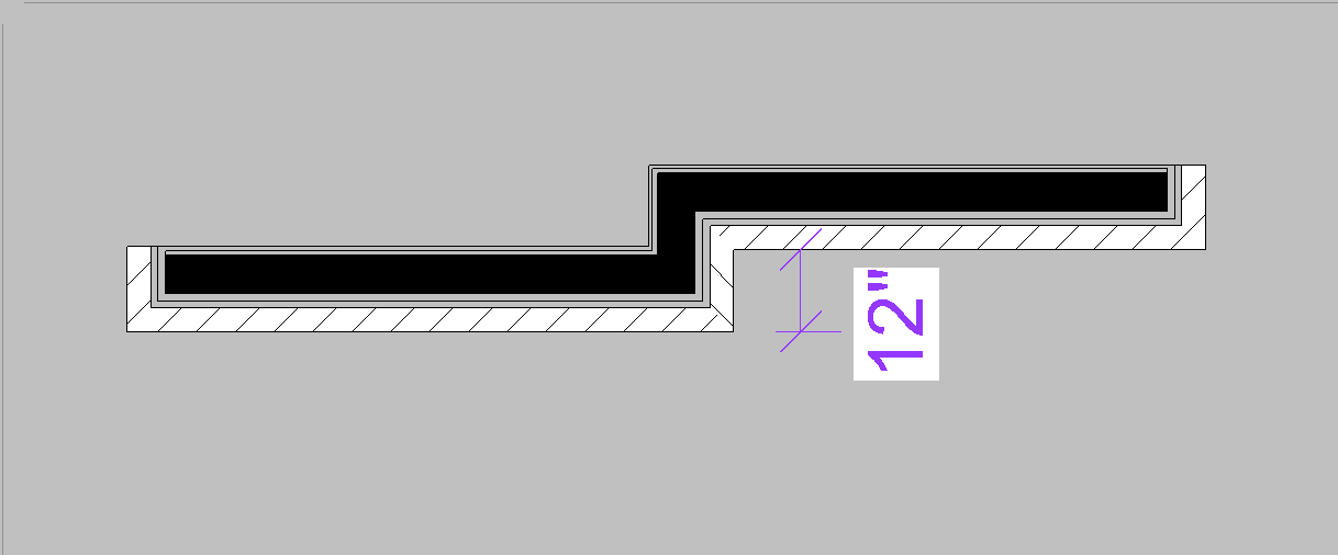

Michael_Gia Posted 2 hours ago Share Posted 2 hours ago Situations like the one below are a problem in Chief. Sometimes they will disconnect randomly or move and resnap arbitrarily. Dimensions will un-attach randomly no matter how many times you reconnect them etc... I usually "solve" this by creating a thinner version of the wall which seems to work most of the time, but Chief still behaves weirdly around small offsets. What do you guys do? Link to comment Share on other sites More sharing options...

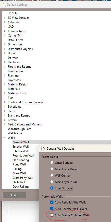

Renerabbitt Posted 1 hour ago Share Posted 1 hour ago This will help in some instances Link to comment Share on other sites More sharing options...
