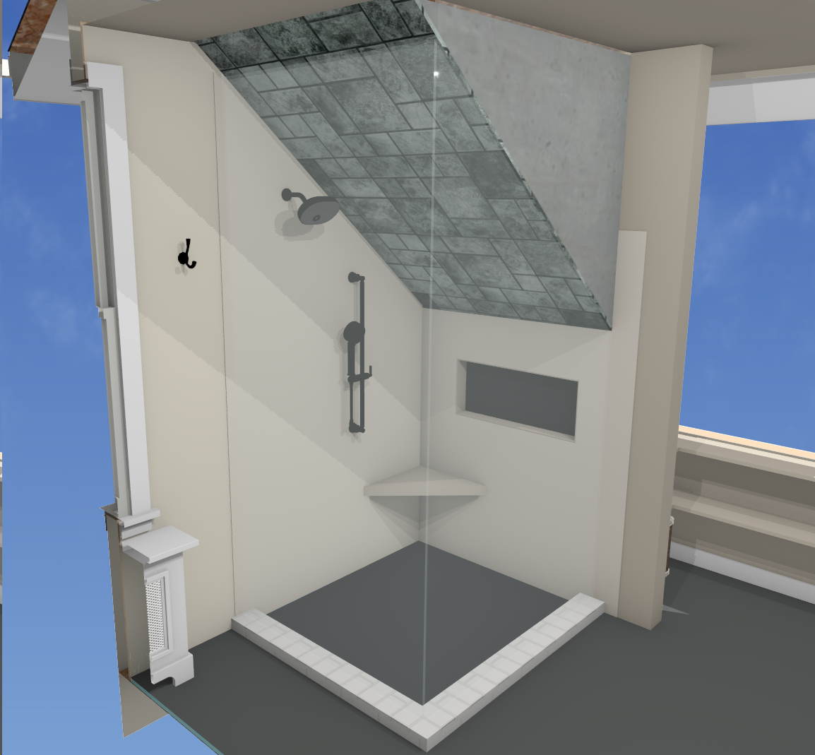

KBEDesign Posted March 10 Share Posted March 10 I am working on a bathroom rendering that has a sloped shower in which the ceiling will be tiled. In order to create the slope, I used a ceiling plane. When I tile it, it tiles the whole plane instead of just the shower section. Is there a way to specify where you want the material, similar to wall/floor material region but on the ceiling? Pic for reference. Link to comment Share on other sites More sharing options...
robdyck Posted March 10 Share Posted March 10 You could use a separate ceiling plane just for the tile finish or use a 3d solid. Link to comment Share on other sites More sharing options...
PitMan71 Posted March 10 Share Posted March 10 Create a room for the shower and change the ceiling finish. 1 Link to comment Share on other sites More sharing options...
KBEDesign Posted March 11 Author Share Posted March 11 Thank you for the suggestions! I've tried them all but man I am really struggling! I am a fairly new chief user and the sloped ceilings are really challenging for me. If I posted my plan file would anyone be willing to help me out and show me what I'm missing? Link to comment Share on other sites More sharing options...
Renerabbitt Posted March 11 Share Posted March 11 1 hour ago, KBEDesign said: Thank you for the suggestions! I've tried them all but man I am really struggling! I am a fairly new chief user and the sloped ceilings are really challenging for me. If I posted my plan file would anyone be willing to help me out and show me what I'm missing? Post it Link to comment Share on other sites More sharing options...
KBEDesign Posted March 11 Author Share Posted March 11 38 minutes ago, Renerabbitt said: Post it Don't judge lol, I'm new and I only use chief so far for visuals, not for technical drawings, installation, etc. so we don't draw the whole house, floors etc. Hope to get there eventually! Rendering Plan.zip Link to comment Share on other sites More sharing options...

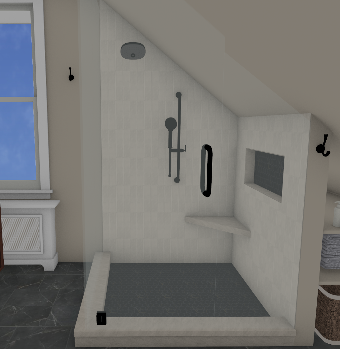

MarkMc Posted March 11 Share Posted March 11 This is in X17, add version and hardware to your signature please. In short used pony walls for shower enclosure so makes a room. Draw ceiling plan, manipulate the slope and locate where you want it. Easier if you give it a fill with no background. Filled in the side wall with a solid, also has a fill. Not exactly clear what you are after from the two pics you posted since don't exactly match each other. Tile.zip Link to comment Share on other sites More sharing options...
KBEDesign Posted March 12 Author Share Posted March 12 Thank you SO much Mark! This worked perfectly. I have X17 as well, sorry will add to my signature. I appreciate the help!!!! Link to comment Share on other sites More sharing options...
