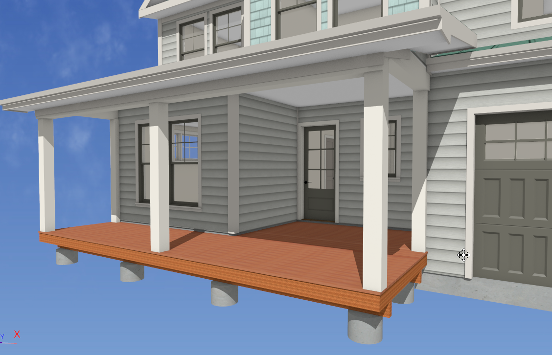

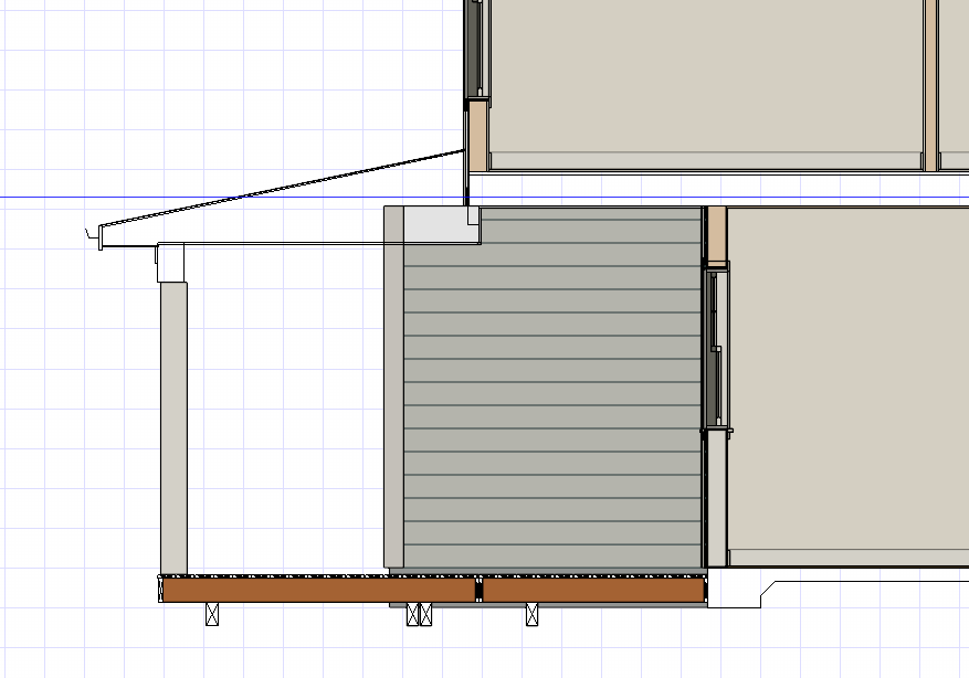

GeneDavis Posted March 3 Share Posted March 3 I've an upstairs room that is half over a porch and the porch needs a lower ceiling than the adjacent inside room on floor one. Do I need to divide the upstairs room so as to have a ceiling below with the air gap layer I need to lower the ceiling? I already divided the porch deck into that which is under the floor of the room above and that which has only roof over. Link to comment Share on other sites More sharing options...
Chrisb222 Posted March 3 Share Posted March 3 For the 3D I would just toss a ceiling plane and move on. If you want to show a cross section with framing or other, detail it out in CAD. Sometimes trying to bludgeon the parametric features into special situations just ain't worth all the squeezin. 1 Link to comment Share on other sites More sharing options...

SNestor Posted March 3 Share Posted March 3 I agree with the others that posted... However, you could just make the porch room "no ceiling"...and use a ceiling plane to create the porch room ceiling. Place the ceiling plane at the elevation you want it to be...and set it to have a zero pitch. Link to comment Share on other sites More sharing options...
