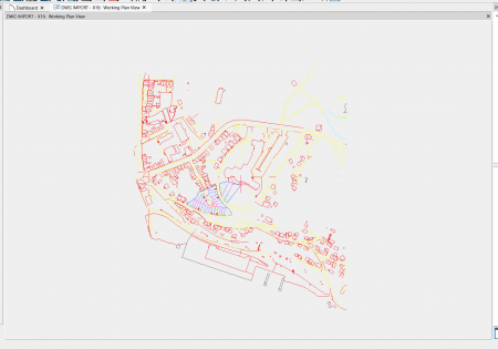

decorators3 Posted February 9 Share Posted February 9 (edited) Hi I know I’ve mentioned this before, but now that I have the DWG files, I just want to make sure I’m understanding what I’m seeing as I work through this. I’ve attached the site plan along with the DWG view on my end. In the file, I’m seeing two terrain outlines—one for the full area and another just for the new development. I’m not seeing any perimeter measurements, and I’m also not seeing any house blocks or building footprints, which I thought might be there. When I open the Architectural block, I can see the lines, but there are no measurements showing for scaling. I also can’t seem to change the CAD lines into a terrain perimeter. I’ve also attached sample image of the layer blocks so you can see what’s coming through in the DWG file on my end. Just wanted to check if this is normal at this stage, or if those pieces usually come through in a separate file. Thanks appreciate your assistance new site plan.pdf Edited February 14 by decorators3 have received DWG contours Link to comment Share on other sites More sharing options...
mtldesigns Posted February 9 Share Posted February 9 @decorators3 I really couldn't tell by the screen shot of the cad line being that I couldn't zoom up on it. But it looks like it had magenta and cyan lines.. representing your project lot lines and buildings, correct? Were you able to measure these and compare the dimensions to the pdf? This looks like a model space drawing to me, where the views in paper space would be scaled and that is where dims and text are placed. I always draw 1 to 1, but I've noticed some survey groups don't when I received there cad files. This is where you do a few distances measurements in the CAD file, then see how it compares to the pdf. You might have to scale the CAD file up I don't mind looking at it for you and give you my $0.05. Link to comment Share on other sites More sharing options...
decorators3 Posted February 10 Author Share Posted February 10 2 hours ago, mtldesigns said: @decorators3 I really couldn't tell by the screen shot of the cad line being that I couldn't zoom up on it. But it looks like it had magenta and cyan lines.. representing your project lot lines and buildings, correct? yes Were you able to measure these and compare the dimensions to the pdf? no wasn't sure how to go about it This looks like a model space drawing to me, where the views in paper space would be scaled and that is where dims and text are placed. I always draw 1 to 1, but I've noticed some survey groups don't when I received there cad files. This is where you do a few distances measurements in the CAD file, then see how it compares to the pdf. You might have to scale the CAD file up this is my first DWG file,, no contours just flat I don't mind looking at it for you and give you my $0.05. I would appreciate it how do I send it to you Link to comment Share on other sites More sharing options...

decorators3 Posted February 10 Author Share Posted February 10 10 hours ago, decorators3 said: thanks ACAD-25221-PR1-RevC (3).dwg 782.11 kB · 7 downloads I already have the house plans, so my understanding was that with the terrain perimeter I’d be able to build the houses and lay out the cul-de-sac, driveways, and related site elements. I’ve been reading and watching tutorials on DWG files, but I feel like I’m missing something. When I import the file, I don’t see any blocks—only linework—and I’m not sure if that’s expected or if I’m missing a step. It may simply be part of the learning curve. I’d appreciate any feedback or direction, as I want to make sure the client gets what they’re looking for. Thanks in advance. Link to comment Share on other sites More sharing options...
decorators3 Posted February 10 Author Share Posted February 10 12 hours ago, JKEdmo said: Post the DWG and I can take a look at it. Jim I already have the house plans, so my understanding was that with the terrain perimeter I’d be able to build the houses and lay out the cul-de-sac, driveways, and related site elements. I’ve been reading and watching tutorials on DWG files, but I feel like I’m missing something. When I import the file, I don’t see any blocks—only linework—and I’m not sure if that’s expected or if I’m missing a step. It may simply be part of the learning curve. I’d appreciate any feedback or direction, as I want to make sure the client gets what they’re looking for. Thanks in advance. ACAD-25221-PR1-RevC (3).dwg new site plan.pdf Link to comment Share on other sites More sharing options...

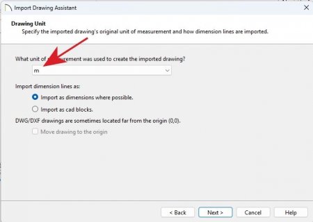

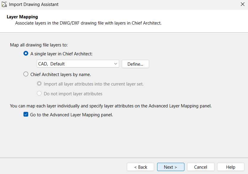

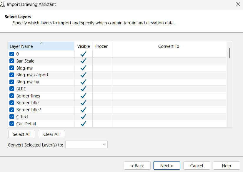

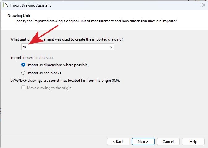

rlackore Posted February 10 Share Posted February 10 15 hours ago, decorators3 said: Hi I know I’ve mentioned this before, but now that I have the DWG files, I just want to make sure I’m understanding what I’m seeing as I work through this. I’ve attached the site plan along with the DWG view on my end. In the file, I’m seeing two terrain outlines—one for the full area and another just for the new development. I’m not seeing any perimeter measurements, and I’m also not seeing any house blocks or building footprints, which I thought might be there. When I open the Architectural block, I can see the lines, but there are no measurements showing for scaling. I also can’t seem to change the CAD lines into a terrain perimeter. I’ve also attached sample image of the layer blocks so you can see what’s coming through in the DWG file on my end. Just wanted to check if this is normal at this stage, or if those pieces usually come through in a separate file. The DWG file you posted doesn't contain any dimensions or text; at a glance it appears that all of the geometry shown in the PDF is present in the DWG, including lot lines, building footprints, etc. Use the Import Assistant to import the DWG and select Drawing Unit as "m" (meters) when you get to the Drawing Unit tab during the import process - the scale will be correct regardless of the units your plan file is using. To change any polyline into a Terrain Perimeter it must be "closed" - I had no problem converting the imported CAD lines into a Terrain Perimeter after I joined them to create a "closed" polyline. If you imported the DWG into a CAD Detail, then the Convert Polyline tool won't be available. Link to comment Share on other sites More sharing options...

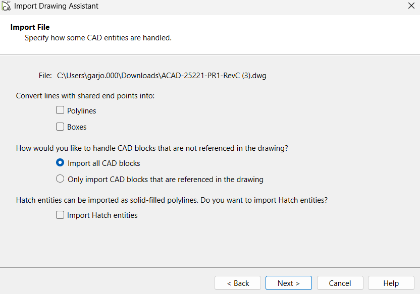

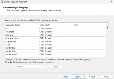

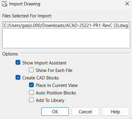

decorators3 Posted February 10 Author Share Posted February 10 2 minutes ago, rlackore said: The DWG file you posted doesn't contain any dimensions or text; at a glance it appears that all of the geometry shown in the PDF is present in the DWG, including lot lines, building footprints, etc. Use the Import Assistant to import the DWG and select Drawing Unit as "m" (meters) when you get to the Drawing Unit tab during the import process - the scale will be correct regardless of the units your plan file is using. To change any polyline into a Terrain Perimeter it must be "closed" - I had no problem converting the imported CAD lines into a Terrain Perimeter after I joined them to create a "closed" polyline. If you imported the DWG into a CAD Detail, then the Convert Polyline tool won't be available. that great info thanks ill try that now Link to comment Share on other sites More sharing options...
decorators3 Posted February 10 Author Share Posted February 10 50 minutes ago, decorators3 said: that great info thanks ill try that now 54 minutes ago, rlackore said: The DWG file you posted doesn't contain any dimensions or text; at a glance it appears that all of the geometry shown in the PDF is present in the DWG, including lot lines, building footprints, etc. Use the Import Assistant to import the DWG and select Drawing Unit as "m" (meters) when you get to the Drawing Unit tab during the import process - the scale will be correct regardless of the units your plan file is using. To change any polyline into a Terrain Perimeter it must be "closed" - I had no problem converting the imported CAD lines into a Terrain Perimeter after I joined them to create a "closed" polyline. If you imported the DWG into a CAD Detail, then the Convert Polyline tool won't be available. I really appreciate you taking the time to help me with importing the DWG to obtain dimensions, and I’m sorry to ask again. I’m still not fully understanding the process. I’ve attached the steps I’m following based on your response, but I’m not sure which boxes should be selected. Link to comment Share on other sites More sharing options...
decorators3 Posted February 10 Author Share Posted February 10 1 hour ago, rlackore said: The DWG file you posted doesn't contain any dimensions or text; at a glance it appears that all of the geometry shown in the PDF is present in the DWG, including lot lines, building footprints, etc. Use the Import Assistant to import the DWG and select Drawing Unit as "m" (meters) when you get to the Drawing Unit tab during the import process - the scale will be correct regardless of the units your plan file is using. To change any polyline into a Terrain Perimeter it must be "closed" - I had no problem converting the imported CAD lines into a Terrain Perimeter after I joined them to create a "closed" polyline. If you imported the DWG into a CAD Detail, then the Convert Polyline tool won't be available. Ultimately, what I’m looking for is the perimeter defined by the two purple lines, so I can build the houses on the site as shown in the plans and develop the overall site vision, with the correct scale and orientation. Link to comment Share on other sites More sharing options...

JKEdmo Posted February 10 Share Posted February 10 25 minutes ago, decorators3 said: Ultimately, what I’m looking for is the perimeter defined by the two purple lines, so I can build the houses on the site as shown in the plans and develop the overall site vision, with the correct scale and orientation. I think you are in good hands with Robert. Follow his tips to get the hang of it. I did a quick import of your DWG into an X16 metric plan template with units set to meters. Attached is the .plan result. It appears to be scaled correctly. For example, the parking stalls measure out to be 3 meters in width exactly (same as Autocad file). DWG IMPORT - X16.zip Link to comment Share on other sites More sharing options...
Solution decorators3 Posted February 10 Author Solution Share Posted February 10 53 minutes ago, JKEdmo said: I think you are in good hands with Robert. Follow his tips to get the hang of it. I did a quick import of your DWG into an X16 metric plan template with units set to meters. Attached is the .plan result. It appears to be scaled correctly. For example, the parking stalls measure out to be 3 meters in width exactly (same as Autocad file). DWG IMPORT - X16.zip 1.99 MB · 4 downloads thanks I don't work in metric is it difficult to change it to imperial if it's not imported that way Link to comment Share on other sites More sharing options...

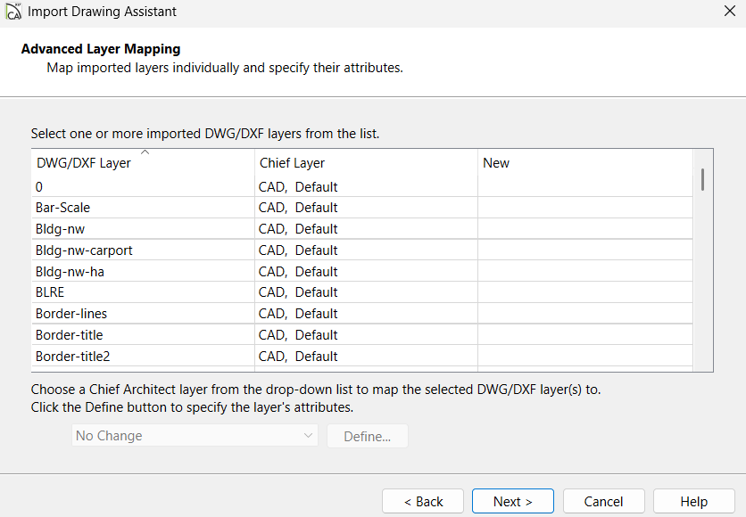

decorators3 Posted February 10 Author Share Posted February 10 4 hours ago, rlackore said: The DWG file you posted doesn't contain any dimensions or text; at a glance it appears that all of the geometry shown in the PDF is present in the DWG, including lot lines, building footprints, etc. Use the Import Assistant to import the DWG and select Drawing Unit as "m" (meters) when you get to the Drawing Unit tab during the import process - the scale will be correct regardless of the units your plan file is using. To change any polyline into a Terrain Perimeter it must be "closed" - I had no problem converting the imported CAD lines into a Terrain Perimeter after I joined them to create a "closed" polyline. If you imported the DWG into a CAD Detail, then the Convert Polyline tool won't be available. 2 hours ago, rlackore said: Video Audio is a little weak, may have to turn up your volume. Thanks Robert I needed that visual.. I have it done !! Link to comment Share on other sites More sharing options...
decorators3 Posted February 10 Author Share Posted February 10 3 hours ago, rlackore said: Video Audio is a little weak, may have to turn up your volume. 3 hours ago, rlackore said: Video Audio is a little weak, may have to turn up your volume. 56 minutes ago, decorators3 said: Thanks Robert I needed that visual.. I have it done !! I thought I had it sorted, but it didn’t come in at the correct scale. I’ll give it another try — just to confirm, I’m outlining this in feet rather than metric. The video you uploaded was very helpful. Thanks again. Link to comment Share on other sites More sharing options...
rlackore Posted February 10 Share Posted February 10 It doesn't matter what units your plan file is using (imperial or metric) - the important thing is that during the import process you select meters (m) as the Drawing Unit for the imported drawing. Link to comment Share on other sites More sharing options...
decorators3 Posted February 11 Author Share Posted February 11 3 hours ago, rlackore said: It doesn't matter what units your plan file is using (imperial or metric) - the important thing is that during the import process you select meters (m) as the Drawing Unit for the imported drawing. ok that's where I went wrong thank you Link to comment Share on other sites More sharing options...

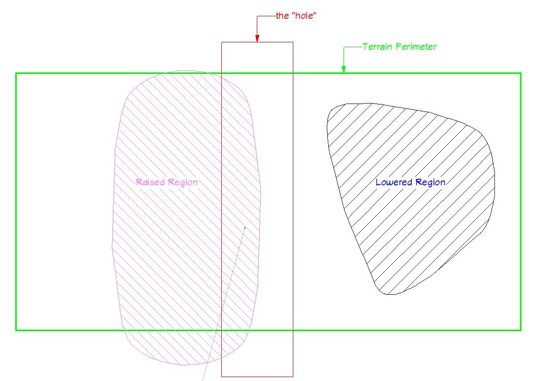

decorators3 Posted February 11 Author Share Posted February 11 1 minute ago, decorators3 said: ok that's where I went wrong thank you also how do i get the smaller purple area to configure as terrain perimeter.. it is faded when I try to convert the polyline to terrain perimiter. does that mean there can only be one terrain periminter on one plan Link to comment Share on other sites More sharing options...
mtldesigns Posted February 11 Share Posted February 11 I am glad these fellas are helping you... I 've been away ALL day.. then to see this is metric, not a pro at that. I blame 39. :-) Link to comment Share on other sites More sharing options...

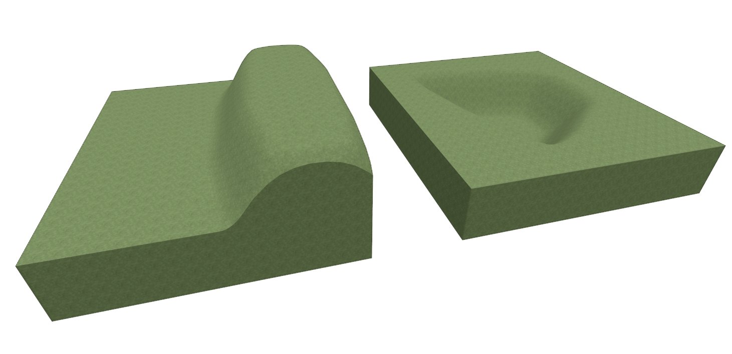

rlackore Posted February 11 Share Posted February 11 13 hours ago, decorators3 said: also how do i get the smaller purple area to configure as terrain perimeter.. it is faded when I try to convert the polyline to terrain perimiter. does that mean there can only be one terrain periminter on one plan Yes, only 1 Terrain Perimeter per plan. If you need to show two "separate" terrain areas, you can draw a Terrain Feature, check the box Terrain Feature Specification>General>Make Hole, and for visual purposes only you've got two terrains: 1 Link to comment Share on other sites More sharing options...
decorators3 Posted February 11 Author Share Posted February 11 7 hours ago, rlackore said: Yes, only 1 Terrain Perimeter per plan. If you need to show two "separate" terrain areas, you can draw a Terrain Feature, check the box Terrain Feature Specification>General>Make Hole, and for visual purposes only you've got two terrains: THANKS FOR YOUR HELP REALLY APPRECIATED Link to comment Share on other sites More sharing options...

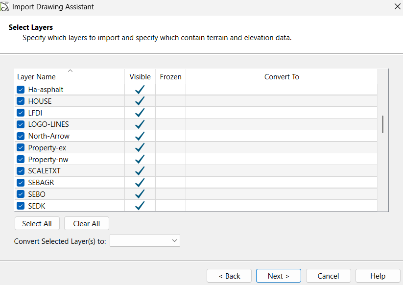

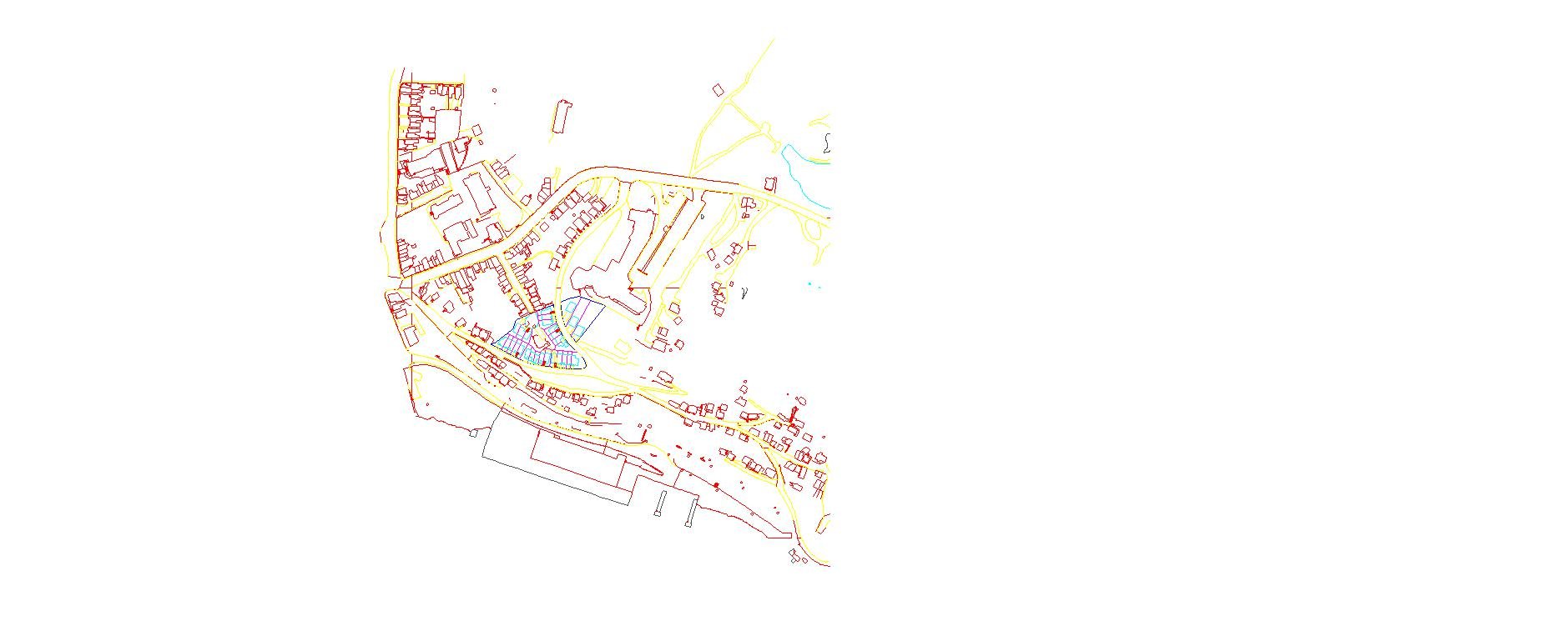

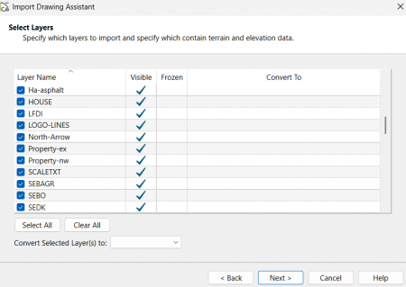

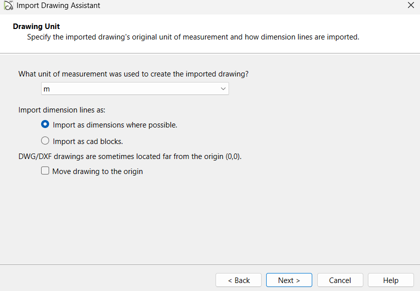

decorators3 Posted February 12 Author Share Posted February 12 As a follow-up, I’ll be receiving the topo survey CAD from the surveyor for this site plan you’ve all been helping me with. I’ll likely be reaching out again for guidance. This is a large project for me and my first time working with DWGs and topo files, so I truly appreciate all of your assistance. Link to comment Share on other sites More sharing options...
decorators3 Posted February 17 Author Share Posted February 17 On 2/10/2026 at 12:49 PM, rlackore said: Video Audio is a little weak, may have to turn up your volume. I keep referring to your video and its helped tremendously. you can read as much as you can but visuals are the most instructive way to learn . I was also able to import the contours DWG over the terrain DWG... its all a learning curve and you've been so helpful.. Again thank you Link to comment Share on other sites More sharing options...
