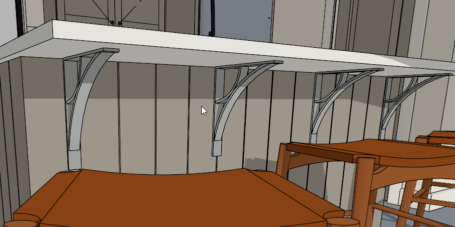

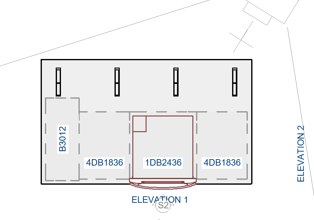

GeneDavis Posted January 31 Share Posted January 31 I used solids, blocked, to create the iron countertop brackets seen here. I want to display them in plan view using dashed lines, just as the under-counter base cabs and appliance display. See here. They are in their own layer, "Cabinets, countertops, brackets" and that layer is assigned dashed line. Since they are blocked, I changed the layer for Architectural Blocks to have the preferred line type and thickness. But none of this is producing the plan view I need. Link to comment Share on other sites More sharing options...
Solution Chrisb222 Posted January 31 Solution Share Posted January 31 49 minutes ago, GeneDavis said: I used solids, blocked, to create the iron countertop brackets seen here If they are simply blocked solids, they're probably still getting their line style info from the 3D Solids layer. Try changing it there. Or you could make them a symbol then the layer settings are more straightforward. Link to comment Share on other sites More sharing options...
GeneDavis Posted January 31 Author Share Posted January 31 Thanks, @Chrisb222. That was it. 1 Link to comment Share on other sites More sharing options...
