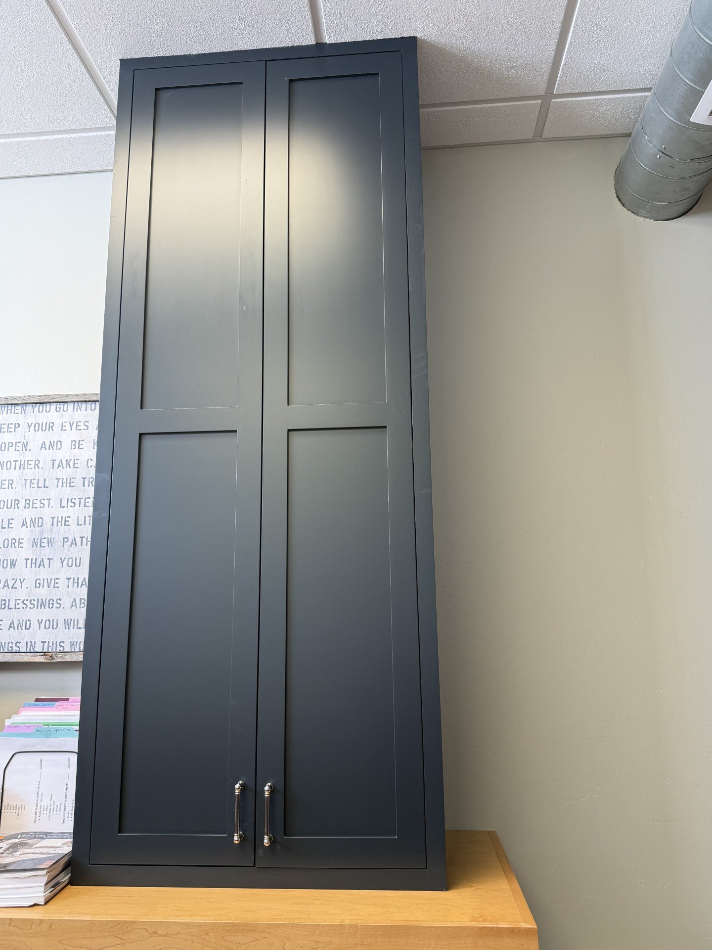

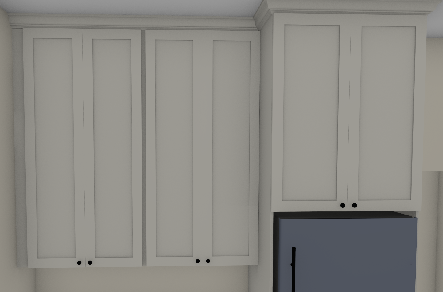

kjochman Posted January 26 Share Posted January 26 How do I add a mid rail to my tall cabinets? Below is a photo of the cabinets I'm trying to change, as well as what I'm tying to get it to look like. Thanks Link to comment Share on other sites More sharing options...
DBCooper Posted January 26 Share Posted January 26 (edited) The short answer is that you need to change the door style to use a different symbol. I did not see one in the core libraries but there might be one in either the manufacturer or bonus libraries. If you can't find one you like, that should be a very easy style to create yourself. Here is a video that might help: https://www.chiefarchitect.com/videos/watch/5532/creating-a-custom-cabinet-door.html Edited January 27 by DBCooper 1 Link to comment Share on other sites More sharing options...
GaryOhmer Posted January 27 Share Posted January 27 bonus library - cabinet doors no.1 - double panel Link to comment Share on other sites More sharing options...
GeneDavis Posted January 28 Share Posted January 28 I wanted a mid rail in a shaker style door for a tall cabinet, and specific placement, the rail not centered vertically. Took just a few minutes to make a group of 3D solids to emulate what I needed and convert to a door symbol. Link to comment Share on other sites More sharing options...
