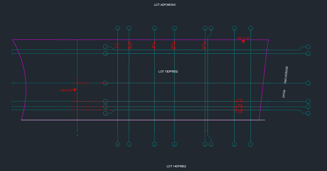

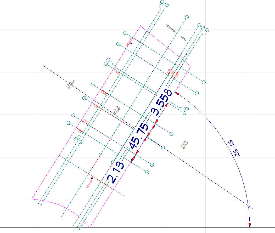

gelbuilding Posted January 21 Share Posted January 21 (edited) I’m currently trying to scale the drawing to 1:1, but I’m unable to get it working correctly. I also need to rotate the drawing back to 180 degrees. The text and arrow sizes are already set to 1. Any guidance would be greatly appreciated. UQ00776 SO 251121.dwg Edited January 21 by gelbuilding Link to comment Share on other sites More sharing options...

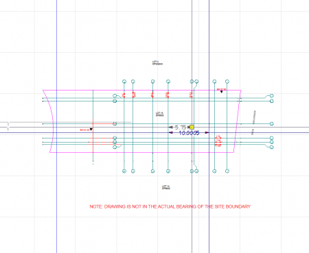

Doug_N Posted January 21 Share Posted January 21 957456986_UQ00776SO251121_dn.dwg 1 2 Link to comment Share on other sites More sharing options...
gelbuilding Posted January 21 Author Share Posted January 21 Thanks Doug, Any luck to see measurements? How to change to mm instead of 1.500mm i need 1500mm for example Link to comment Share on other sites More sharing options...
JiAngelo Posted January 21 Share Posted January 21 Import as meters. 1.5m=1500mm 1 Link to comment Share on other sites More sharing options...
Doug_N Posted January 21 Share Posted January 21 12 hours ago, gelbuilding said: Thanks Doug, Any luck to see measurements? How to change to mm instead of 1.500mm i need 1500mm for example Scale by 1000 Link to comment Share on other sites More sharing options...
