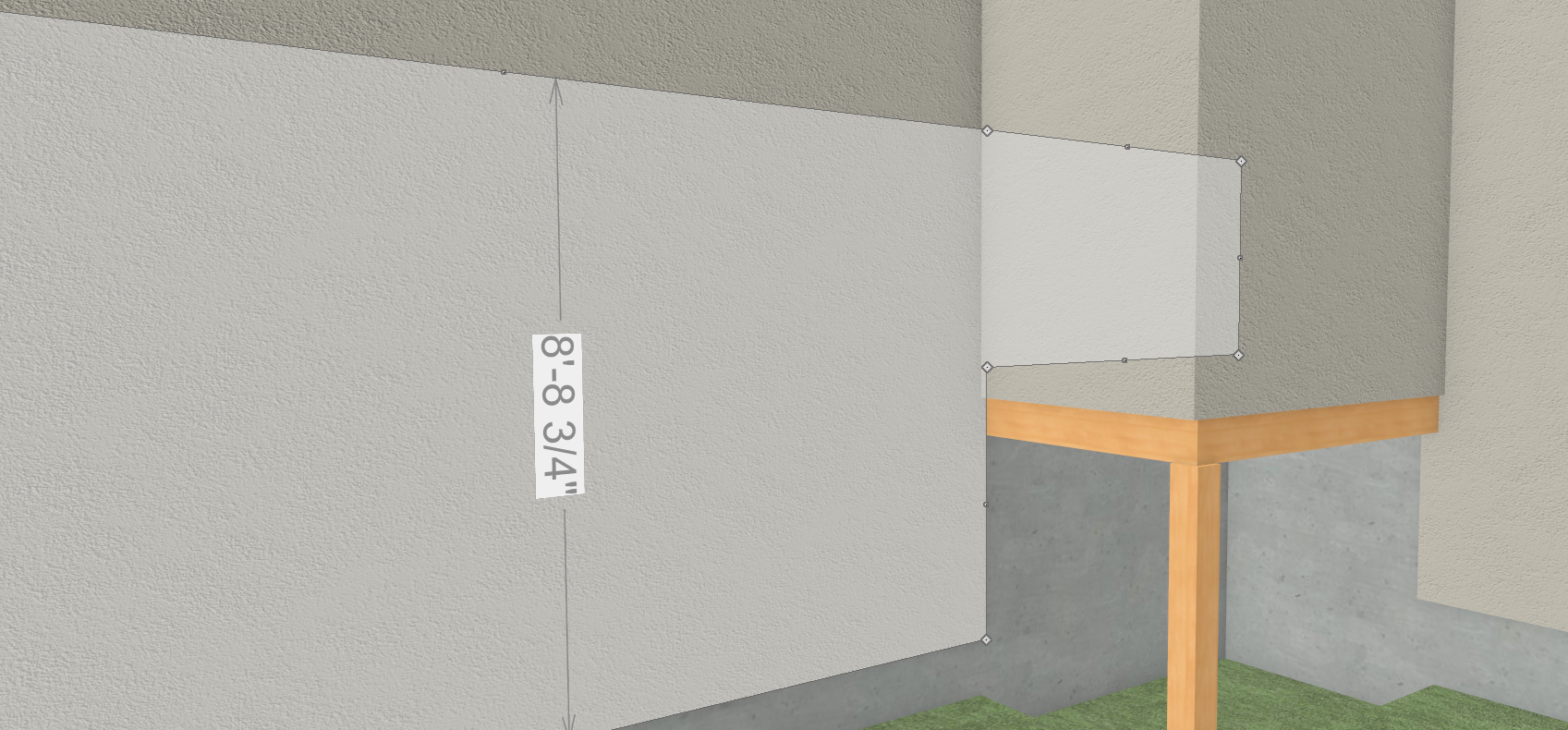

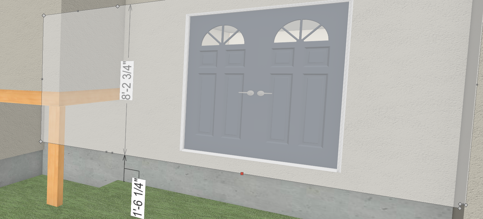

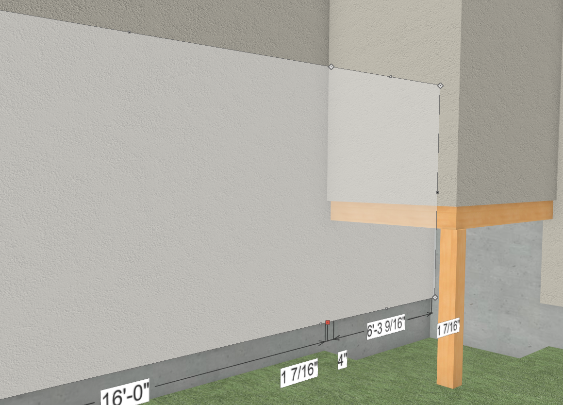

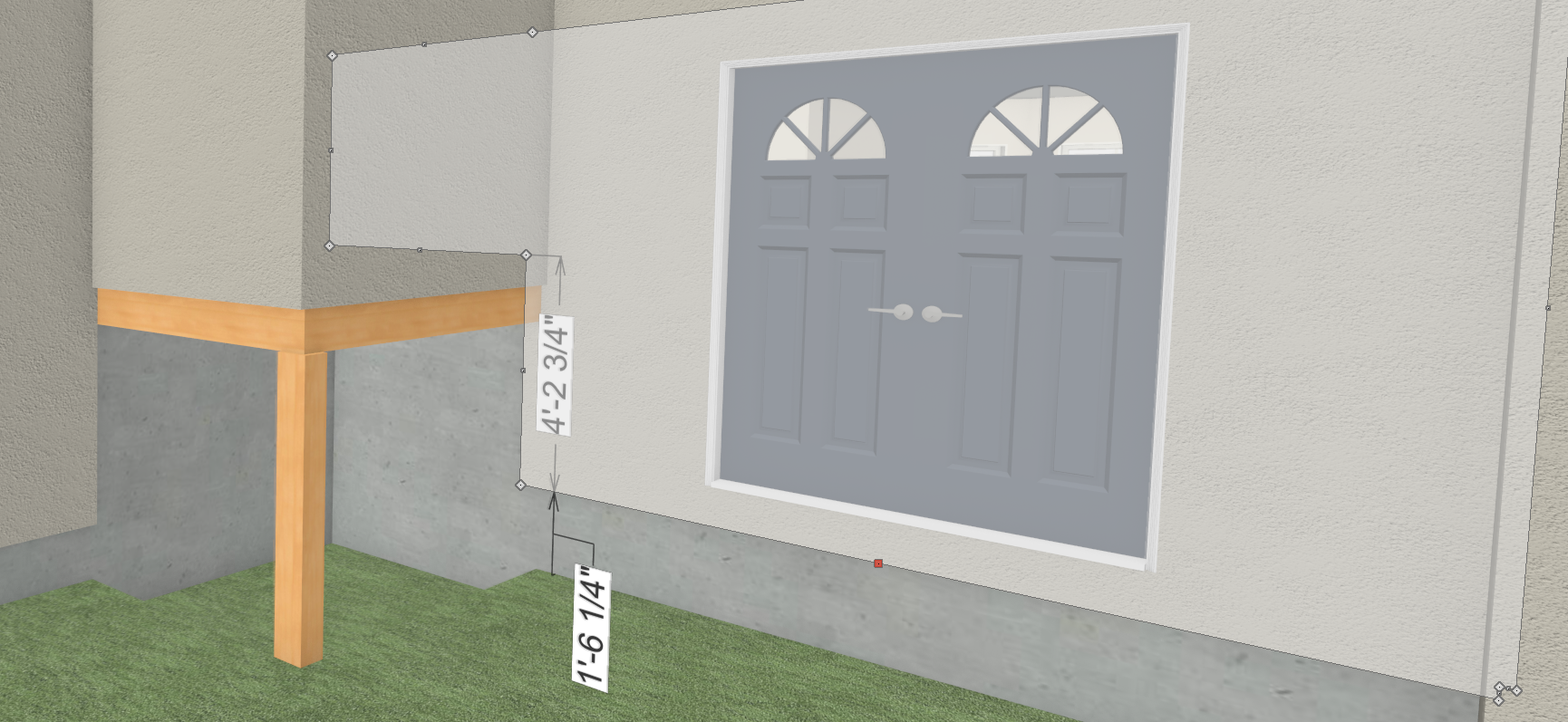

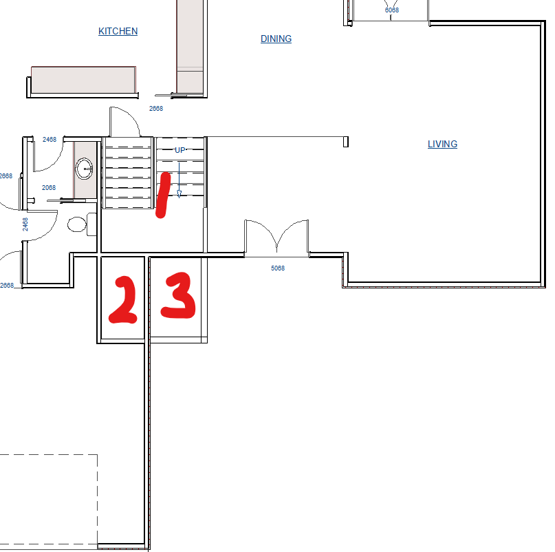

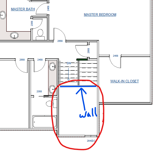

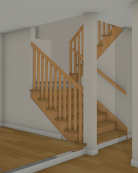

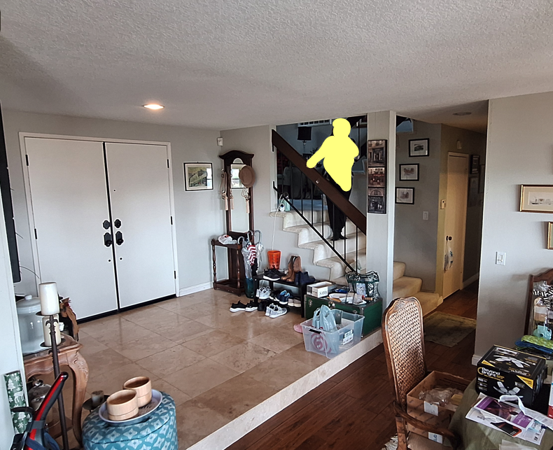

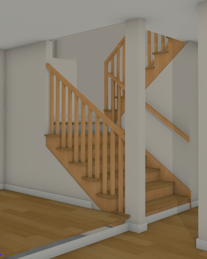

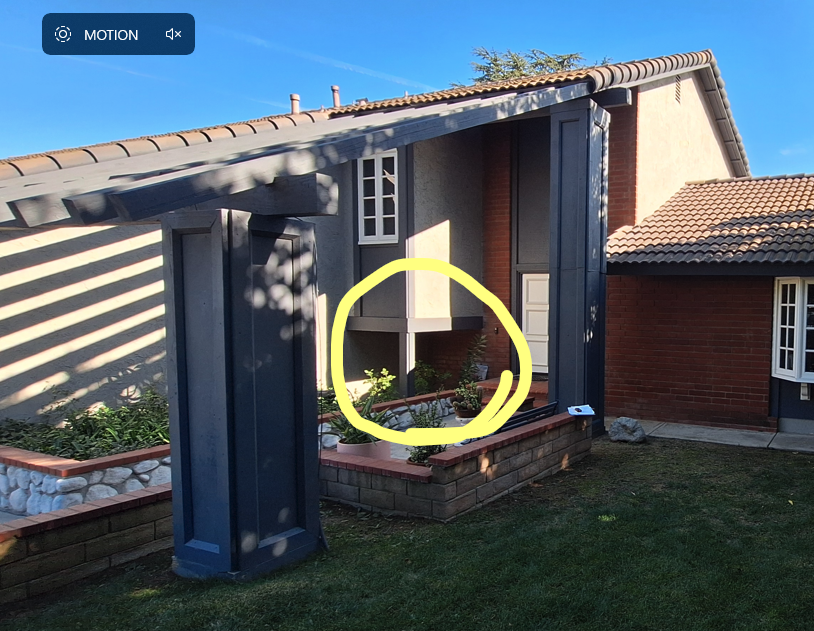

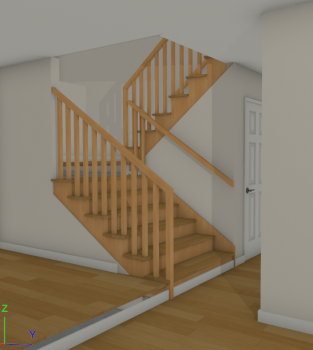

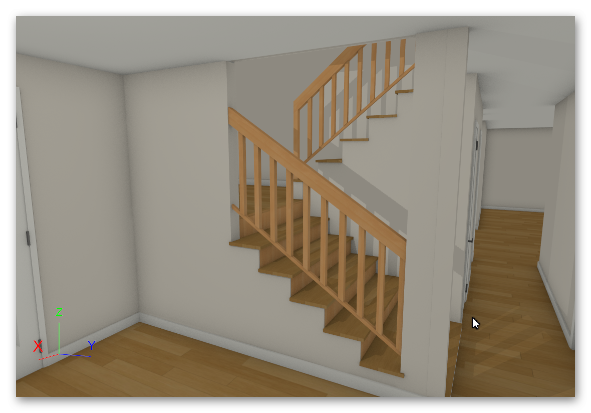

builtright3 Posted January 9 Share Posted January 9 Hey Guy's I'm trying to create this stairwell and these different elevations for it and I’m stuck. I can’t explain it so I’m sending some pictures and the plan is attached. Any help would be appreciated, that you.Stairwell Plan.zip Link to comment Share on other sites More sharing options...

Mark3D Posted January 11 Share Posted January 11 Have a look at this it might get you moving in the right direction maybe, i had to use some polyline solids and a sofit to make it look better witch maybe no good for working drawings. One more thing i don't think your landing is not the write height looking at photos New Plan.zip 1 Link to comment Share on other sites More sharing options...
Doug_N Posted January 11 Share Posted January 11 Is this close to what you are looking for? Or this? I don't understand where the problem lies with what you are trying to do. Nor do I understand what the problem is with the exterior view of the floor supported by a column in one corner. Could you talk about each area of problem? 1 Link to comment Share on other sites More sharing options...

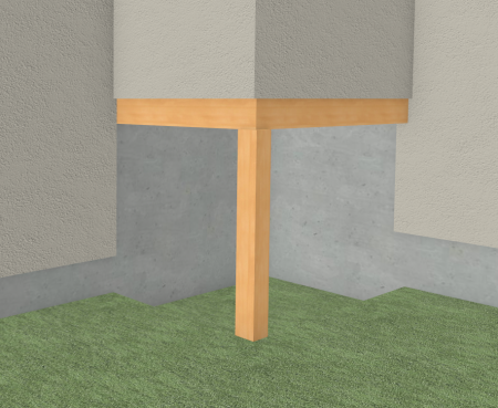

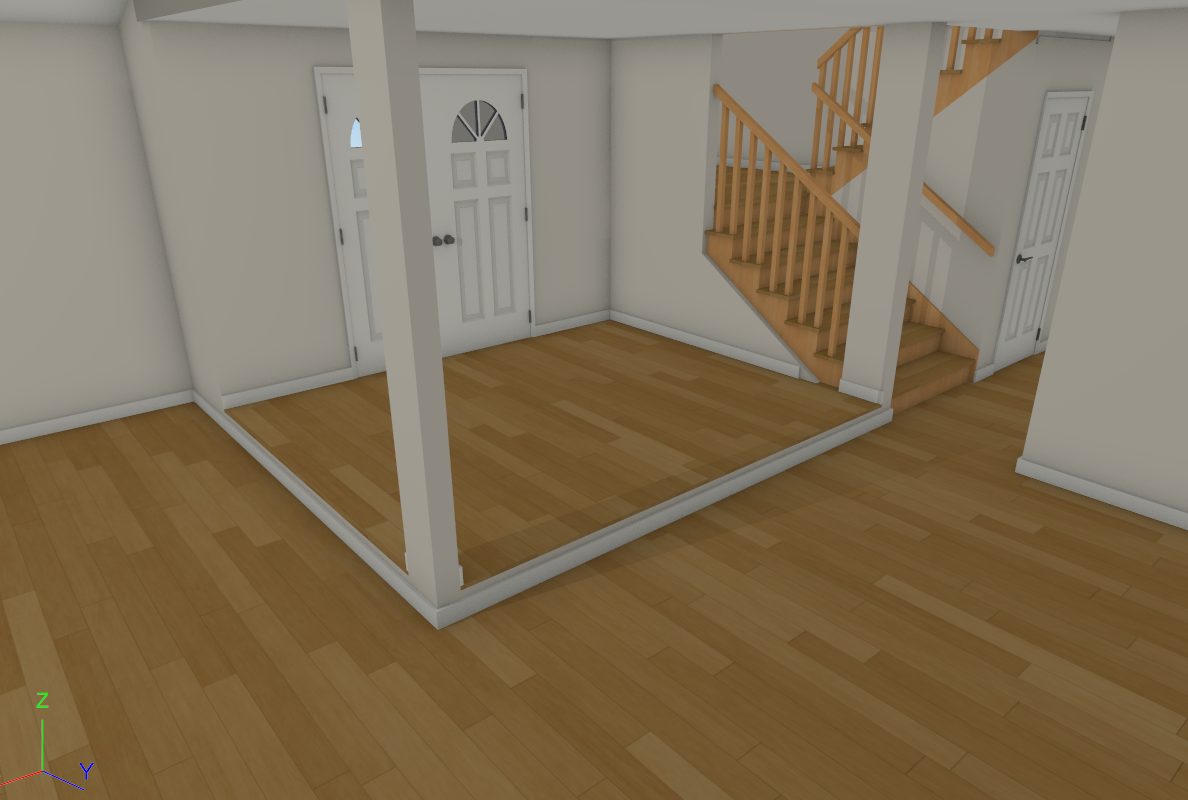

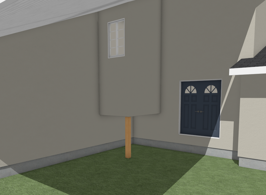

JiAngelo Posted January 11 Share Posted January 11 I don't agree with the choices you made, but I think I understand why. To address what you have drawn, first, I extended your basement walls to under the stairs. Changed those outside walls to pony walls with rail top to header and post only on the corner. Added a floor in that room with grass as the covering. Showing floor at -28" temporarily. Then I selected these two walls. And lower the bottom in the stairwell to match the rest of the wall. Then I went to your stairwell and lower the tops of the same wall portions inside the stairwell This eliminates those walls in the stairwell, placing them below the stairwell floor so that you can still see stucco outside. Your gaps between top of lower stair and landing, and the one between raised foyer floor and rest of home are due to how you chose to build the home. I personally would have built the stairwell shaft level with first floor w/ balloon walls and used a stair landing. Then dealt with that outside portion of the stairwell a little differently, but to achieve the same results. 1 Link to comment Share on other sites More sharing options...
builtright3 Posted January 11 Author Share Posted January 11 15 hours ago, Doug_N said: Your second photo is the correct one. Link to comment Share on other sites More sharing options...
builtright3 Posted January 11 Author Share Posted January 11 1 hour ago, JiAngelo said: There is no post. It’s a cantilever Link to comment Share on other sites More sharing options...
builtright3 Posted January 11 Author Share Posted January 11 15 hours ago, Mark3D said: Have a look at this it might get you moving in the right direction maybe, i had to use some polyline solids and a sofit to make it look better witch maybe no good for working drawings. One more thing i don't think your landing is not the write height looking at photos New Plan.zip 3.49 MB · 2 downloads I didnt use a landing. Maybe that was my first mistake Link to comment Share on other sites More sharing options...

JiAngelo Posted January 11 Share Posted January 11 36 minutes ago, builtright3 said: There is no post. It’s a cantilever 1. There's a post in the picture you provided. Remember that's when you couldn't explain it so you provided pictures to say it for you. 2. The code required backspan to cantilever span ratio is 2:1. This means you need 8' of joist inside the home to cantilever 4' (for example.) 3. Your cantilever ends have roof load additionally on them as well. Good luck. Link to comment Share on other sites More sharing options...
builtright3 Posted January 11 Author Share Posted January 11 4 hours ago, JiAngelo said: 1. There's a post in the picture you provided. Remember that's when you couldn't explain it so you provided pictures to say it for you. 2. The code required backspan to cantilever span ratio is 2:1. This means you need 8' of joist inside the home to cantilever 4' (for example.) 3. Your cantilever ends have roof load additionally on them as well. Good luck. I apologies, Your right. Thank you! Link to comment Share on other sites More sharing options...

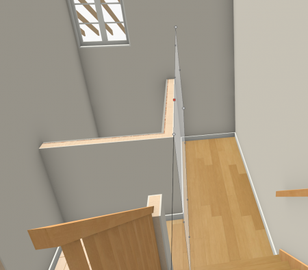

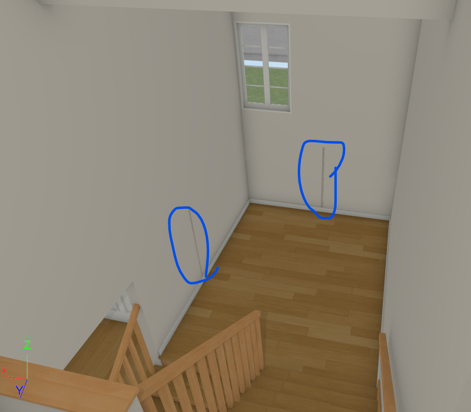

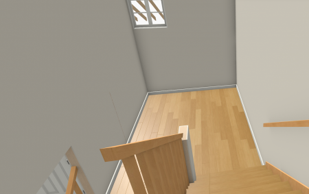

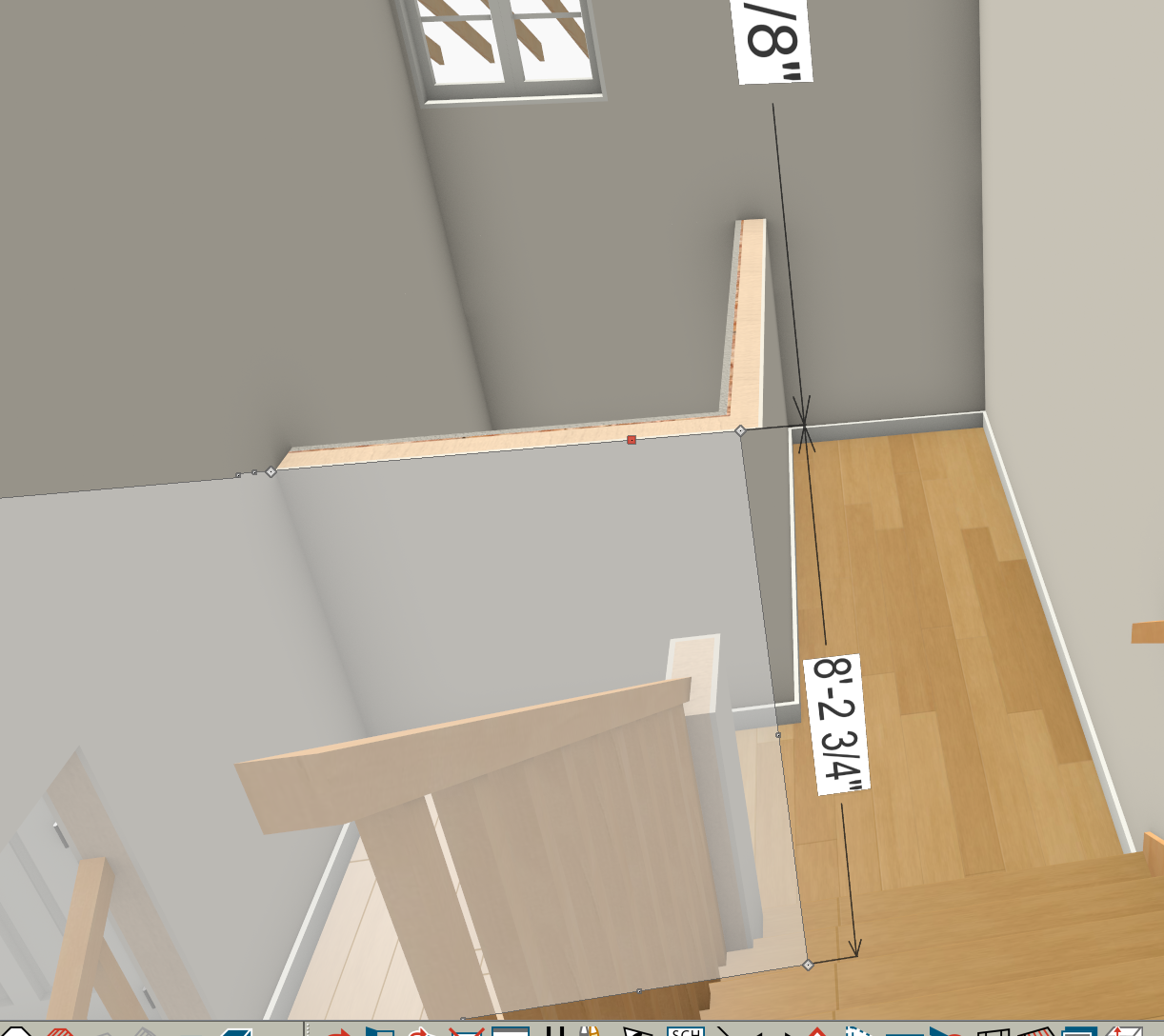

builtright3 Posted January 12 Author Share Posted January 12 (edited) Thanks for the help guy's, I got everyting to work the way I wanted it and its correct in the working drawings (which is a plus). I just have to trim everything out now and that is the easy part. On the inside I changed all the invisible walls to door openings and that seems to work better. Base molding by the stairs need work but is not important for this job. First floor these are three separate rooms. Number 3 being on the first floor helped with keeping the stucco to show on the outside On the second floor I put a wall here with a door opening instead of an invisible wall and so I was able to lower this down to the landing height There is a couple of gaps that need to be fixed on this one but again it wont matter for this job so I will leave it. Not sure whats casuing it. Edited January 12 by builtright3 1 Link to comment Share on other sites More sharing options...
