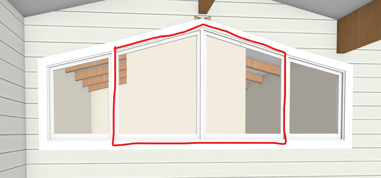

winterdd Posted December 5, 2025 Share Posted December 5, 2025 Hey guys, I asked this a while back but cannot find the thread. How can we shape windows like below in red without having to mull two windows. I need one window with that shape. Link to comment Share on other sites More sharing options...

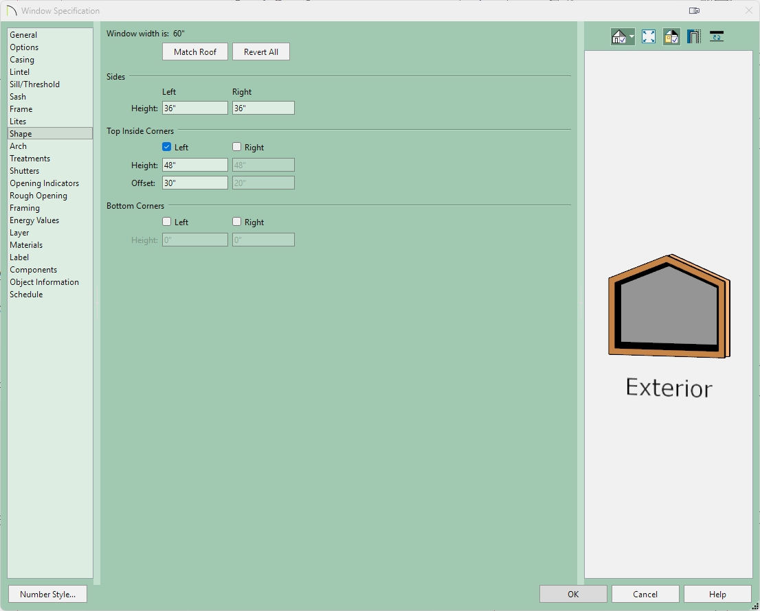

tundra_dweller Posted December 5, 2025 Share Posted December 5, 2025 Yeah you can either use the tudor arch method like in the thread Shane posted, or use the "Shape" section to put a peak in the middle by adjusting the top inside corner settings. 1 1 Link to comment Share on other sites More sharing options...
DRAWZILLA Posted December 5, 2025 Share Posted December 5, 2025 If you want it to look like the picture, you will need 4 windows mulled together with zero separation 1 Link to comment Share on other sites More sharing options...
winterdd Posted December 5, 2025 Author Share Posted December 5, 2025 Thanks guys, I did the "top inside corner" method and it looks great. 1 Link to comment Share on other sites More sharing options...
DBCooper Posted December 6, 2025 Share Posted December 6, 2025 I think the "triangle" arch works better for this than the "tudor" arch. 1 Link to comment Share on other sites More sharing options...
