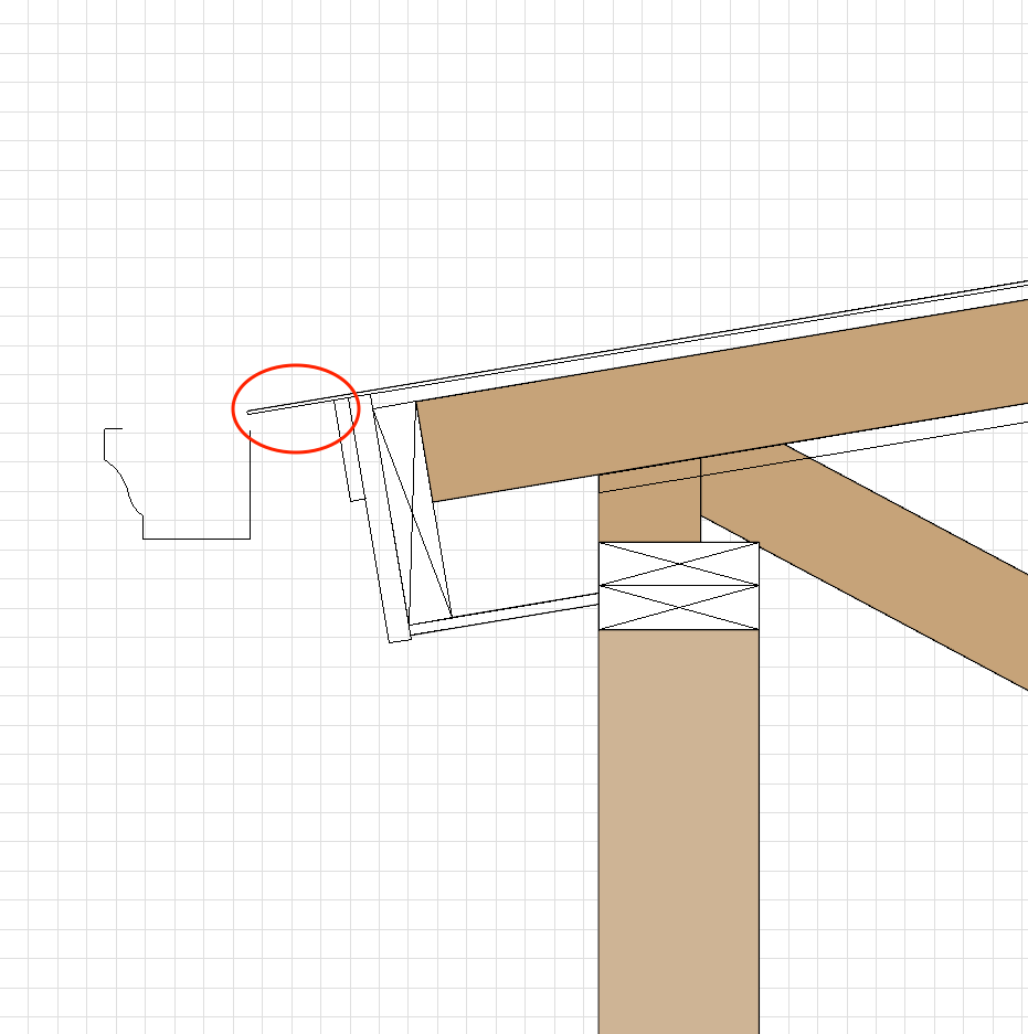

hyldahldesign Posted December 3, 2025 Share Posted December 3, 2025 For some reason, the surface of my roof is hanging past the fascia by 3.5" and I can't figure out why or how to fix it. I guess it's actually that the fascia and subfascia are stopping short of the end of the roof by 3.5" as it seems as though the roof surface is hanging past the baseline the correct amount. What setting do I need to fix to get the fascia to build in the proper spot so there isn't so much roof surface overhang? Link to comment Share on other sites More sharing options...

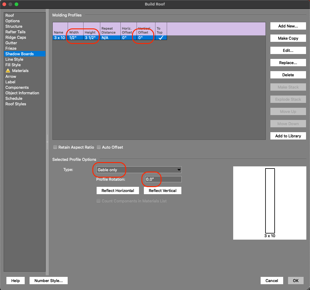

Solution Chrisb222 Posted December 4, 2025 Solution Share Posted December 4, 2025 19 minutes ago, hyldahldesign said: Hopefully this helps in diagnosing what the problem could be. Your Shadow Board settings are all bass-ackwards. They should be set like this (Gable Only is a preference, not required): Unfortunately I had to turn Auto Roofs back on to get it to correct the issue. Link to comment Share on other sites More sharing options...
hyldahldesign Posted December 4, 2025 Author Share Posted December 4, 2025 3 hours ago, Chrisb222 said: Your Shadow Board settings are all bass-ackwards. They should be set like this (Gable Only is a preference, not required): Unfortunately I had to turn Auto Roofs back on to get it to correct the issue. Oh my gosh, thank you! That solved it. I don't know that I ever would've figured that one out! Not sure how or why those shadow boards ended up so backwards. 1 Link to comment Share on other sites More sharing options...
