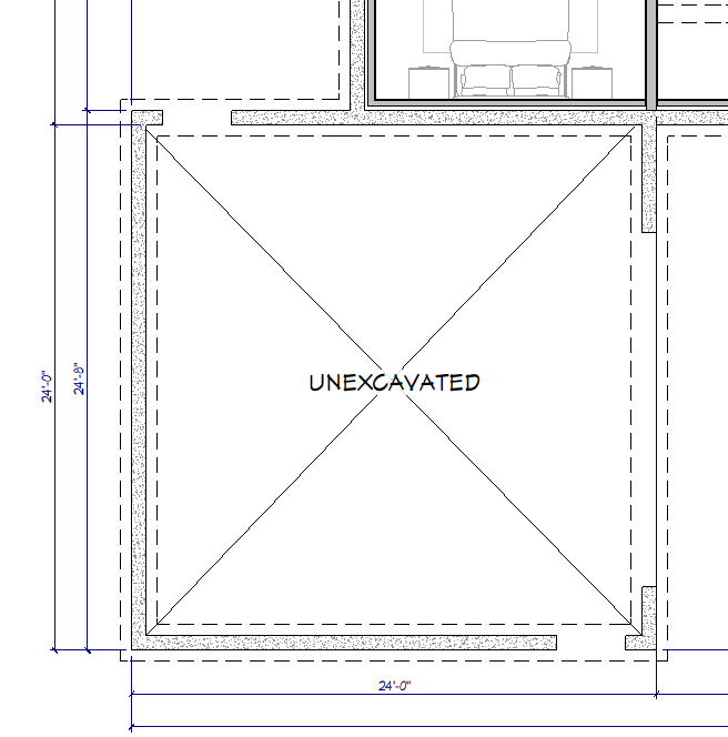

Ange822 Posted November 13, 2025 Share Posted November 13, 2025 Hi there, I would like to show a dashed line where the man door / overhead door openings are in the foundation plan. It used to default when I used X15 but since using X16 I can't seem to figure out how to show it. Thanks in advanced! Ange Link to comment Share on other sites More sharing options...

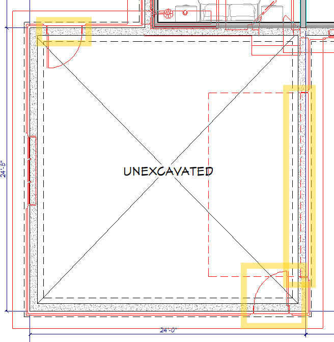

tundra_dweller Posted November 13, 2025 Share Posted November 13, 2025 7 minutes ago, Ange822 said: I wondered if it was a layer, I tried that and it didn't do anything Hmmm, it works for me, as long as I have it turned on in the referenced view of the floor above. With opening header lines turned on: With OHL turned off: Link to comment Share on other sites More sharing options...

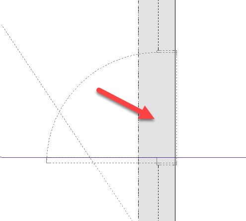

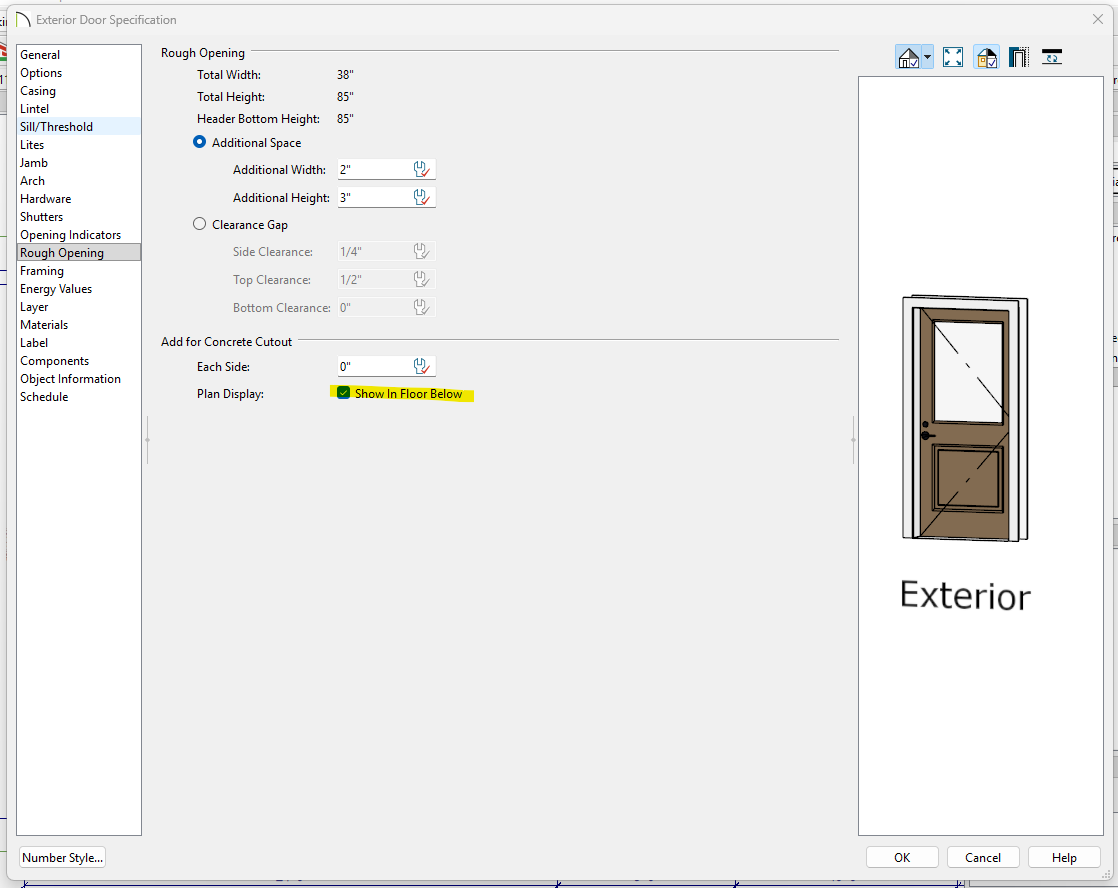

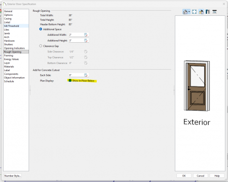

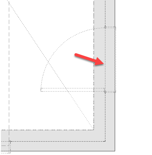

Solution DBCooper Posted November 13, 2025 Solution Share Posted November 13, 2025 Are your doors actually low enough to make a cutout in the foundation walls? If they are, then you should probably post your plan. Link to comment Share on other sites More sharing options...
tundra_dweller Posted November 13, 2025 Share Posted November 13, 2025 Yeah nevermind the opening header lines they won't help with cutting out the stem wall at openings. Just follow DBCooper's train of thought, as usual. Link to comment Share on other sites More sharing options...
Ange822 Posted November 13, 2025 Author Share Posted November 13, 2025 3 hours ago, DBCooper said: Are your doors actually low enough to make a cutout in the foundation walls? If they are, then you should probably post your plan. Thank you @DBCooper That worked! Thanks for your help too @tundra_dweller! 1 Link to comment Share on other sites More sharing options...
