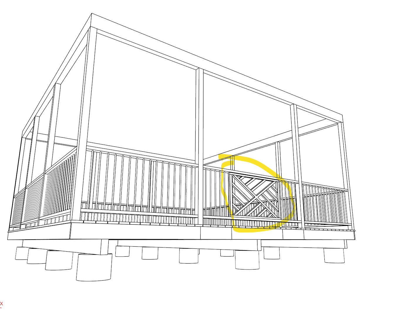

PitMan71 Posted October 20 Share Posted October 20 How do I create a railing like the attached picture with the balusters and panels and columns? I have some idea, but I don't want to reinvent methods that may already be available in chief. Thanks in advance. Link to comment Share on other sites More sharing options...
DBCooper Posted October 20 Share Posted October 20 Have you tried using "post to beam" with a library newel post? Link to comment Share on other sites More sharing options...
JKEdmo Posted October 20 Share Posted October 20 2 hours ago, PitMan71 said: How do I create a railing like the attached picture with the balusters and panels and columns? I have some idea, but I don't want to reinvent methods that may already be available in chief. Thanks in advance. For the intermediate "starburst" railing, I'd break the railing and switch to panel infill at that middle location. You'll need to relocate / delete adjacent columns/ posts as needed. Something like this: Link to comment Share on other sites More sharing options...
PitMan71 Posted October 20 Author Share Posted October 20 2 hours ago, DBCooper said: Have you tried using "post to beam" with a library newel post? Yes... That is what I used. It gets a bit harry when you break it though..... like I couldn't get rid of the columns created at the break. Maybe I just need to experiment more. Thanks Link to comment Share on other sites More sharing options...
PitMan71 Posted October 20 Author Share Posted October 20 54 minutes ago, JKEdmo said: For the intermediate "starburst" railing, I'd break the railing and switch to panel infill at that middle location. You'll need to relocate / delete adjacent columns/ posts as needed. Something like this: Thanks.... I tried that method which confirms that I need to experiment more with the location of my breaks and deleting the columns. Link to comment Share on other sites More sharing options...
