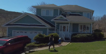

decorators3 Posted October 17 Share Posted October 17 Hi My clients wants me to create a new exterior look for her home with my rendering software. I have the floor plan but no elevations, I can't figure out how to get the garage at the correct height in relation to the google house image attached Any advise Thanks Link to comment Share on other sites More sharing options...
ericepv Posted October 17 Share Posted October 17 Use the dimension of one of the existing features (16' w garage door, 80" h, entry door, etc) as scale. Not a perfect solution but it will get you close. Link to comment Share on other sites More sharing options...
Rookie65 Posted October 17 Share Posted October 17 If you have the floor plan, then count the stair treads going down from the main floor to the garage floor, and add 1 riser. Pick a riser height that makes sense, then drop the garage floor from the main floor that amount. Then set your garage ceiling height from there. Or ask your clients if they can measure it for you. 1 Link to comment Share on other sites More sharing options...
decorators3 Posted October 17 Author Share Posted October 17 thanks for your replies.. will do as both suggested Link to comment Share on other sites More sharing options...
SHCanada2 Posted October 17 Share Posted October 17 the ridge of the garage is just above the bottom of the second storey window. Adjust the garage untilk that matches Link to comment Share on other sites More sharing options...
decorators3 Posted October 17 Author Share Posted October 17 got it Link to comment Share on other sites More sharing options...
