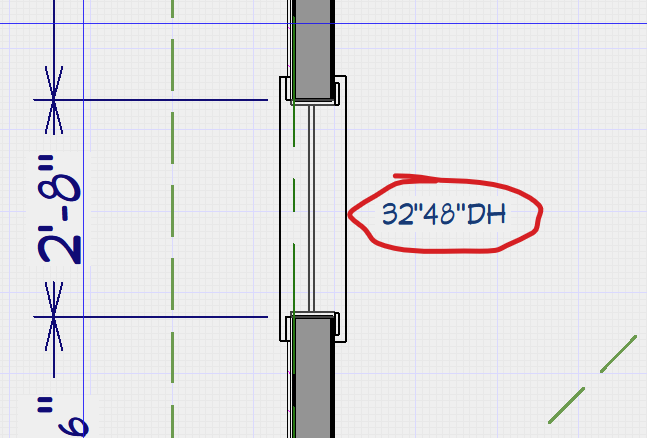

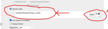

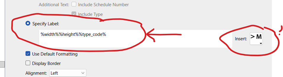

JKEdmo Posted Wednesday at 04:09 PM Share Posted Wednesday at 04:09 PM 4 minutes ago, myrtsbnye said: That's what I have to deal with! In my region (eastern Canada) most architects I have dealt with show a window that's 36"x56" as 3656DH. I've worked with a few manufactured housing companies and they show window sizes that way as well. So a 3656DH window is 36"x56" not 42"x66". It's rare for me to run into an architect or contractor who would show a 36"x56" window as a 3048DH. Does this work for you (x17)? I was able to get this result with the standard Object Specific Macros. It does include the inches mark, but I'd argue that makes it crystal clear with no room for interpretation. Jim Link to comment Share on other sites More sharing options...
myrtsbnye Posted Wednesday at 04:17 PM Author Share Posted Wednesday at 04:17 PM Thanks JKEdmo. I was able to do that with the macros but didn't want the inches mark included. But you do have a point that the inclusion of the inches mark would remove all confusion. I think this is the method I will use. Thanks again Link to comment Share on other sites More sharing options...
DBCooper Posted Wednesday at 05:40 PM Share Posted Wednesday at 05:40 PM You can get rid of the inches symbol by unchecking "use default formatting". But I agree with the others that think this might lead to more confusion. Link to comment Share on other sites More sharing options...
