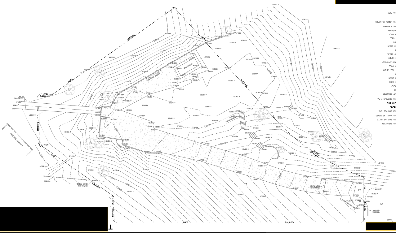

Bruno007 Posted September 25, 2025 Share Posted September 25, 2025 Hey Chiefers, I'm working on Chief X12 and it seems that the tools are buggy or outdated. I can't seem to get the terrain to work with my contours. Any tips that I'm not aware that could facilitate this terrain? Attached Link to comment Share on other sites More sharing options...
DBCooper Posted September 25, 2025 Share Posted September 25, 2025 Quote I'm working on Chief X12 and it seems that the tools are buggy or outdated. I hate to be captain obvious (not really, I love pointing out the obvious), but you are using a version that is 5 versions old. Of course it is outdated. The bad news is that I don't think the terrain has actually changed much since X12. I would start by trying to make "elevation splines" to match your existing contour lines. In theory, that should give you a pretty accurate model of it. If you are having problems with this, then you might want to post your plan or at least some pictures showing what the problems are. 1 Link to comment Share on other sites More sharing options...
Mark3D Posted September 25, 2025 Share Posted September 25, 2025 (edited) I would first try using only the major contour lines for elevation data as chief will get slowed down if you use all minor contours , then if needed you could add some minor contours for correct shaping. if you have the cad file you could import to chief I think x12 may have import ability the video is using x13 Also if you have built the terrain and are having trouble upload your file you will probably get a fix Edited September 25, 2025 by Mark3D 1 Link to comment Share on other sites More sharing options...
