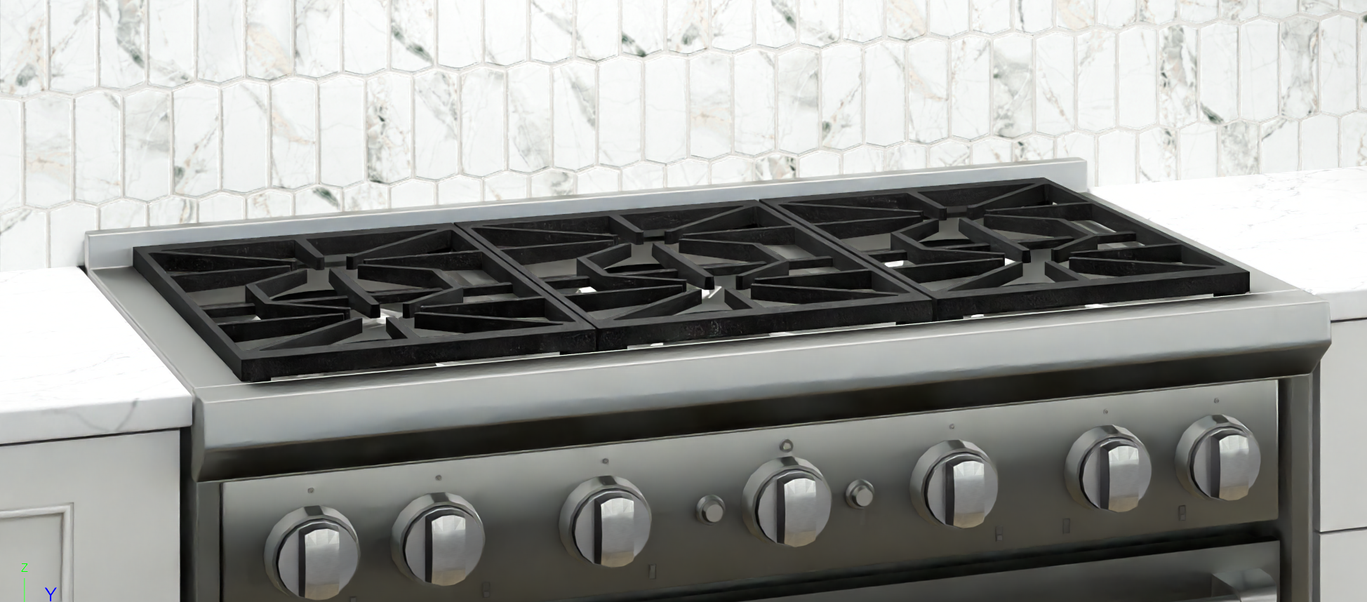

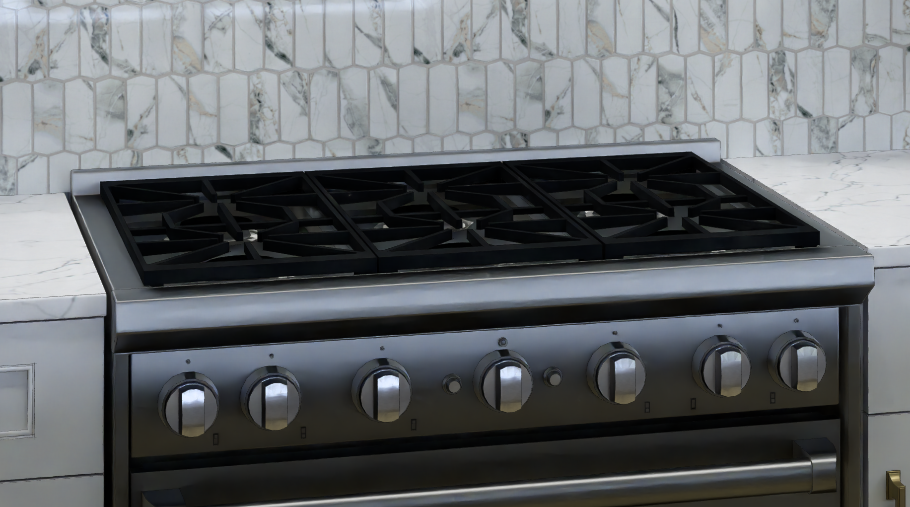

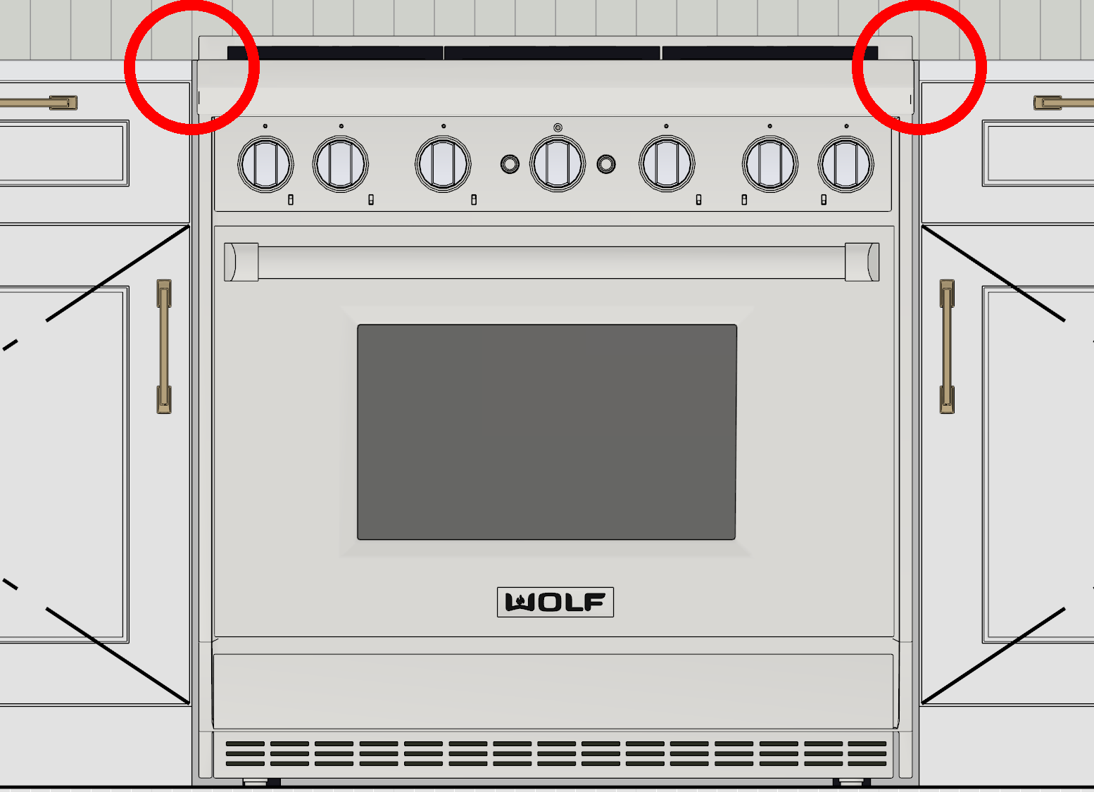

There has to be a way to generate a countertop overhang beside a freestanding range without building custom countertops, no? I've eliminated the extra spacing from the bounding box of the range and the countertop overhang is set to 1/16" less than the distance between cabinet and range...and yet Chief won't cooperate. Some of the kitchen gurus can probably clarify if attempting this through cabinet settings is a waste of time and if custom countertops are in fact the only way. Thanks to all who reply...I look forward to your input.

Fiddling around with it, I find Chief eliminates the cabinet countertop overhang when the distance is 3" or less from cab to appliance bounding box.
When you consider what they've done here, it's a convenience to the user, who doesn't have to adjust overhang for cabs next to ranges.
The 3-inch space at a cab's side also extends cab side overhang and adds an auto filler when cabs are placed 3" or less apart.  With a 3 1/8" space, there is no filler generated, and the c'tops don't join.
Looks like you can solve it with a custom.  If you want it done auto somehow, you should request a mod, but honestly, any auto fix would likely mean as many clicks or more than just doing the custom.

There's no fighting going on here. I Just wanted it to know if it could be done because I'd like to give a higher end rendering even during design development. And because the design is subject to change, I wanted to avoid custom countertops. @GeneDavis It's not more clicks to achieve that look when your cabinets are already made for this scenario.
But @DBCooper has provided a wonderful solution. Thank you! Thinking outside the...bounding box!
