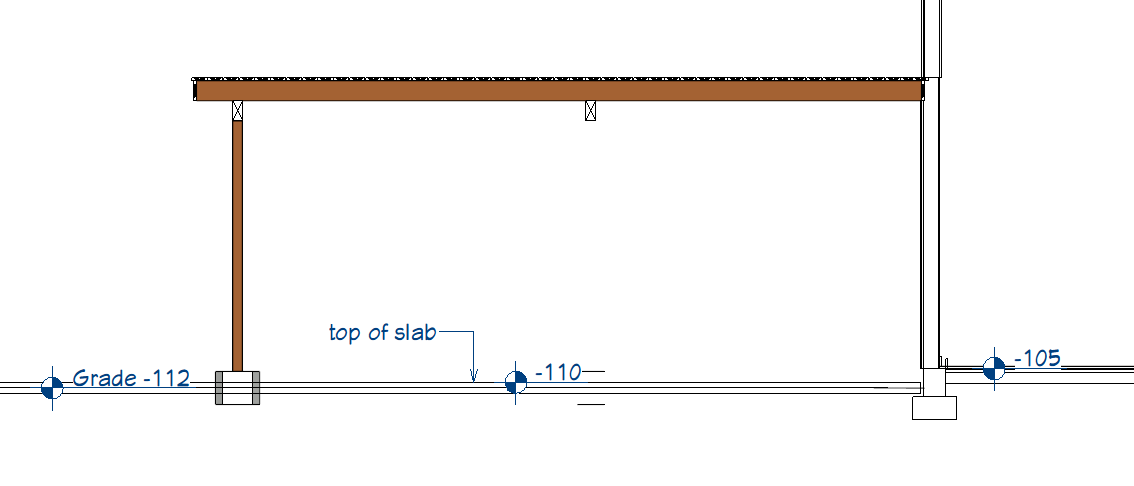

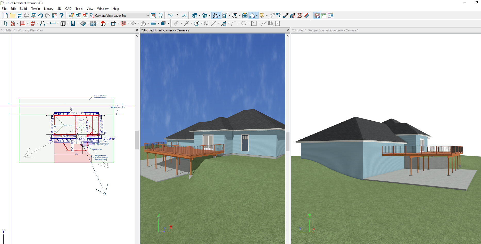

Garybills Posted September 14, 2025 Share Posted September 14, 2025 @K-LynnLike Mark said the Chief file is what is needed, not a dwg. I was able to copy over your dwg to maybe get close to what you have. See attached picture and notes that might help you get the terrain. Link to comment Share on other sites More sharing options...

Doug_N Posted September 25, 2025 Share Posted September 25, 2025 This is a view of the adjusted grade. Mark's comments are on point as well. Link to comment Share on other sites More sharing options...
