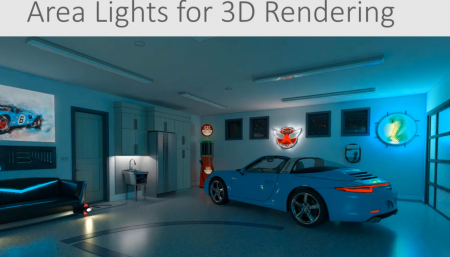

scottharris Posted September 13, 2025 Share Posted September 13, 2025 There are several videos on ray tracing if you search that term on the chief website. Here's a summary video to help https://www.chiefarchitect.com/videos/watch/10288/ray-trace-rendering-using-area-lights.html Link to comment Share on other sites More sharing options...
