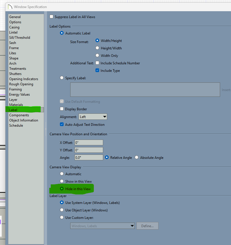

Solution robdyck Posted August 30, 2025 Solution Share Posted August 30, 2025 1 hour ago, mtldesigns said: Anyone have a trick up there sleeve? No trick...labels can be set to show or hide on a per camera basis. In a section or elevation view, just select the windows that you do NOT want to have their label showing. In the Label tab, check 'Hide in this View'. This assumes the labels layer is on. So you have an override to hide labels as needed. The inverse function does not work (that is 'show label' while the layer is off). Link to comment Share on other sites More sharing options...
mtldesigns Posted August 30, 2025 Author Share Posted August 30, 2025 Genius... thanks Robert. Link to comment Share on other sites More sharing options...

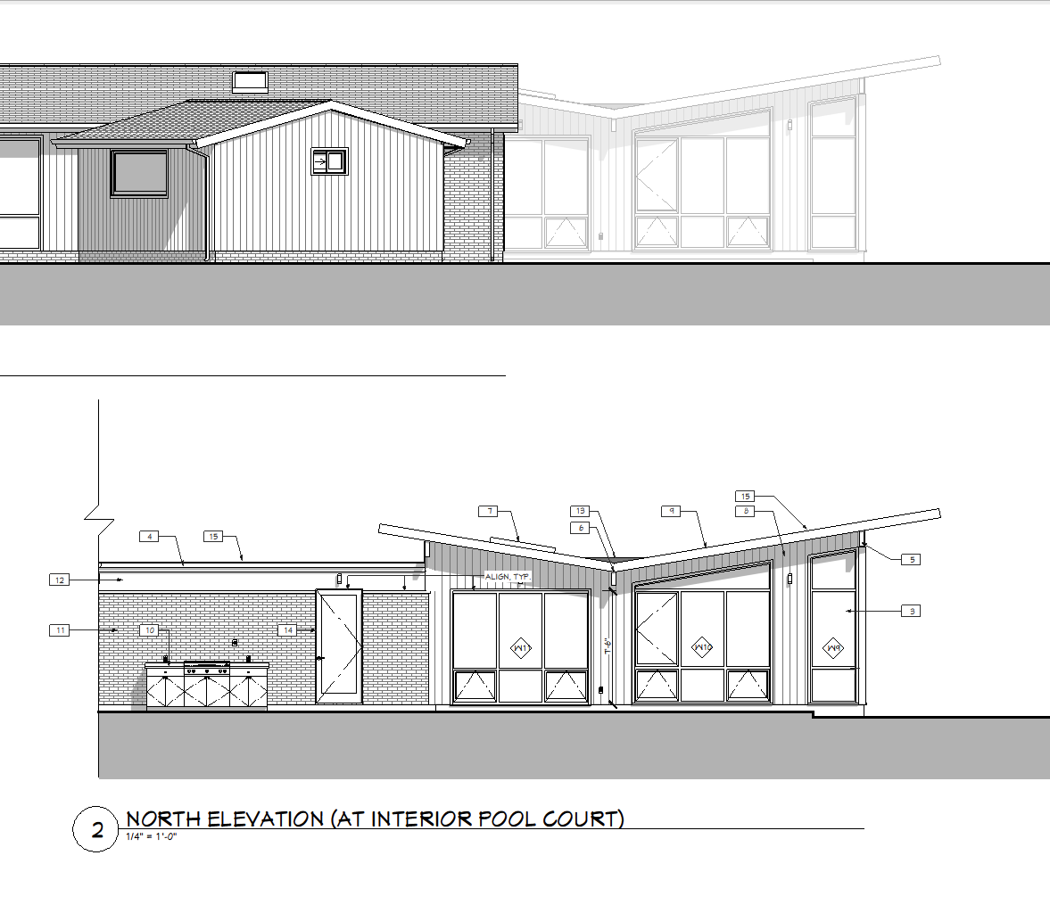

JKEdmo Posted August 30, 2025 Share Posted August 30, 2025 1 hour ago, mtldesigns said: When you did this, the views you did want them to show, were those labels out in space? Just to follow up, looks like label position can vary by view. I dragged the labels out of the way in the grey background elevation below. In the second view, they show up where they were automatically placed. But, Robert's solution is "cleaner." Link to comment Share on other sites More sharing options...
mtldesigns Posted August 30, 2025 Author Share Posted August 30, 2025 @JKEdmo Cool elevations. How did you get the back view lighter, is this tow different elevations on top of each other? Link to comment Share on other sites More sharing options...

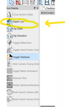

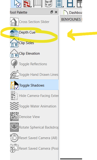

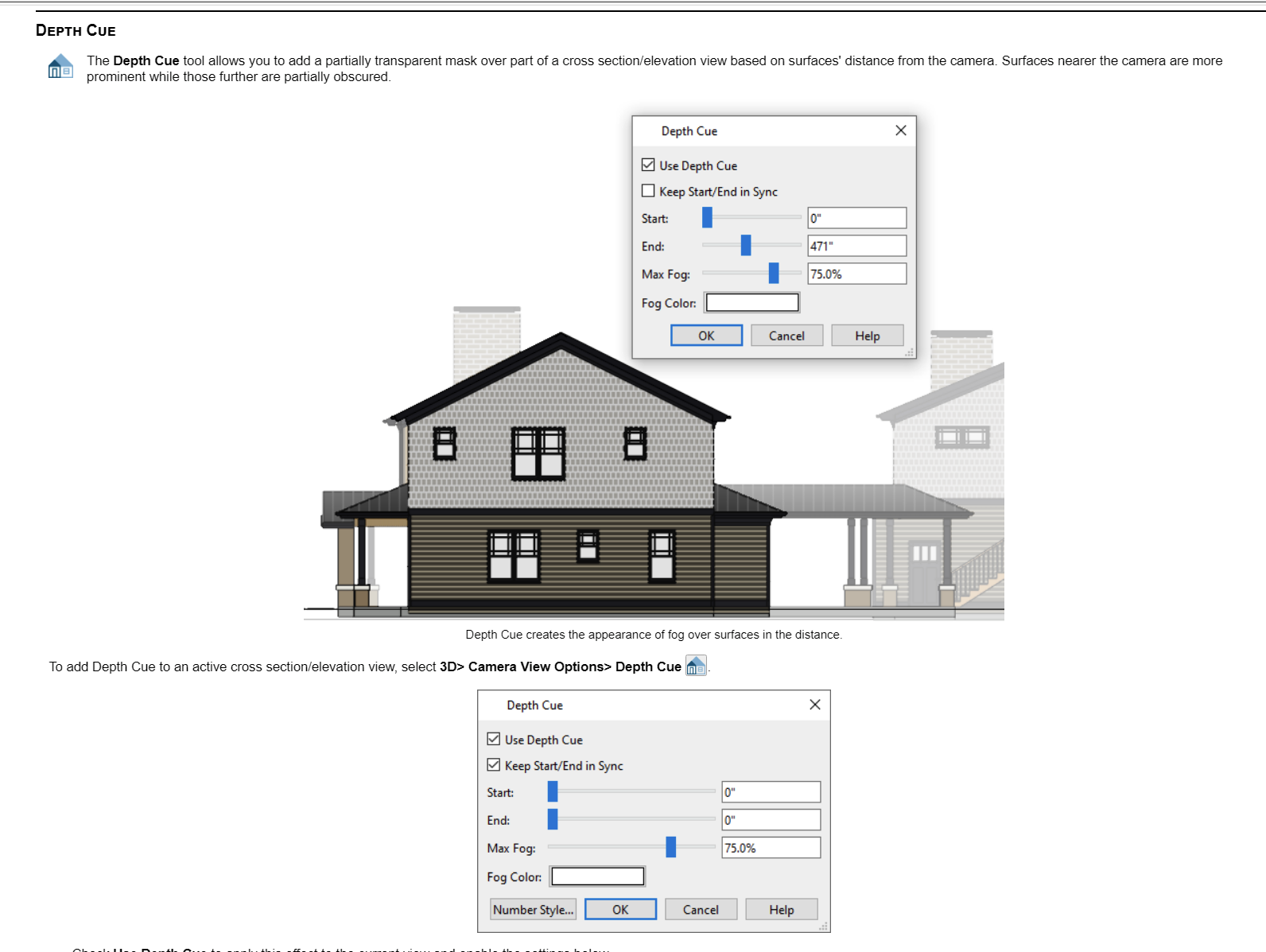

JKEdmo Posted August 30, 2025 Share Posted August 30, 2025 49 minutes ago, mtldesigns said: @JKEdmo Cool elevations. How did you get the back view lighter, is this tow different elevations on top of each other? Thanks. It's the Depth Cue tool. Works really well. You should check it out. Link to comment Share on other sites More sharing options...
mtldesigns Posted August 30, 2025 Author Share Posted August 30, 2025 30 minutes ago, JKEdmo said: You should check it out. I just did... this is crazy. I guess I got so used to using the same tools and not really ventured through all these extra tools. Has this always been here? I learned two things to today on the same post. LOL. Link to comment Share on other sites More sharing options...
